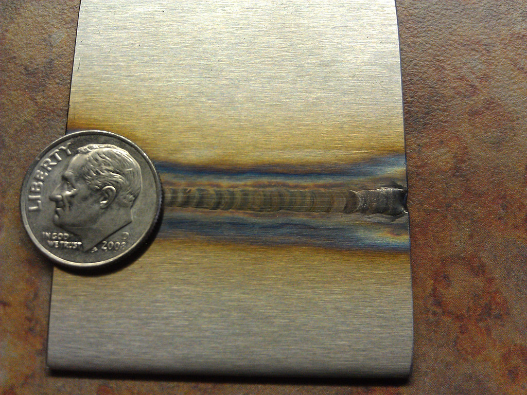

Okay - Now let's see your little stack of dimes!
OK, I can handle that request.

Here's the second practice session. Stainless w/o filler just practicing working the puddle with torch and pedal.
  #36
Old 07-09-2012, 06:30 AM
Looks good Scott!
When you get the hang of it - and you're on your way - you'll just LOVE TIG.
Whenever there's something to weld - I'll grab the TIG over the MIG any day.
Also for easy puddle work -- get yourself some silicon bronze rod.

Looks good Scott!
Sieg-Looks Great! Nice work.

TIG is very challenging in a good way. Beside requiring a lot of basic knowledge education it appears to require a LOT of seat time. My argon bottle isn't going to last too long.
Regarding helmets, my cheapie goes down to 9 but on it's scale something around 7-8 would be an improvement. I see an Optrel or comparable in the future.
I've also noticed you can't put too good a grind on the tungsten, it definitely impacts the arc shape and performance. Maybe I can get a package deal on a helmet and grinder.
