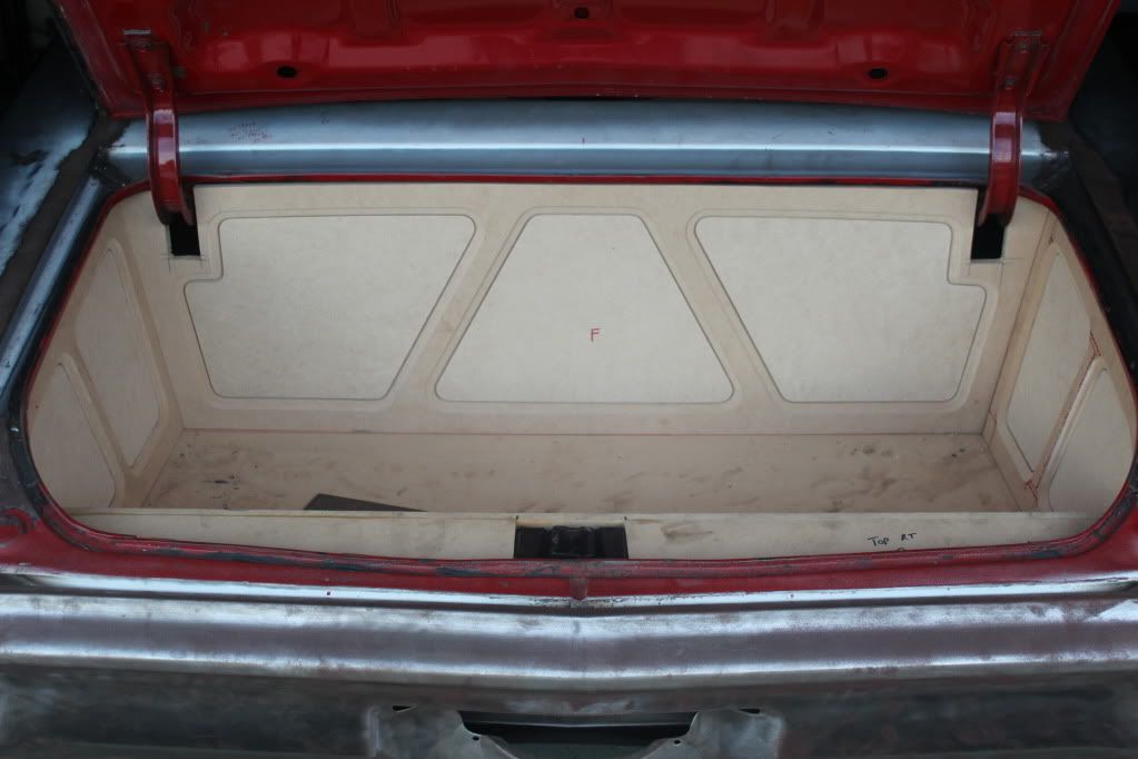

more updated pics. i would call the trunk just about done. i plan on making an aluminum "cover" for the trunk latch hole and i need to remount the new back piece. other than that, its ready for material.

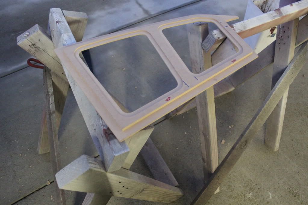

a few people have asked about the back cuts that i used to lighten the panels. if i wouldnt have put the detail in the panels, i could have gone with a thin piece and not needed a back cut. id also wait until done mounting before doing the cut if i did them again.

Looks great. What did you use to make the cuts? They look nice and clean.
to start, i made a template that i could trace the outside of. cut it out, sanded the edges and rounded the corners. i then used that to make an inside template (one with a hole the size of the shape i wanted). i could have used the first one, but if the router slipped a little my piece was done. with the inside template there was no way to cut too much.
i then used those templates to cut even more templates for the inside recessed pieces. because i used a bushing system on the router that provided a little offset, i ended up with lots of templates to make it all work.
