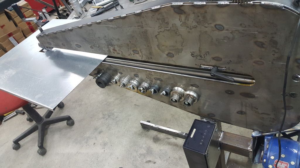

Yea I have run into that problem also. Sometimes I have to English Wheel out the middle flat area after I bead roll. It still has some warping to it. I have found that if you build a flat catch table front and rear of the bead roller it helps keep the metal flat as it's pinched between the die. Less up and down motion during rolling. Also as noted above, smaller bites.... I mean less pressure between passes. I do multiple passes to ease the metal into shape. However, it makes it hard to pass directly over the prior line. That's where the catch table comes in handy. Also try raising the bead roller up to eye level... which helps visibility during the multiple passes.
