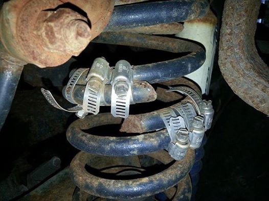

We should be there testing some new suspension mods on the truck

Well then.... those pics pretty much explain the automatic....
HAHAHAHAHAHAHAHAHA! OMG those are hysterical!
