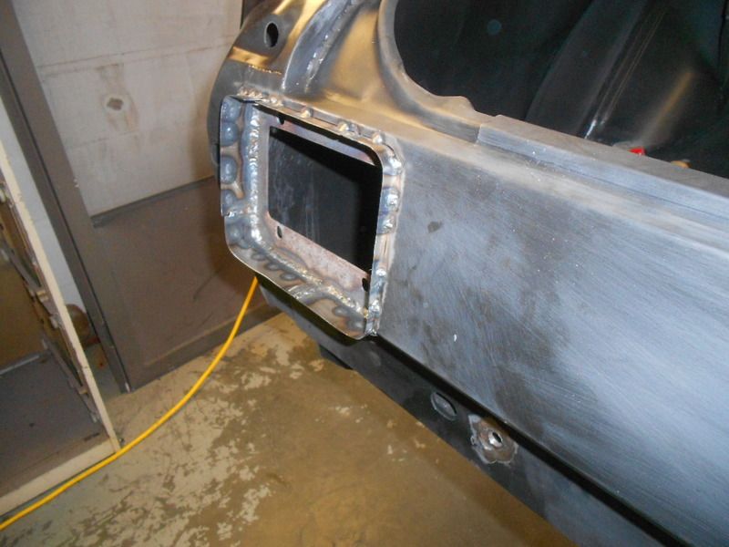

Back side welded
This is how Brian filled in the gaps
Next he trimmed it and welded it solid
Brian isn't finished yet but after grinding it will look like something like this.

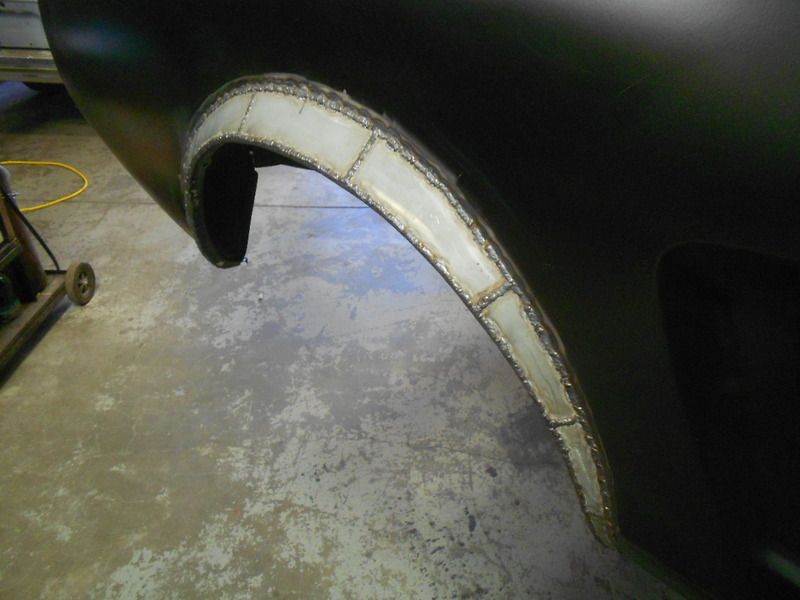

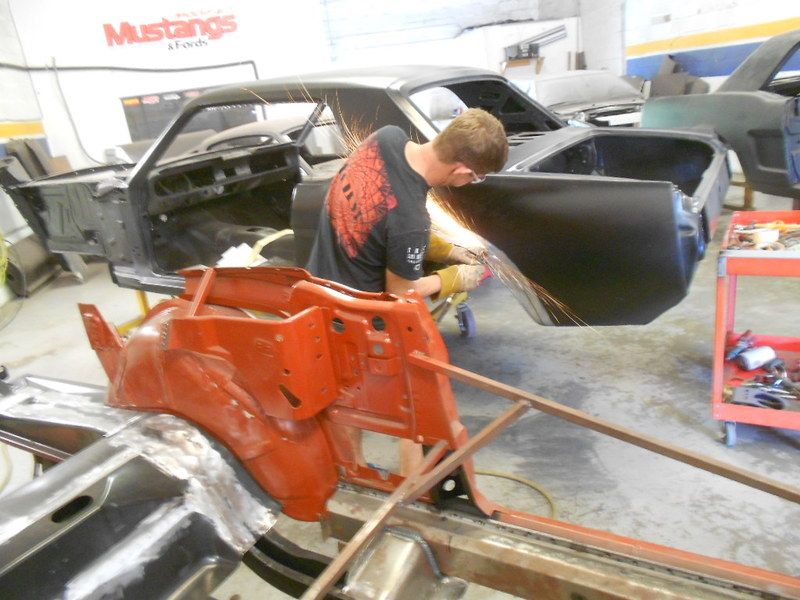

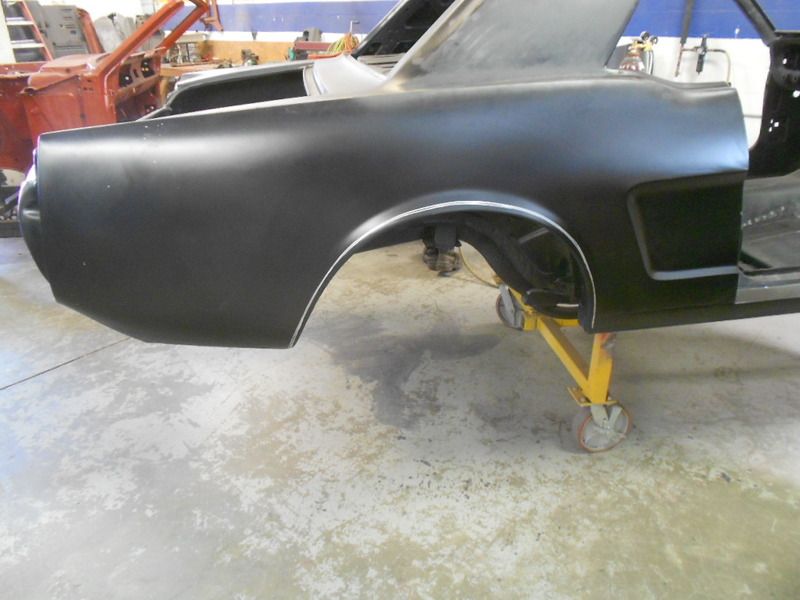

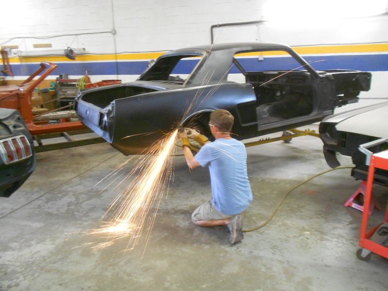

The flares are to small on the early Mustangs so Brian is going to make a little larger flare.
The first thing is to mark where he is going to make his cut and start cutting.
He left it attached at the bottom and brought it out 1 1/4" at the top.

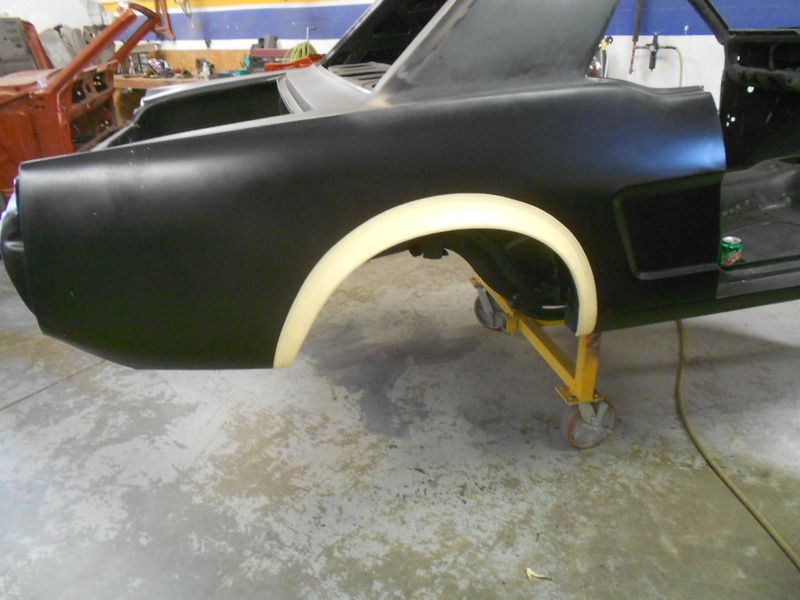

Next he made a pattern out of poster board and taped it on.
Next he transferred the pattern to metal and had to make it in sections to get the shape he wanted and started tacking in place
He will keep added sections until it is all filled in

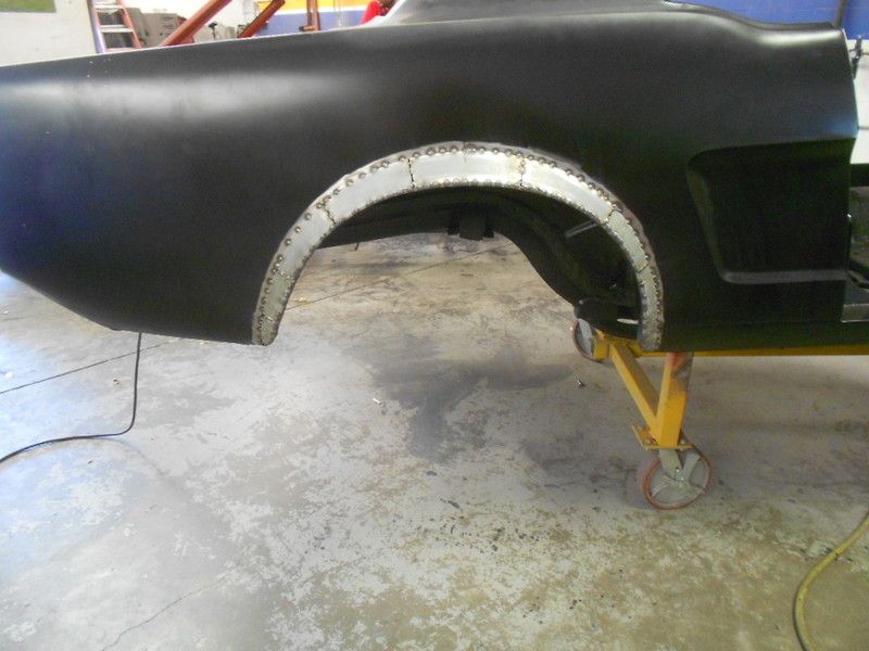

Brian is tack welding the last piece

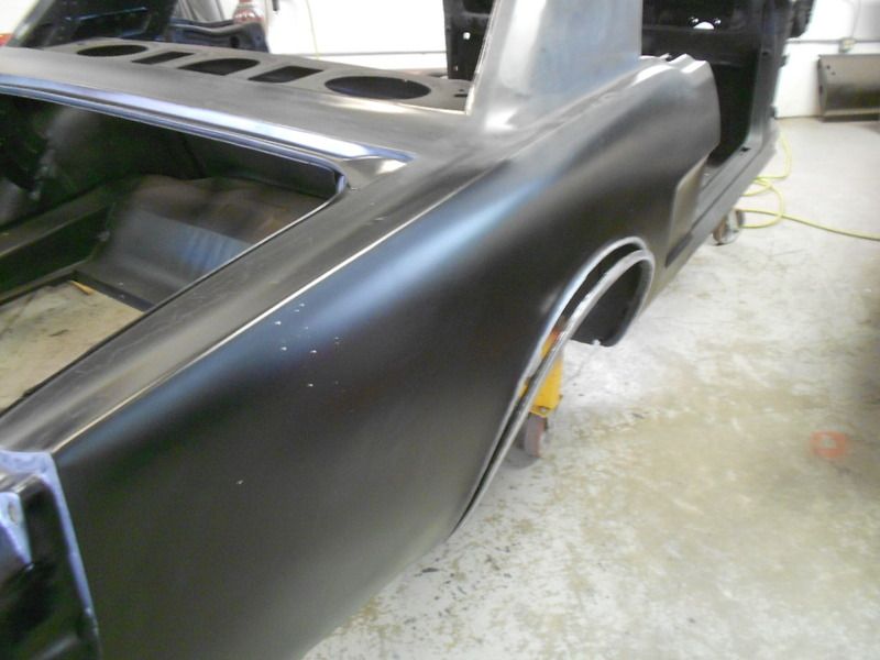

Brian finished the outside of the right quarter panel flare.

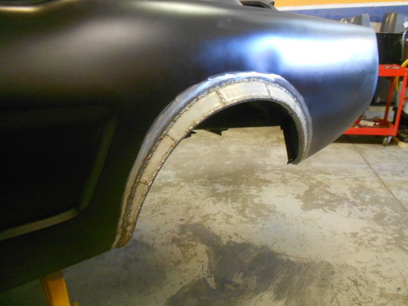

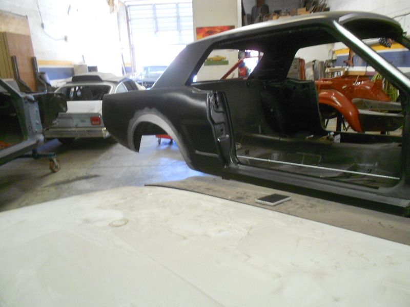

Round 2. The black line is where Brian will be cutting
Welds ground
