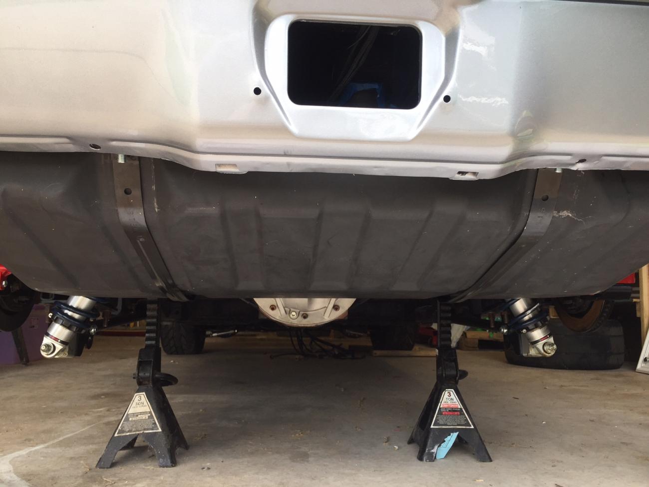

Originally Posted by will69camaro View Post
Wow definitely a wild couple years there. Glad you were able to keep the camaro dry! Good on you for putting it on the wooden cribs or you'd have had water inside and been re-doing some work!
Congrats on the healthy baby boy!
Onto car stuff, wheels being far forward, are your 4 link arms adjustable? Looks like you need to lengthen them to bring the wheels further back into the wheel wells. I had to center up my DSE stuff similarly.
Yes it has been a wild couple of years.
Thank you! He's our first
The lower 4 link bars are the fixed ones. Was thinking I need to get the adjustable one's

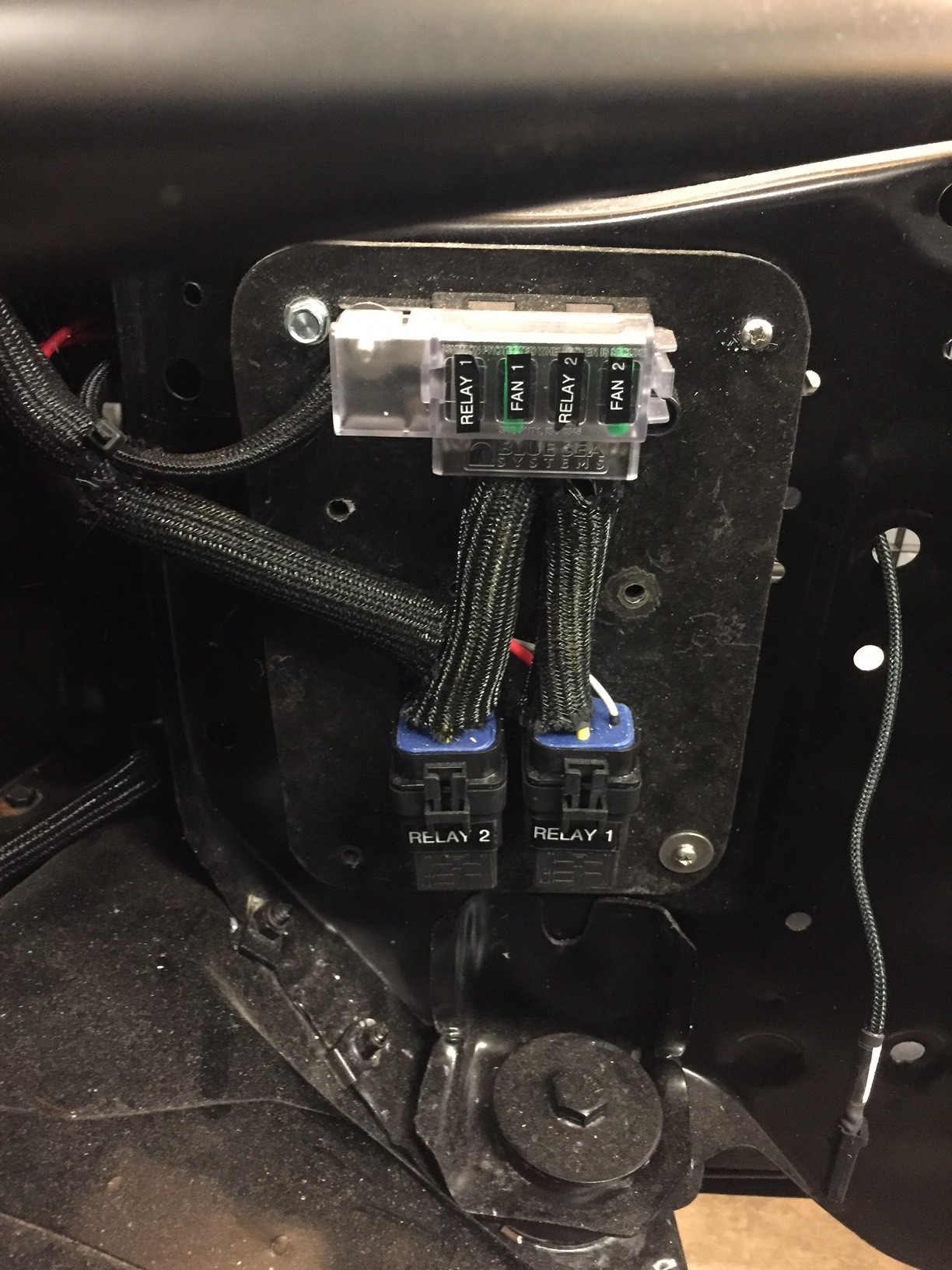

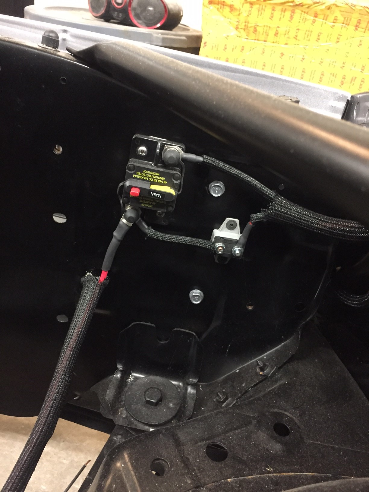

Gauges in, PSI harness integrated with chassis harness, Cooling fan relays, Main power breaker, Ricks resto mod tank - forgot the strap liners - will install, fuse block, VHX gauge controller and PCM in glove box. Detroit speed drive by wire pedal mount, 2 much tank vent

Great build and you are super neat with the wiring and labeling. What are you using for fan control?
Have a Griffin ExactFit rad combo with dual fans. It came with the relay kit. The fans will be controlled with the PCM with temps set for on/off
http://www.griffinrad.com/load_detai...key_id=6-00048
