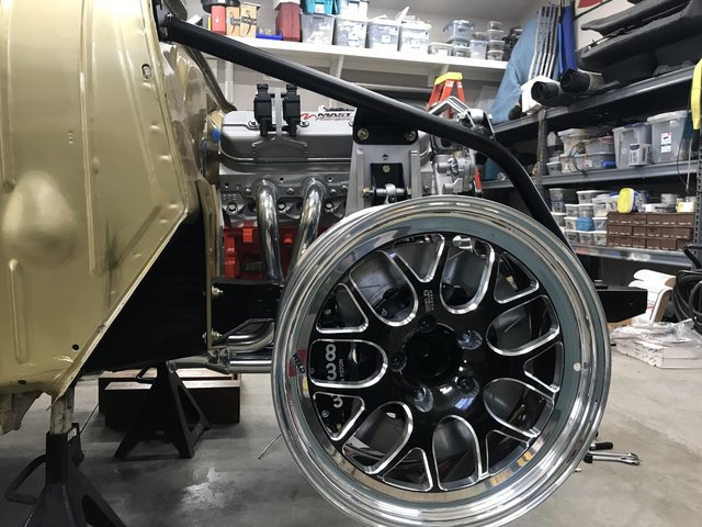

New wheels arrived after a long wait to be made. Had to throw them on to see how they looked. Weld RT-S S77 18 x 9.5 front and 18 x 10 rear. Thanks to Randy Johnson at D & Z Customs.
