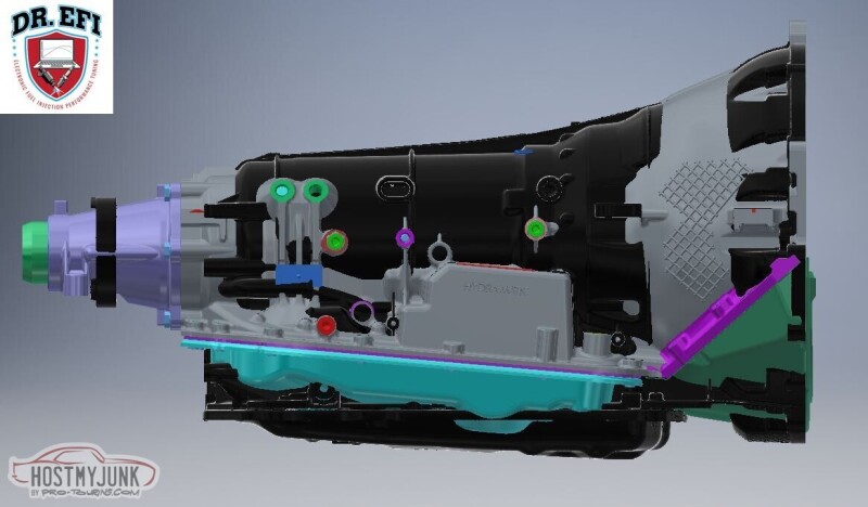

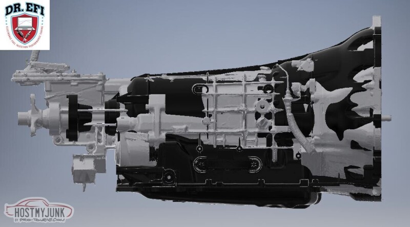

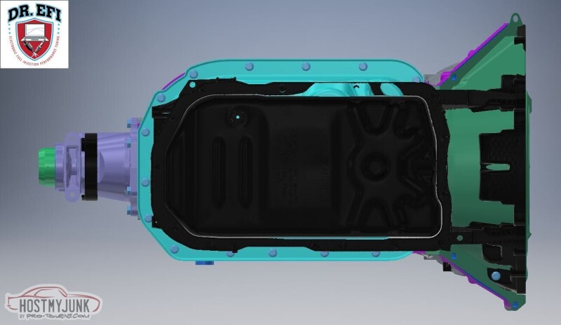

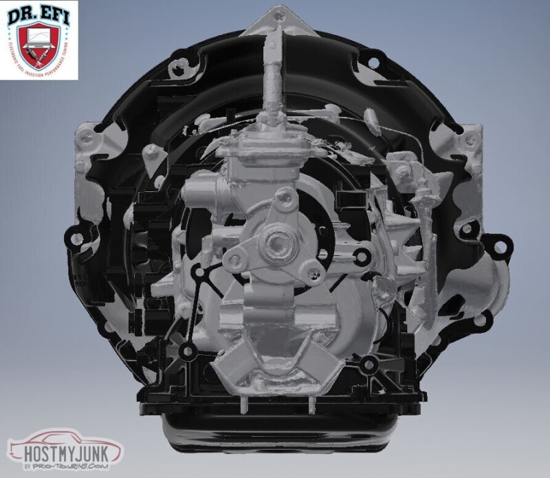

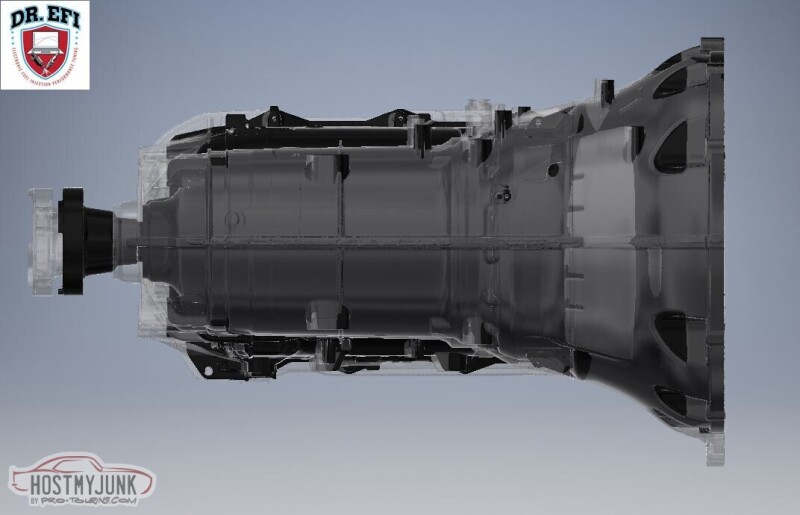

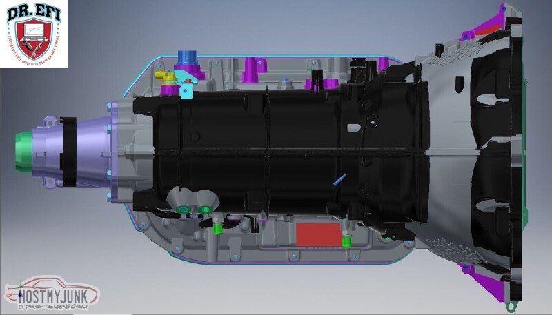

People have been asking for a comparison between the 8HP90 and the 8HP70. Here are some pictures that compare the two, as well as comparing the 8HP90 to a T56 and also a 4L80e.
First the 8HP90 against the 8HP70:
This is the 8HP90 against the 4L80e:
This is the 8HP90 against a T56
