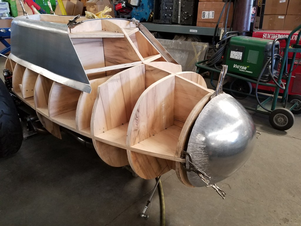

I'm interested to see how you bend the plexi around your jig/buck because being a compound to a flat, it's gonna be a bitch I think. I have all confidence you'll pull it off, would love to see a video if you make one. Oh, and thanks for the invite, but I'm about as far away as you can get!

The process is called vacuum forming. So, I will build it out of metal first. A fiberglass mold will be made off of the metal panels, Then a vacuum box is made to hold the mold. Then the glass is sucked down into the mold using vacuum and hot air to make it maluable. Here is another piece I had made in the same way.
