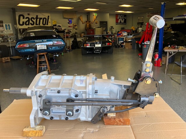

Jeff at Midwest did not get it on the website yet
So I have 755 hp and his m-23 is good for 800 hp
I might tweak things later so his m-24 is good for more
It is an ultra case. Sealed bearings both ends better cooling
Dipstick 2 drain plugs and better gear angles
It still has all the good stuff as the m-23 lightened main shaft
Upgraded shift shafts and synchros etc. I am also getting the polished
Gears with ratios of 2.20, 1.50, 1.17 and 1.1 a lot better for
my engine with a .750 roller cam. The Engine did not like the Tko
Gearing at all. Give him a call if you want all the details
I almost bought a reconditioned Jerico but decided not to go that route
That trans sounds great Bob. Nearly identical to my G Force / Tex T101A ratios. And that 2-3-4 is outstanding for road course duty.
Good luck with it.

The new N-24 trans showed up today
Time to get it installed

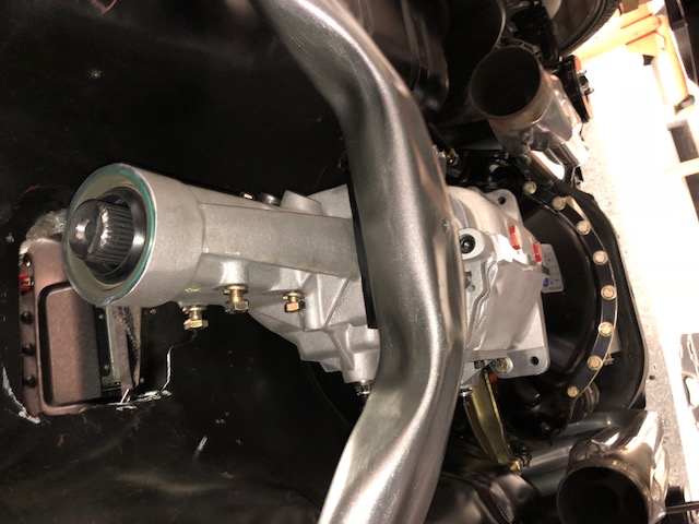

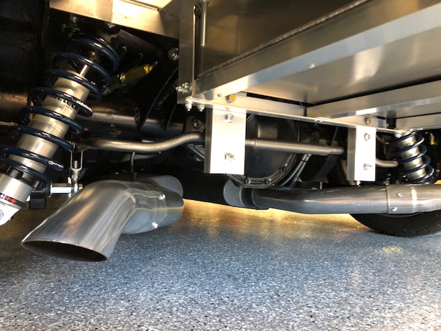

Transmission is installed.. made the rear 4 link
uppers easier to adjust so I can get the pinion angle
right
Bob

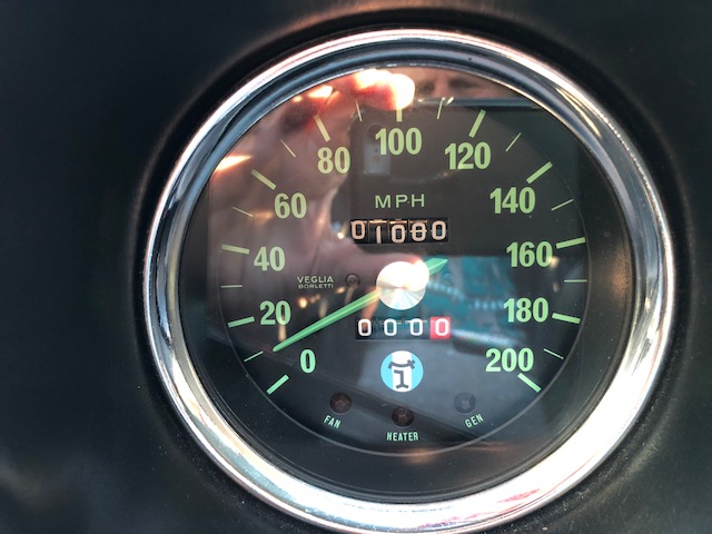

Been driving the Pantera a lot lately
and it finally just turned over 100,000 miles
Not bad for an old car with a lot of new parts
Missed the Zero setting but caught it at 1,000 miles
Bob

So I finished up the trans install, tweaked the pinion
angle and the rear end still makes a bunch of gear noise
I think I damaged it with the bad angles before so off
to the rearend shop to see what is going on
