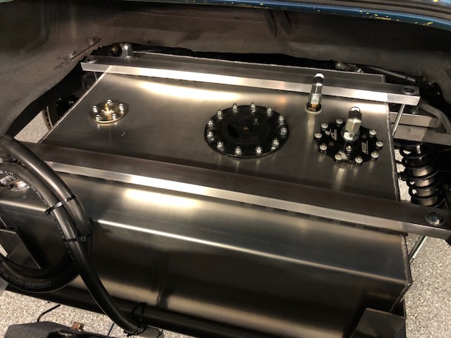

I finally have been spending some time on the firebird lately
Ridetech rear suspension is complete and I braced things
up. Finally installed the fuel cell, almost done with the
plumbing.. just a little wiring to do and hope to get it
back on the road again and off the Jackstand Racing Team

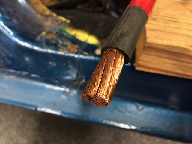

Finished up my wiring... had to shorten the battery cables
They are 30 year old real braided copper double ott.. not sure
you can but this good stuff any more

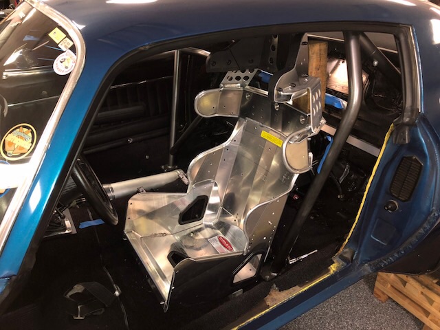

Installing my new birthday present
I lowered the seating position along with
moving it back for better leg position
