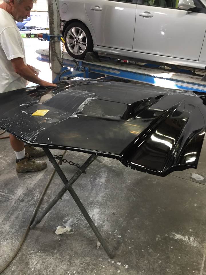

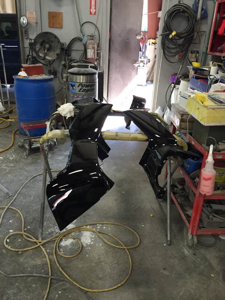

Thanks guys... cutting the hood and nose pieces.

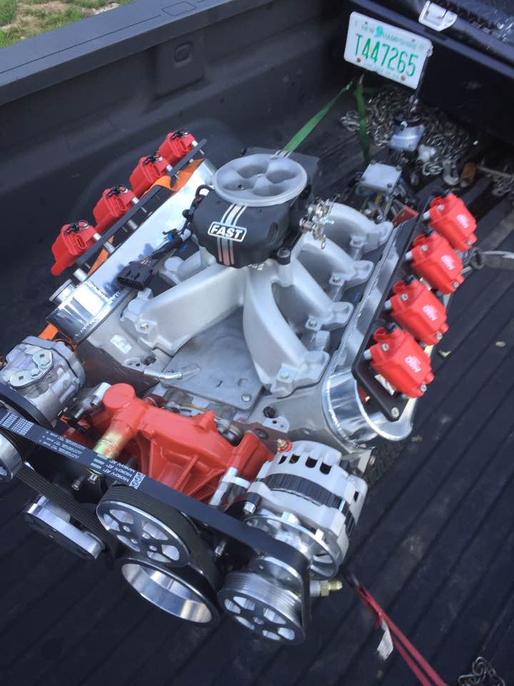

Finally getting the engine and trans together this week, to stab it in for the first/last time, I hope.

BTW, we wet sand from 400 grit all the way to brown paper bag, in between every coat of paint or clear. Then buff the living heck out of it.
5 coats of color, 5 coats of clear. Paper thin paint. Black in depth, is not easy.

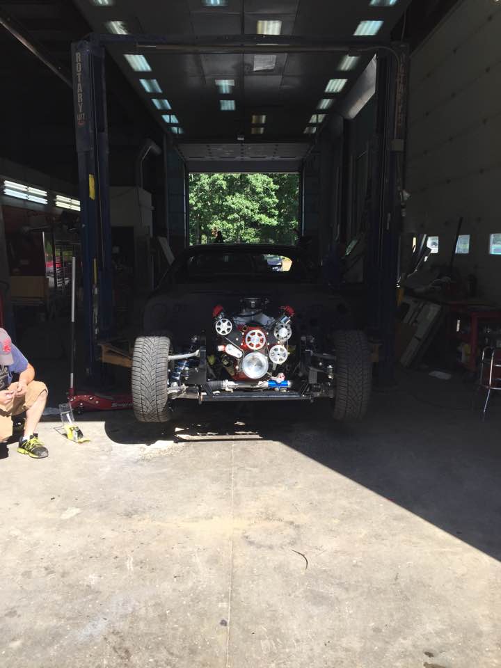

Set for tomorrow.

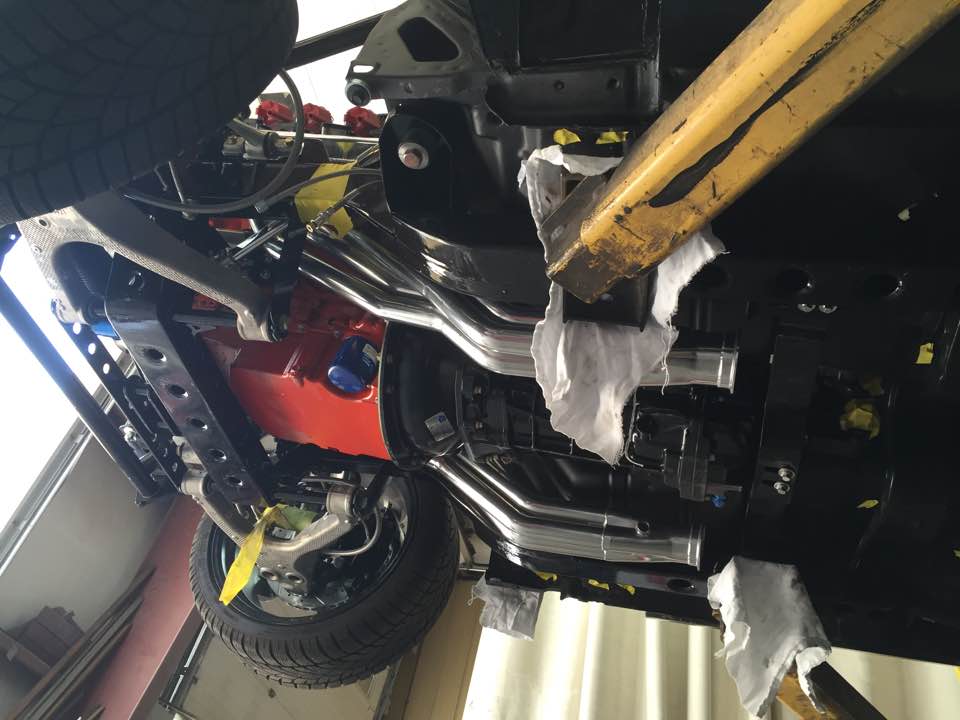

So, a bit of thrashing from 8am to 1pm today.
Motor and trans is in. Have to cut the shifter opening back 2.5".
Got the gas tank in, headers on, started lining stuff up.

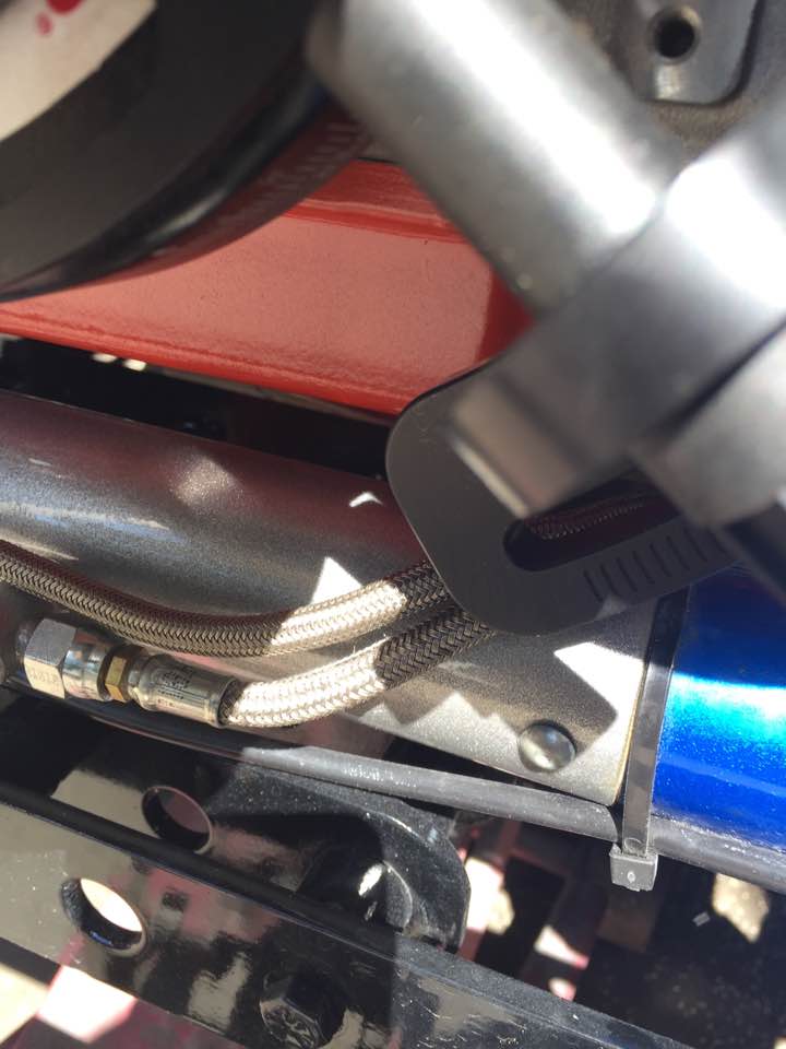

Thinking I need an electric brake booster... can't find the hydro one I had and not a fan of more hydraulic hoses.
Would have had the full coated exhaust on, but the rear sway bar needs a narrower torsion rod.
