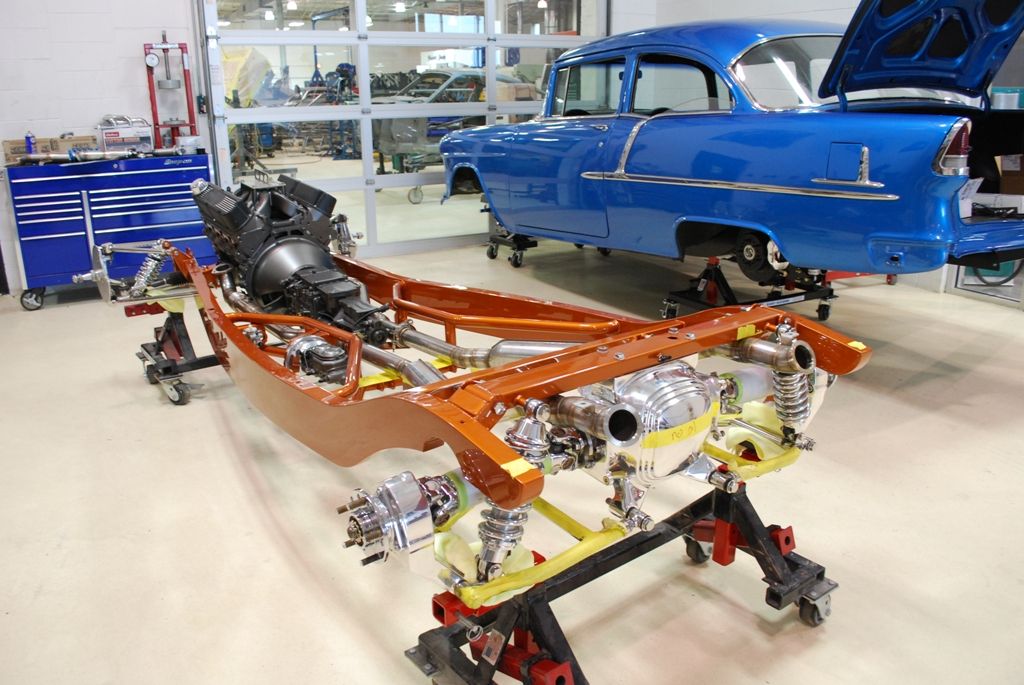

great work as always,awesome 55 chevy
The 55 is just a chassis install withj our new REVO IFS and some metal work. It is in the assembly stages now. I'll gather up some pictures and post them up next week.

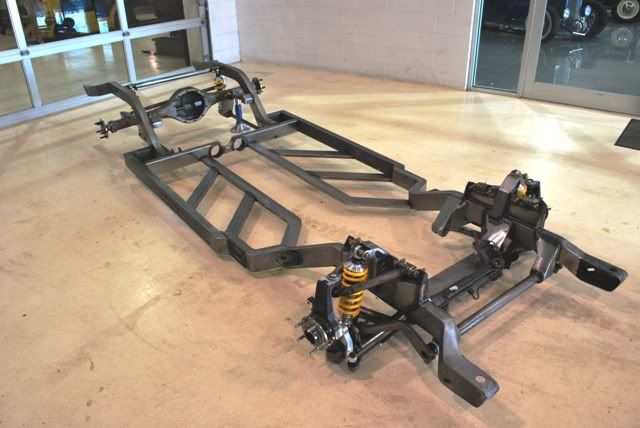

I have a question... and please excuse me if it sounds dumb. Would it make sense to make the frame run all the way out to the rocker panels, and then weld the assembly together instead of a more narrow frame like in this picture?
Thanks!
Bill

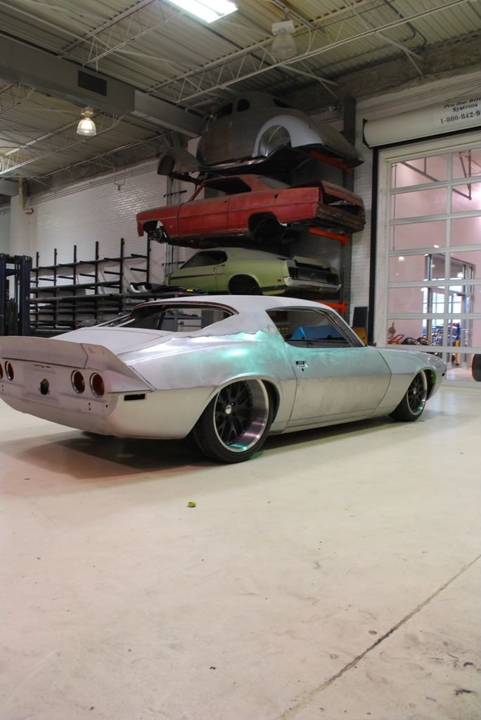

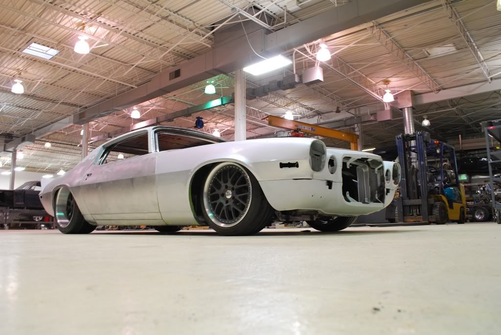

Bill, our 2nd Gen chassis is normally built that way. This customer wanted to try to retain as much of the original floor as possible and wasn't interested in a low stance. So we did a chassis for this car that basically ran back as an extension of the sub-frame. It will still be much stronger than a subframe and connectors, and more than enough for the intentions of this car.
Here is a pic of our standard 2nd gen chassis
And the standard stance
