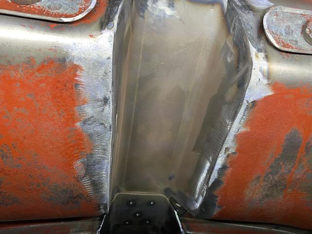

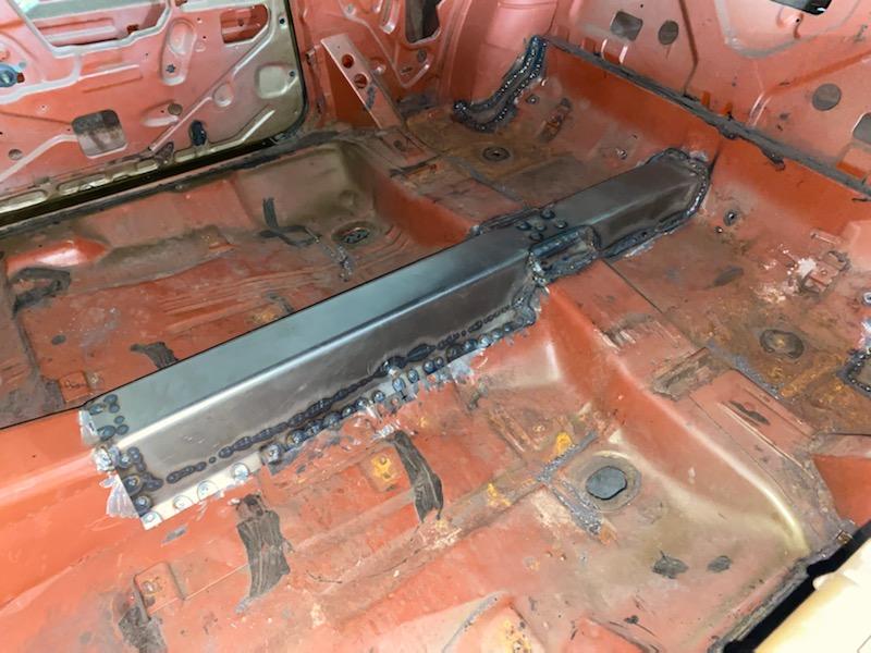

Sold our house in California and bought a house in Medford OR to be by family. Dropped the car off Dave May of Genesis Fab in Galt Ca. to raise the driveshaft tunnel before the painter gets the car. Did a great job, super reasonable, and whipped it out on a day!
