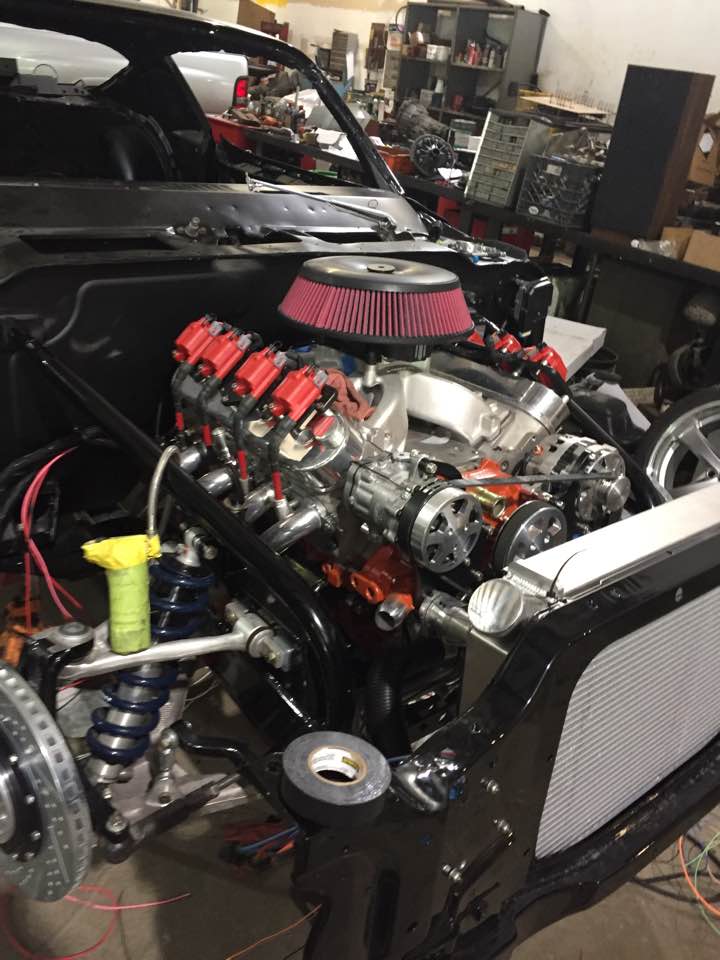

Looking at your pictures and looking at mine and my Subframe it looks like I will have to modify it similar to what you have done.

I think you do, too.
Not hard to figure out, with a measuring tape.

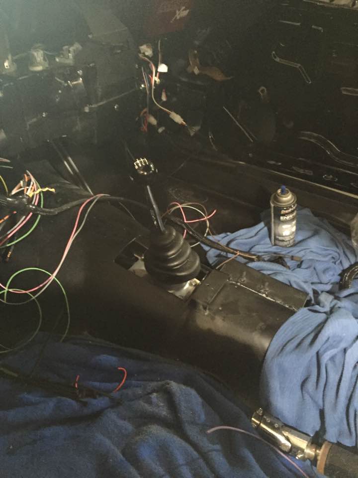

and today's pics. More cutting... took 2.5" out of the tunnel to get the shifter in. I'll need a different console. I plan to build one that looks seamless to the dash. Like my black GMC C15... what's another 40 hours? :/

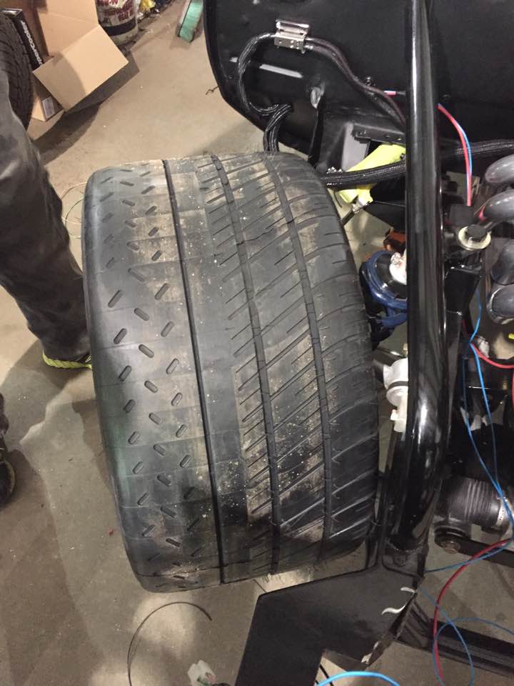

So, tires size is set.
Front and rear...

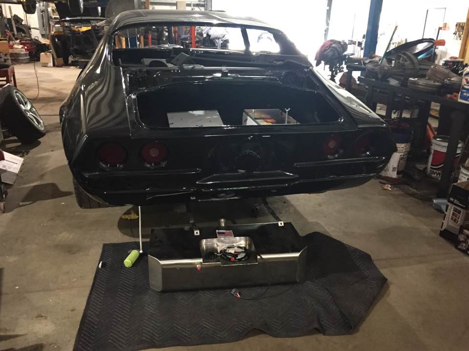

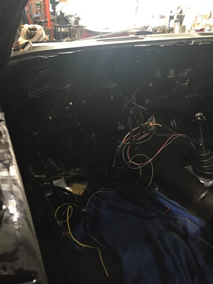

Still motoring away on this. Have all the AC plumbing and fuel to go.
Wiring is almost done.
