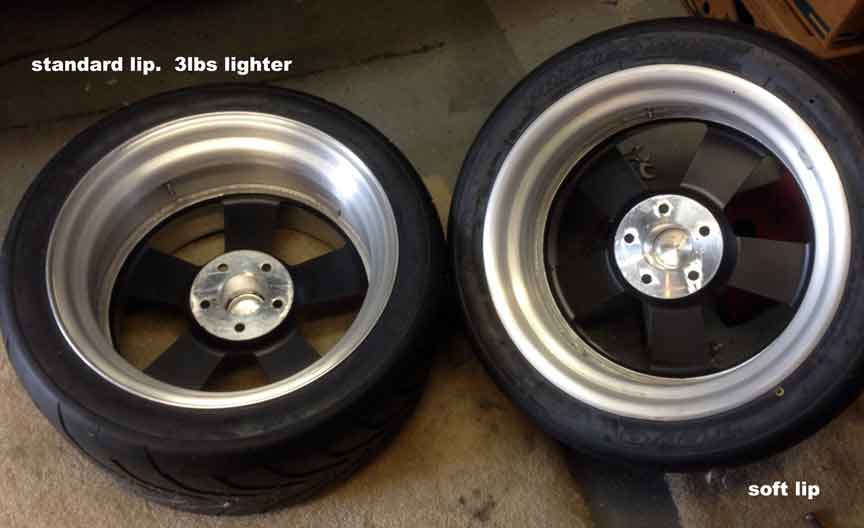

Well one issue you won't have with the cast versions is what I discovered last weekend- that the inner halves of my rims don't match! whoever built them mixed and matched both soft lip and traditional lip on the inner rears. So back they went. It was a 3 lb weight difference, too. grrr.

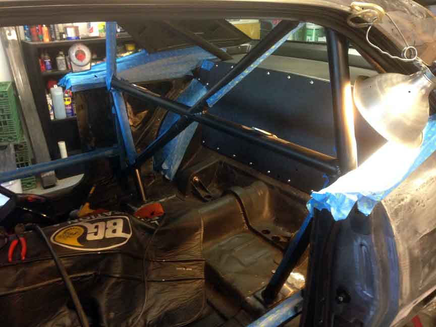

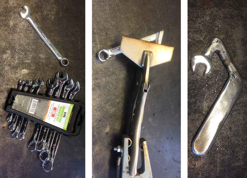

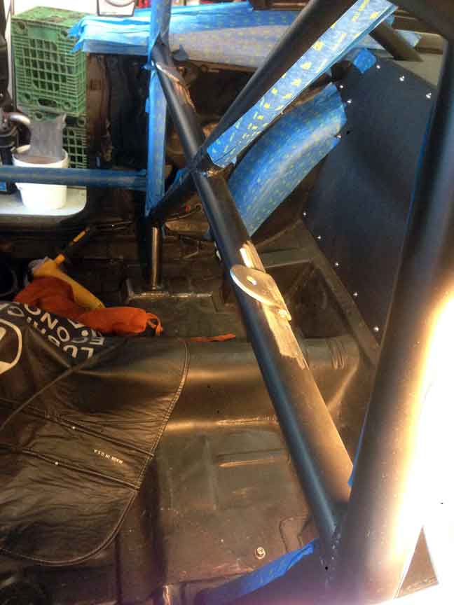

Also welded in tabs for the seatbelts, installed them and the seats, too. I had to lower the driver side a bit as it was too tall and I was hitting my head on the roof just sitting in the car. Sometime later I'll do this for the passenger side. Maybe when I take the seats back out to add the 5th belt slot in the seat. I won't need this until a track day, which will still be a while from now. With the lowered seat brackets I needed to make a special wrench to access the bolts. I may think about a better way to mount these as this is a PITA as it is.

That's quite the wrench right there! I have a 9/16" wrench I ground down to install a starter in my 69 Z/28 in 1972 and it saved me many other times as well. As long as they work! That's something about the rim barrels. We're they both the correct back space? I hope you get them back quick.
Yeah, I'd like to redesign the seat rails so I wouldn't need such a funky wrench, and get the seats even lower. I'm thinking of cutting down the seat frames in the car itself, too.
RE: wheels- Yes, the dimensions were good (or at least I didn't notice any weird unequal fitment issues), but whoever built them just didn't match them up. And it was a 3lb weight difference, too. It is supposed to be ready this Thursday which means I could pick it up Friday after work.

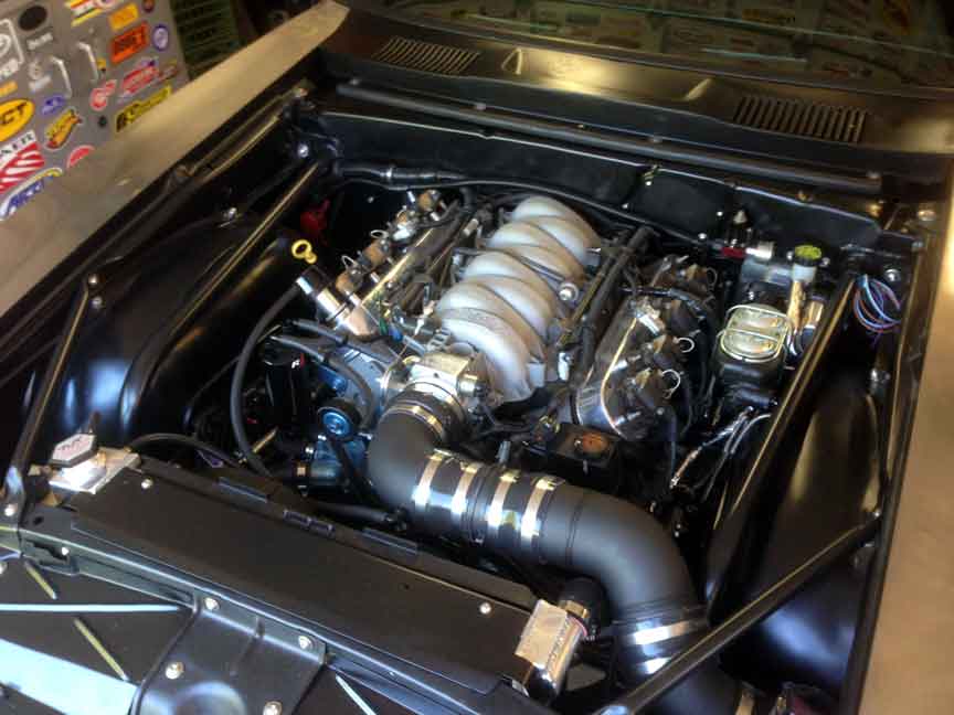

small updates... received my driveshaft which is quite pretty, imo, and a shame that it's buried underneath the car. I also hooked the battery up this weekend and started testing the wiring. I had a few bugs (to be expected) and got most of them fixed. The real bummer is the car wouldn't start. After getting a little help it turns out I plumbed the fuel lines/ regulator all wrong (resulting in way too much fuel pressure) and need to add a return line after all. So parts are ordered and I'll be doing some revisions over the next couple of weeks. Live n learn. Stay tuned.

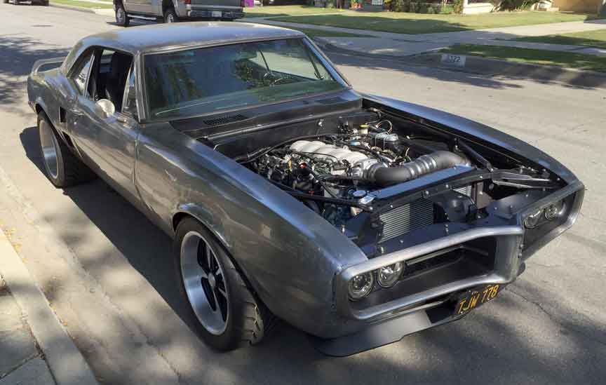

After plumbing in a return line to get the fuel pressure right, and discovering that I had the 12v switched power line hooked up to a terminal that didn't have power when the key was in "start" it now runs. I even drove it, too. Next is to get an alignment and I ordered some new mufflers that are quieter as I want my wife to ride in this, ha ha

Nicely done!
