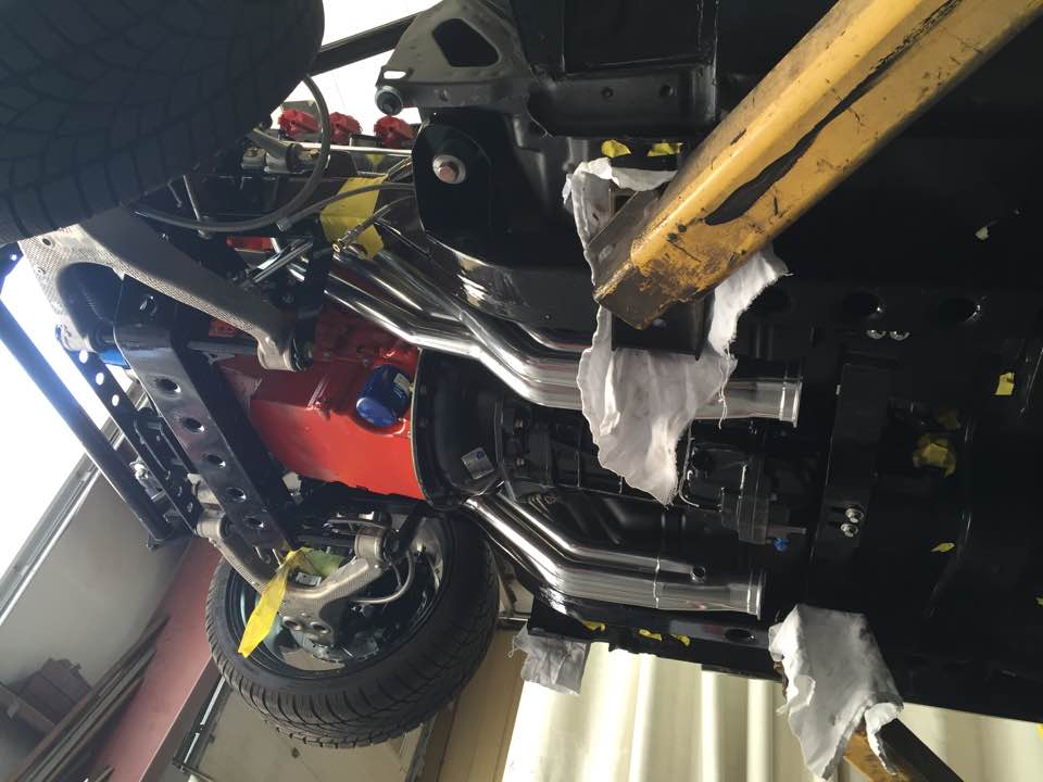

It doesn't go through my headers. I am using Stainless Works "Wayne Due" headers, if we left the stock Camaro column orientation, it would hit the last tube. We were able to angle it down and away by moving the bottom lower point.
It's the lower mount that controls the angle through the front sub frame. I am using a stock upper mount, with clamps welded to it, that bolts into the stock location on the dash support. For some reason, my "bolt in" Flaming River steering column didn't have a provision for the mount. You could probably shorten up the top mount and increase the angle, but I wanted to have a lower steering wheel.
Normally, they mount high through the lower mount. As you can see, I had to lower it about 2.75" and build a new mount that uses a Flaming River orbital that will take a whole lot more angle. It really wasn't that hard, just a bit of time and 3/16" aluminum that I had on hand.
I added a few pics that shows the orientation.

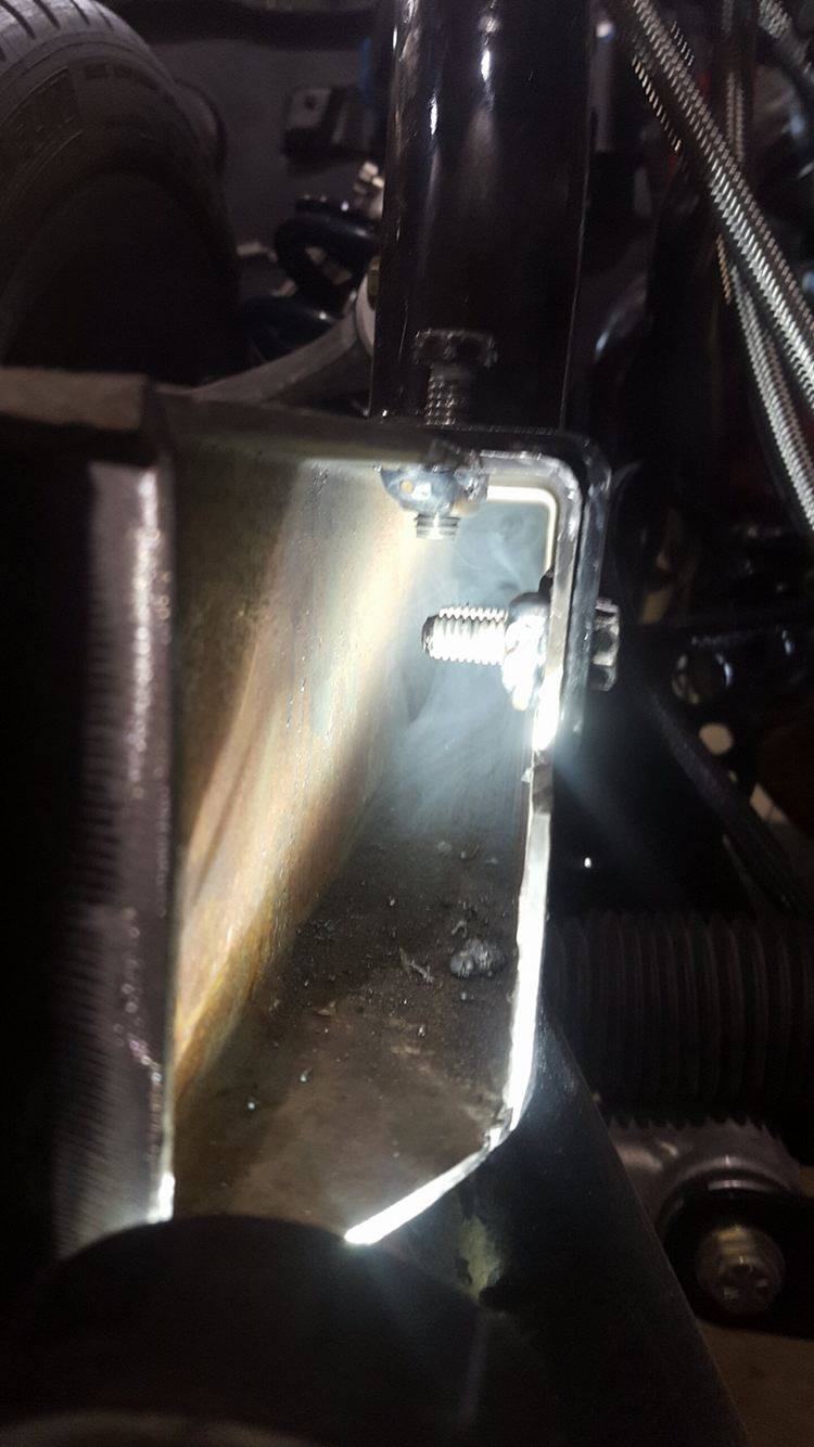

This is the lower column mount I put on a piece of aluminum.
https://www.summitracing.com/parts/f...0101/overview/
It allows more angle than the stock, or aftermarket replacements that used stock geometry.
The attached pic is the one I bought, that is all stock location. My finger is where it actually needed to go through. So I used the black one as a template.
It came in clear aluminum, I had it it anodized, only to find that I had to re-do it.

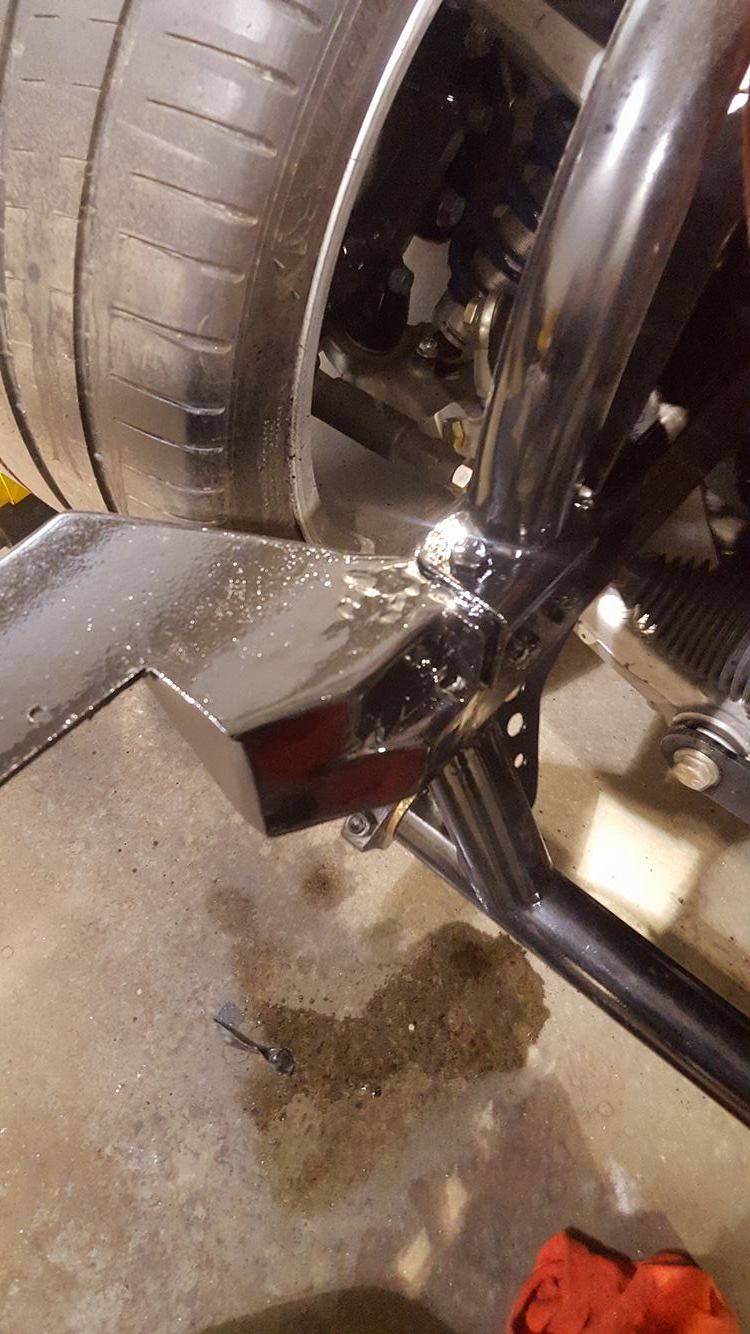

All welded up, flapped and painted.

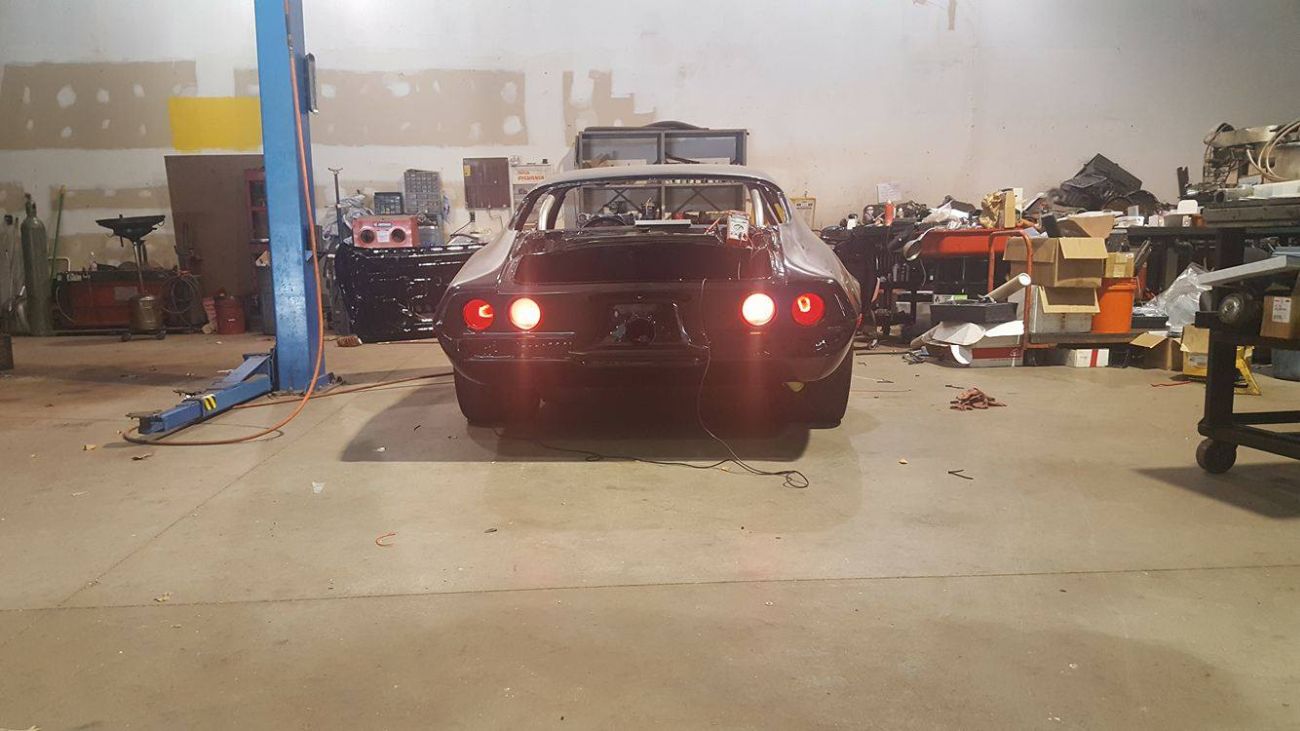

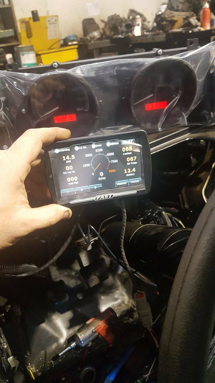

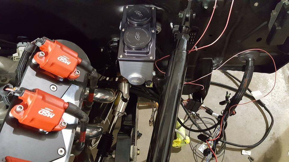

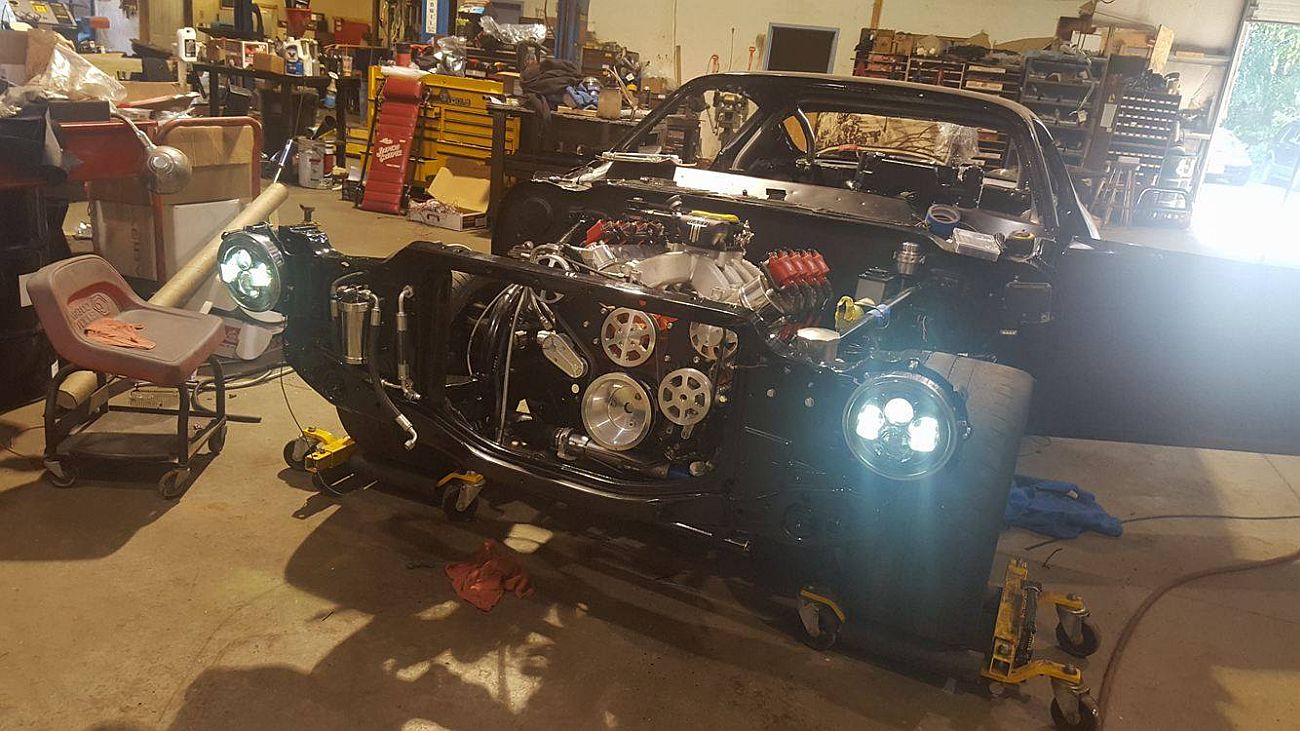

Mostly done with wiring and plumbing.
Time to bring it home.
Now for final body work, fitting the nose, the deck lid, etc.
Then interior.
