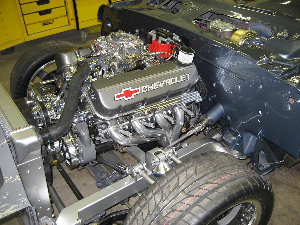

engine runs & sounds good . its ready to cruise around the parking lot, that usually motivates me a little. next ill get the popers in and then the front can go on. bill

Bill,
Interesting placement on the MC and booster. Do you plan on running wipers? I'd be interested to know how you engineered that...very cool...

Originally Posted by redfire69 View Post
Bill,
Ron
ron yes im running wipers.(the its a snap kit. ) the brake set up is from eci its designed for a 55 chevey i think. i took the car a spin today and the brakes worked excellent. however i had to cut out the majortiy of the fresh air plenium to make room room for the unit.
Bill do you have some type of cover for the top of the brake setup or underneath to keep water and exhaust fumes out of the interior? I really dig the setup!

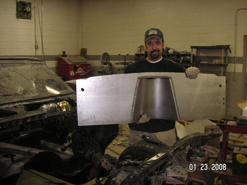

Bill, Where did you get the roll bar?
we made the roll bar. we started w a piece of 1 1/2 exhaust pipe to get the shape, then made an 18ga cover that was made up of 6 different pieces. bill ps i thought i had some pics but i cuoldnt find them,if i come across them ill post em

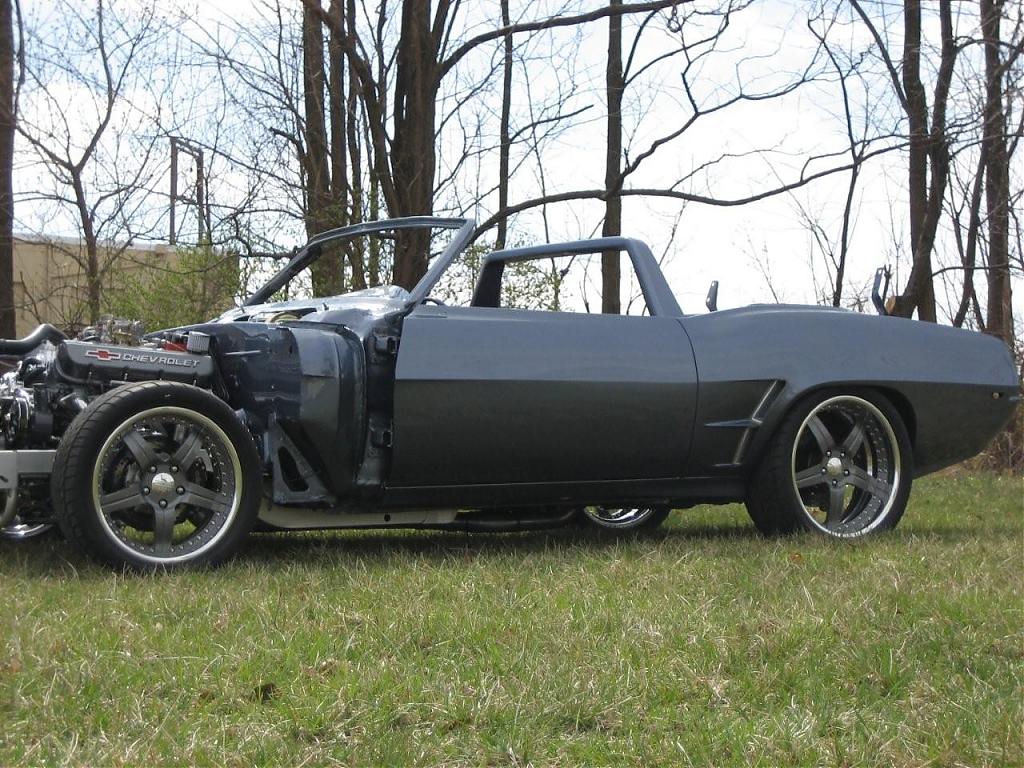

Posts: 229

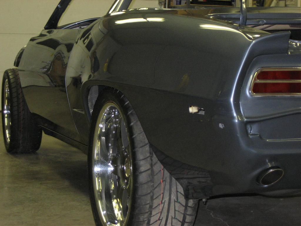

Thumbs up
i pulled the old girl out side for a couple of pics, and a little abuse. excuse the sorry burnout photo ,i smoked the whole parking lot out but my friend on the camera only snapped one shot,and it was way early.(pre mature lens retraction) lol bill
