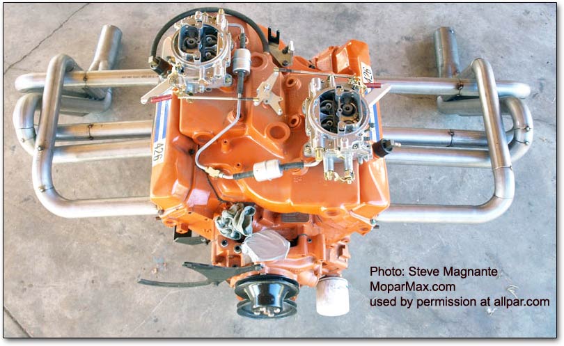

The Max Wedge engines (1962,63,and 64) Stages 1, Stage 2 and Stage 3 versions had the taller port openings than the standard wedge ports. Along with the taller ports they included a slightly larger valve dia. to take full advantage of the Cross Rams effective upper RPM band. The manifolds shown above are called Long Rams- not Cross Rams. You could use the Long Ram style on your standard Wedge Engine cylinder head- example- #-906 heads, 452 heads, even the Edelbrock Aluminum Wedge cylinder heads,ect.
The Long Ram engine package was more of a low rpm version, or for better description- street version.
I too have a set of these Long Rams and have toyed with making a simillar style set up to utilize 2 turbos and injection.
I hope this clears things up.

Your right,it was this cross ram i was thinking of.Ron

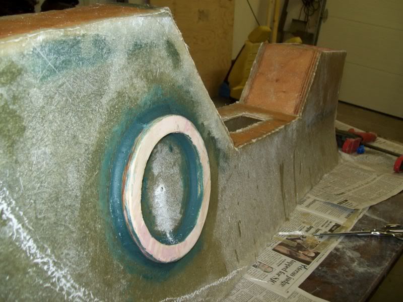

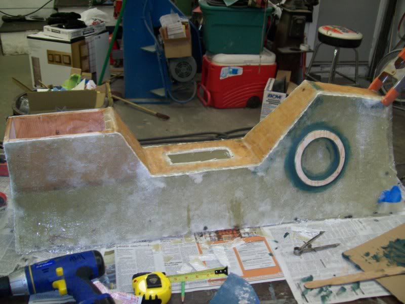

did some more work on the console last night, its coming out good. And after 2 years of primor finally started painting, did all the jams and engine bay, the rest is getting painted tomorrow. Im very happy with how its coming out.
