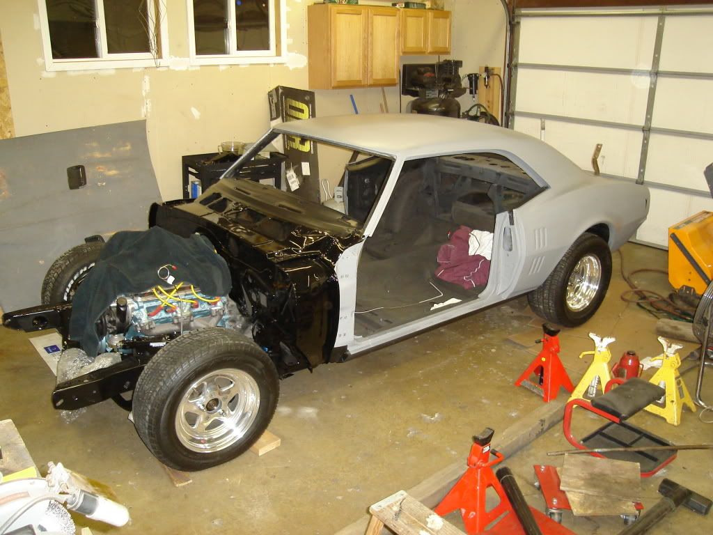

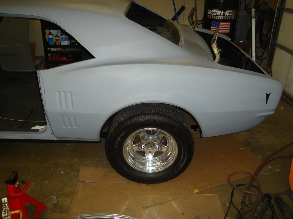

Finally, the car is down on the ground. Just checking pinion angle and to see if the wheels will work from my last car.
I kind of like the old school look but don't want the tires sticking out to far. What do you think of the rears I will probably go with a little less width on the next set of tires if I keep these on the car. I also have a set of RallyII's in 15". New rims and tires are not in the budget right now so I have to work with what I have.

The tires and wheels look great. It's refreshing to see an old school look around here. Seeing way to many 18"-20" wheels on classic muscle these days.

Thanks, I appreciate the comments. I still like the old school look as long as the tires are not sticking out of the wheel wells and you do not have air shocks . I might still check out my rally rims but I will still have a good size tire on a 15" rim.

I like the look of the Weld's on there, they don't stick out too far, considering that is the look most guys went for with that set-up. I'd pull out your Rally's and order up the stencil kit, repaint them, polish the trim rings and see what you like better. I still think that my car looked just as good the day I rolled it home from the paint booth on the 14" rallye's as it does with the 18's on it.

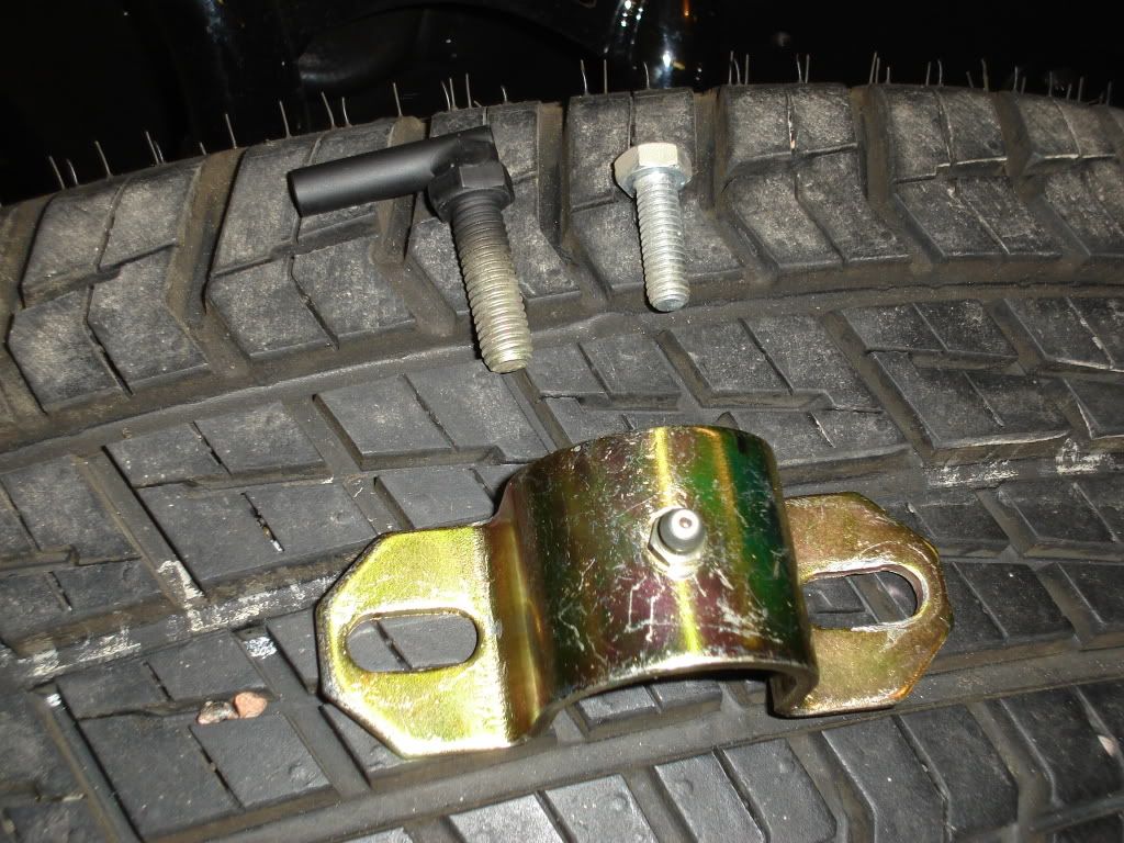

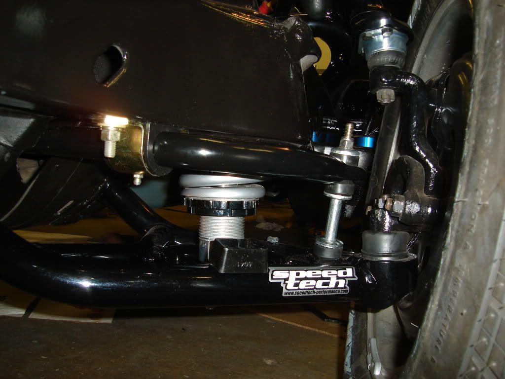

I didn't like how the new sway bar mounted to the frame. With the bigger bar the brackets and bushings did not line up very well. I also thought that some spirited driving might pull the small bolts out of the threaded frame holes. I ended up using one of the original holes and drilling a new one. I also went up one bolt size. This is what I ended up with. I took a grade eight bolt and welded on a tab. I then dropped the bolt through the hole inside the frame. The tab hits the frame and keeps it from spinning. I decided I wanted the front bushings to have grease zerks to help with any possible squeaking. I drilled holes and tapped them for the new fittings.

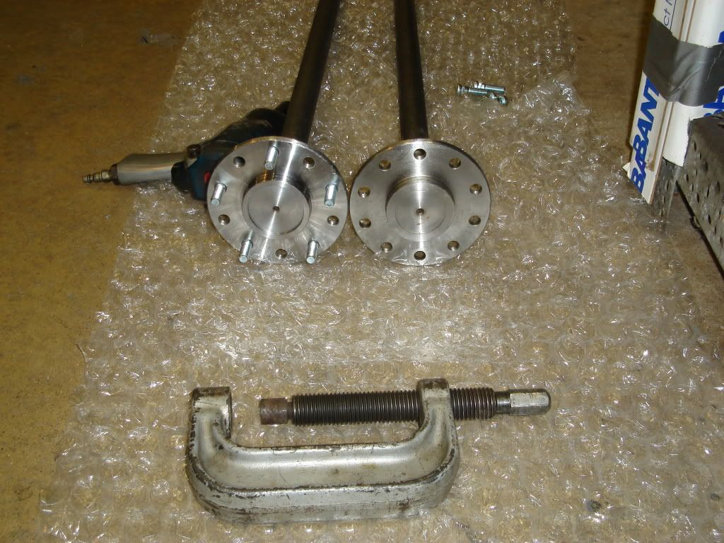

My axles came a few months ago. I borrowed a ball joint tool to install the studs.

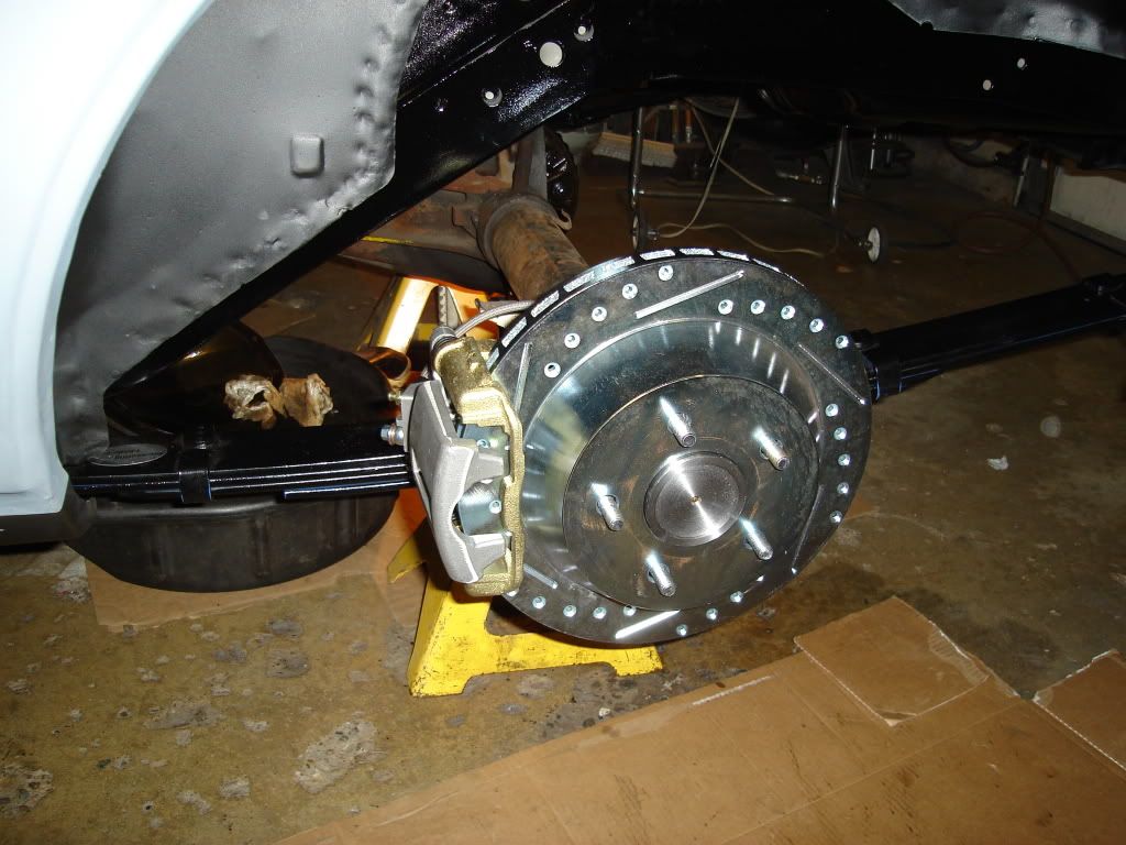

Started to mock up my rear brakes.

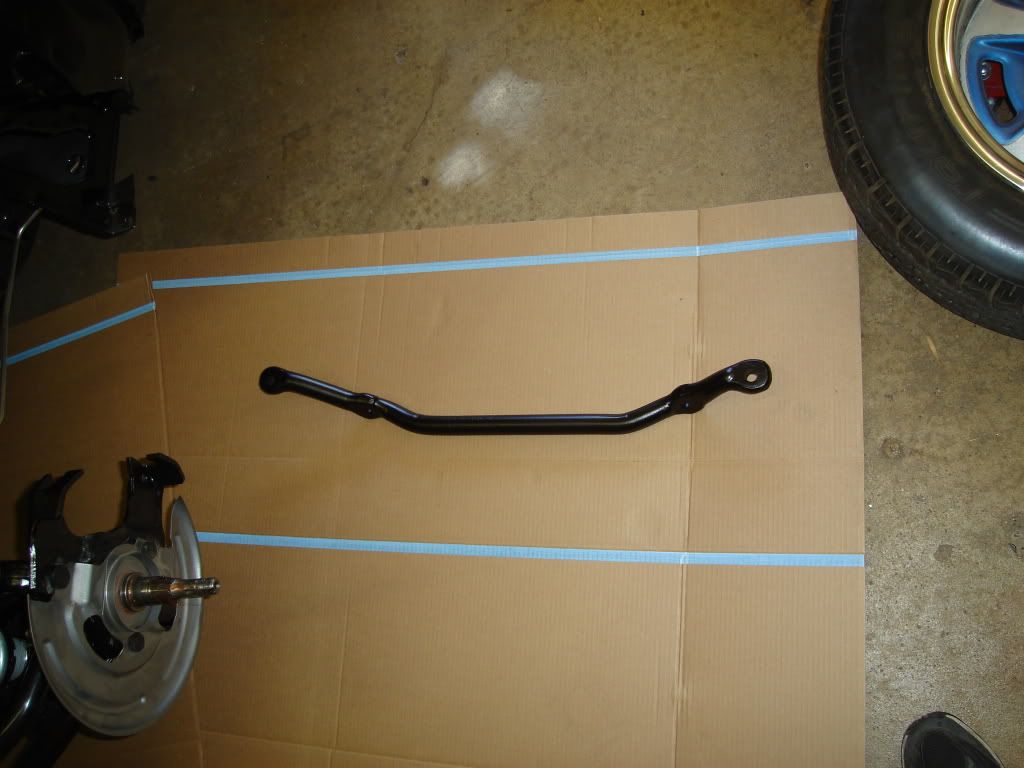

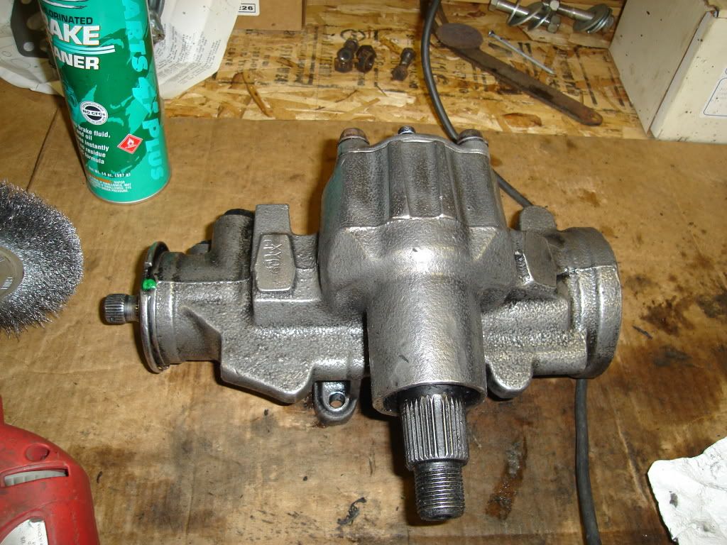

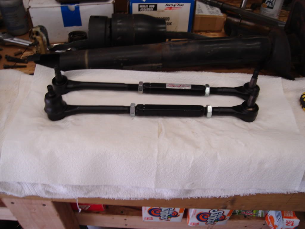

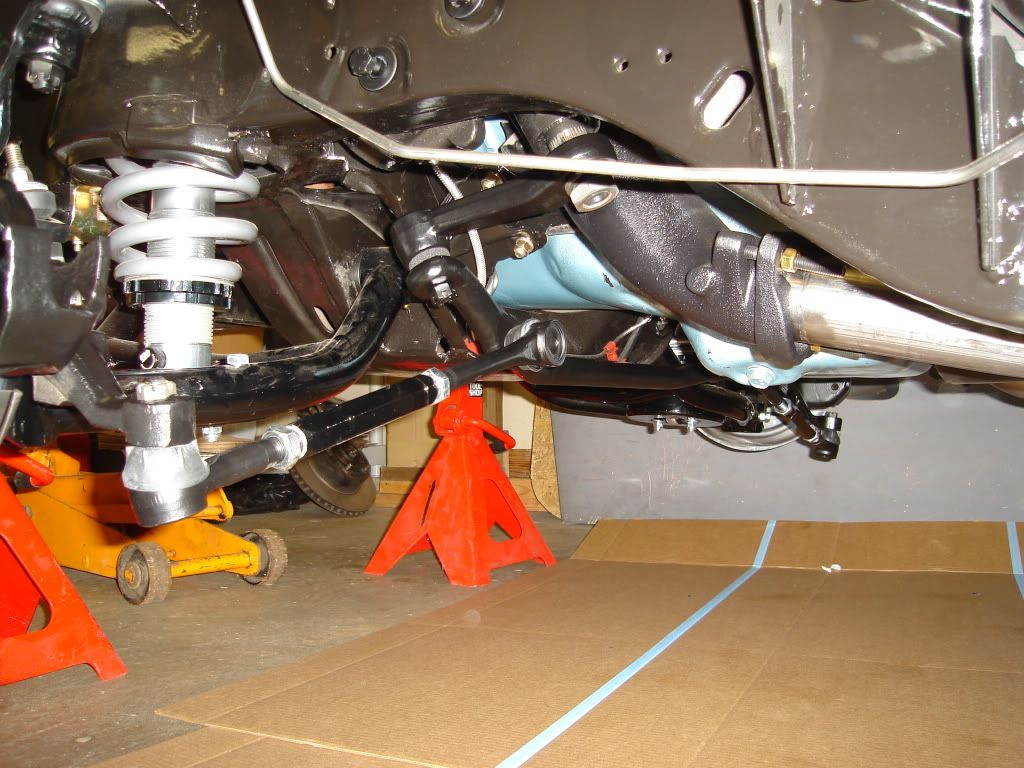

Started on the front end steering. All new Moog parts, Speed Tech tie rod sleeves, and a newer steering box.

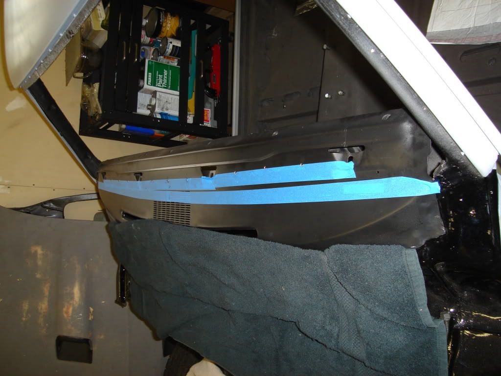

My first car that I restored was a 2nd gen Camaro and most of the OER parts did not fit very well. I was thinking that the 1st gen parts would be better. LOL RIGHT!!

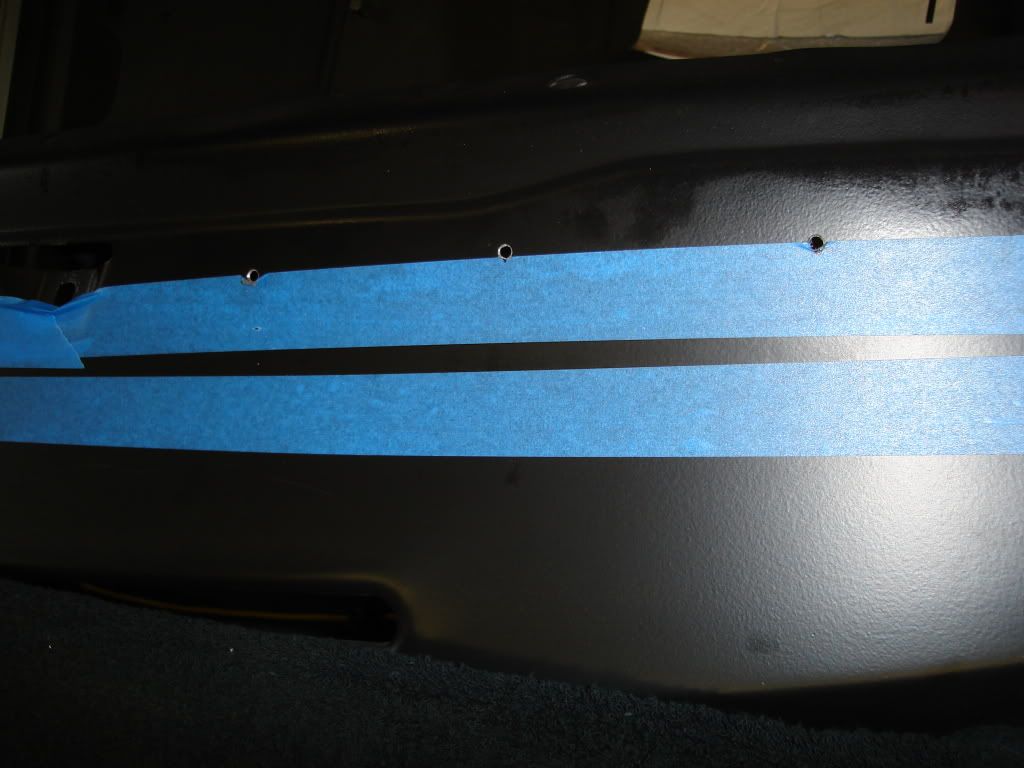

I spent around five hours installing the dash. It would not pull down corrrectly with the original four studs. So I had to drill holes in my new dash and very carefully drill holes in the dash pad. I cut a drill bit down so I could not drill through the dash pad.
