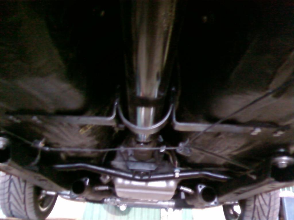

Progress is what progress does.
Just back from the exhaust shop.
Been busting hump to get it all together - I also ordered a new trans mount today that will be here Friday to help reduce any chance of the trans wiggling around.
Terrible cell phone pic, but here is the 3.5 PST shaft installed and the loop.
Also, we ditched the old center exhaust. We had a homemade X pipe on it and went with a flowmaster 2.5" custom X center section. It might flow a little better.
Went around the corn fields a few times with a heavy right foot in 3rd gear - all seems normal, so I don't think we dinked the trans.
Headed to the dyno now on the 14th to try this again - then see you all at the challenge the end of the month.
