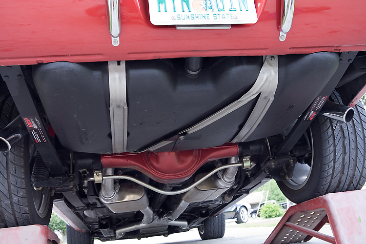

The big issue is the floor. I'll post pics later when I can get them off the camera.
Here is what the bottom use to look like...and the motor. No bling under the hood.
