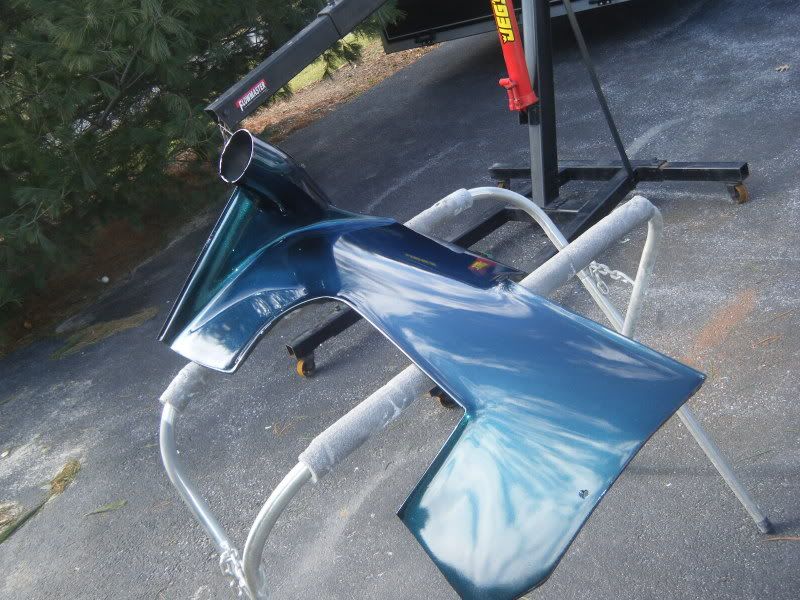

wow! it's black with a candy or pearl coat? Looks fantastic and it looks blue, lol. Good work.

Yup its just black base with two pearls sprayed over top in an intercoat clear. I wanted a aqua or turquoise color like what the car used to be only darker with more of candy look to it, to go with the lowrider/streetmachine themeI'm tryin to make work on this barge.

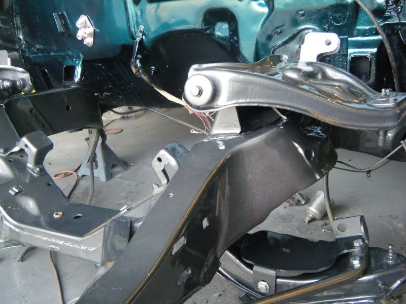

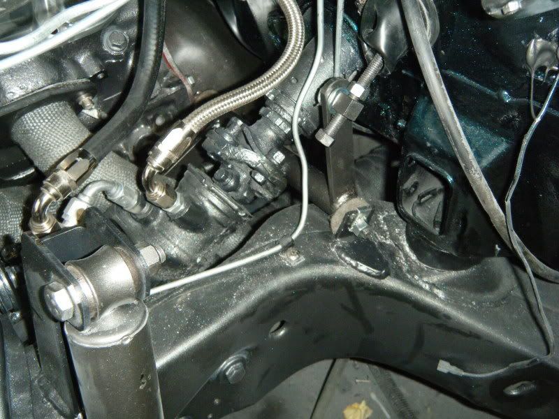

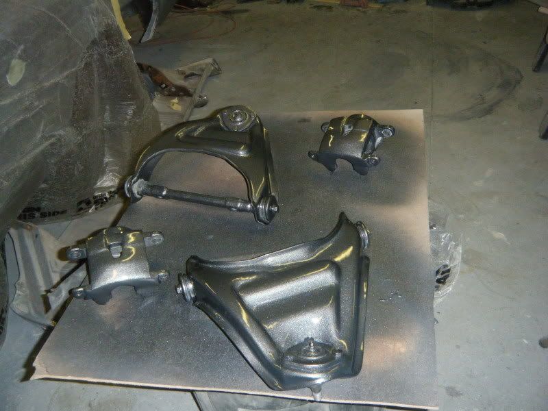

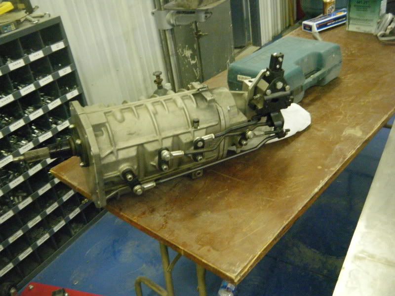

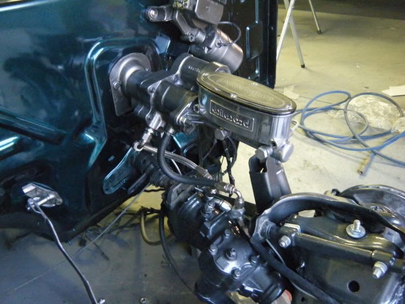

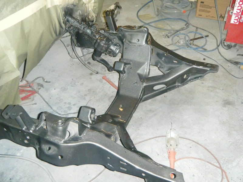

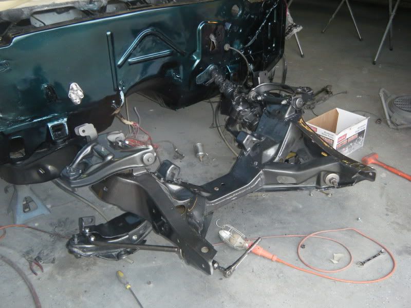

last night i sprayed the frame and suspension pieces before i went to bed so i was a step ahead today to get workin. got all the suspension wrapped up minus the steering linkage thats drying from paint, brake lines off the master, hydroboost and master mounted, master cylinder buffed out. also wrestled the six speed richmond tranny out of dads chevelle so the lenco could go in its place.

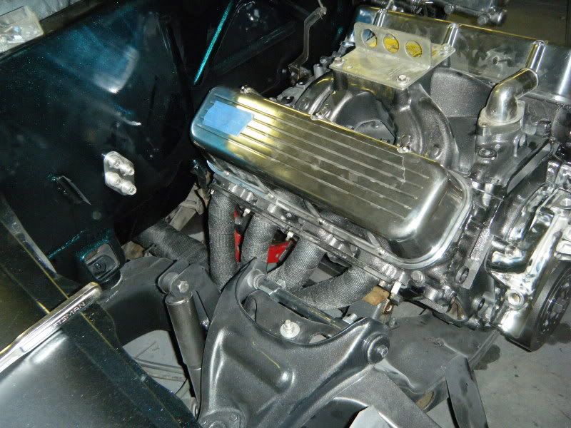

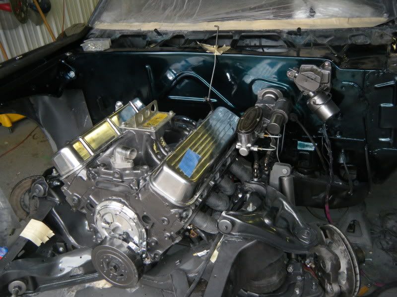

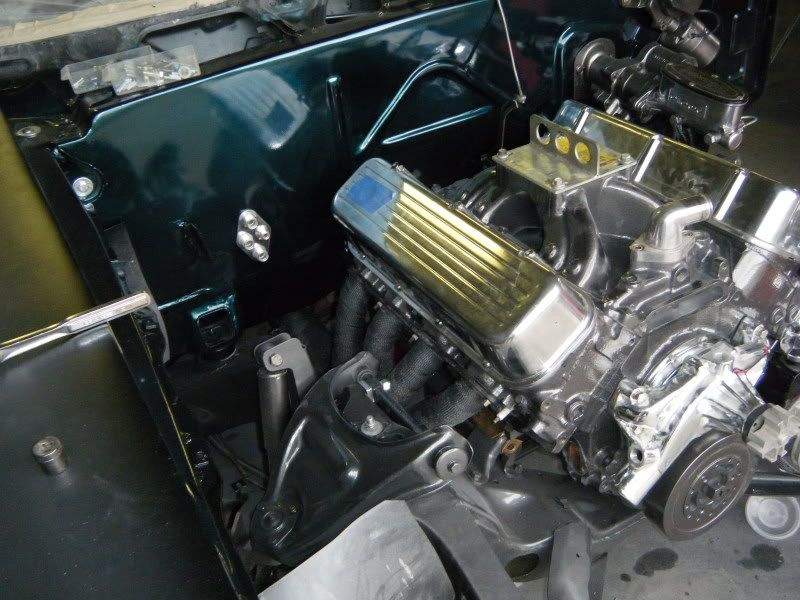

sunday i managed to get the hydroboost plumbing and brake lines wrapped up, sprayed the door jambs and edged the fenders. i realllly like the color with the brown interior. tonight i mounted the fenders up, and after mocking up the engine one last time, i realized im gunna need a touch more clearance to make it over the victor jr intake and air cleaner yet. so i started cutting.....
more action this weekend, let me know what you think!

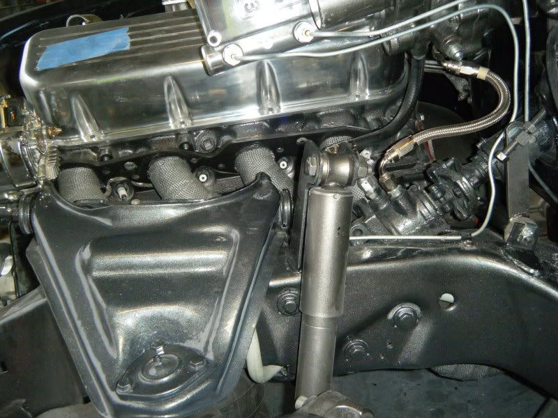

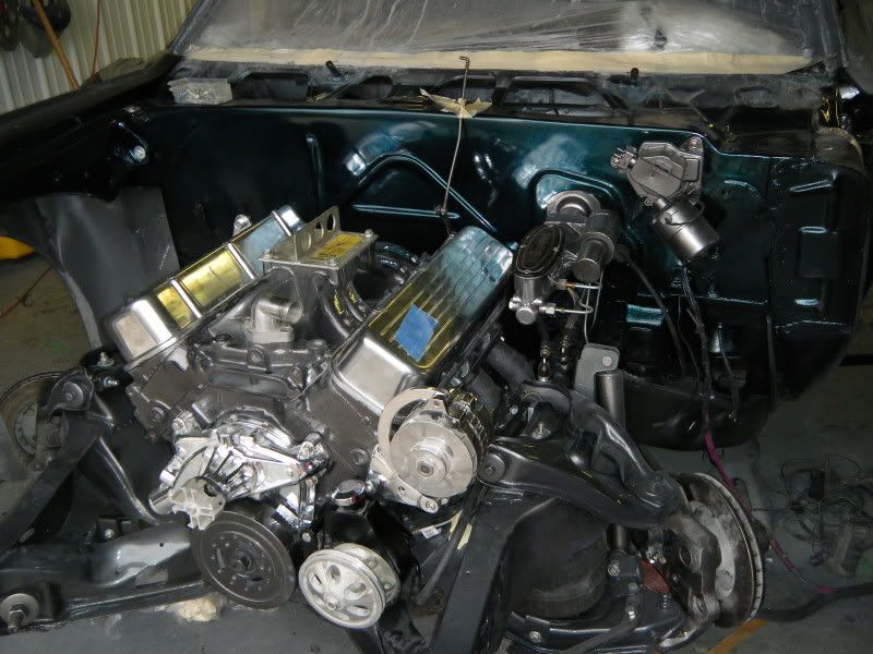

wrapping headers is a bitch. but i thought they would have a bit of an old school look to them, and i think they do. got the engine in for the last time, wrestled the transmission together thats all in together. finished the day off just putting some of the accessories together.
