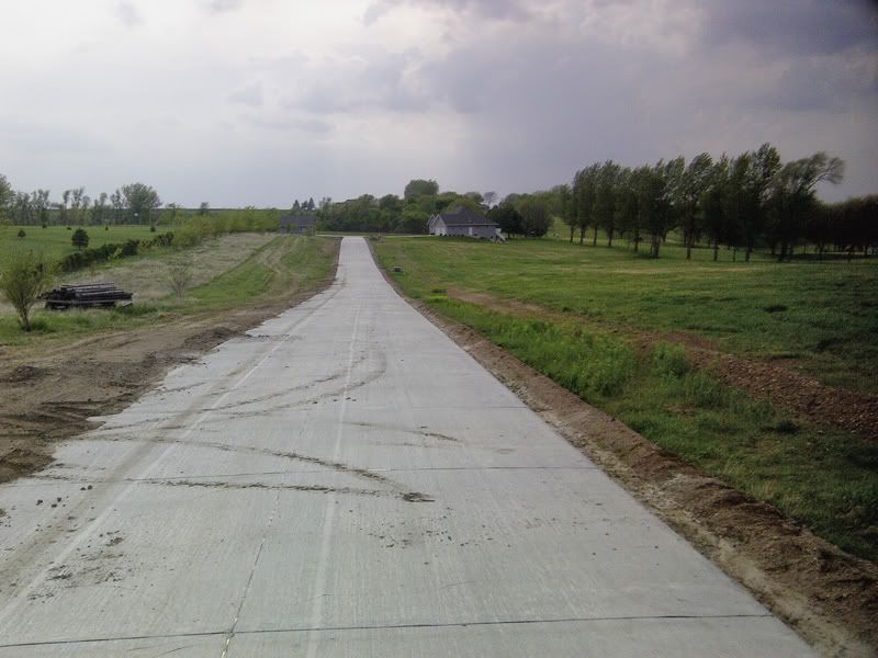

Nice drag strip!
Funny you should say that! They just got done paving the road in our development 2 weeks ago. We've been driving a half mile of gravel for the last 4 years. Since our house is at the very end it looks like I have my own 1320 now!

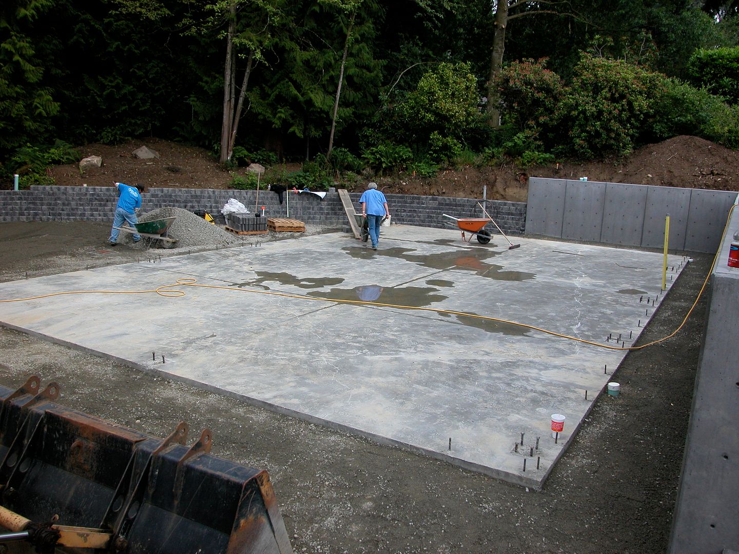

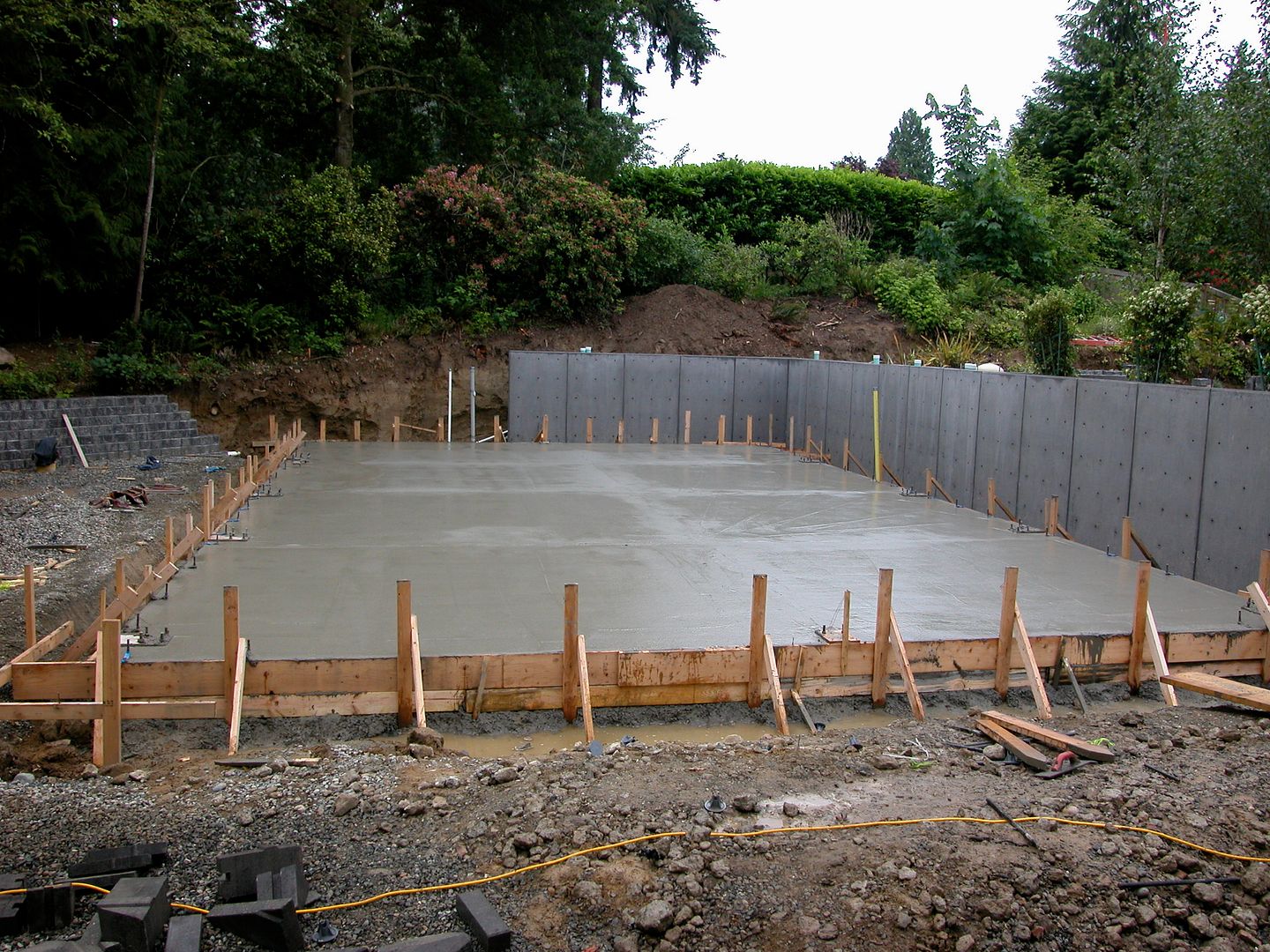

The building was 20 grand (3K for skylights!) and worth it!
The pad was 11 grand - thickened edge - #4 rebar - fiber reinforced - stainless steel joint "thingies" - 6" minimum thickness - and vapor barrier!
Can't remember what the doors cost but they were at least 3 grand with commercial openers installed
I had to buy a compound sliding mitre saw and stand -- $500
I bought 2 drills (the ones in our hands in the pic) Gave the one my buddy used to him when we were done and gave him a grand to help me
At least $1500 in RENTAL FEES for ZoomBoom and other lifts
A couple grand for the insulation guys - used 6" high density bat
I did all the electrical but still have a couple grand in fixtures - panel - wiring - conduit etc
We moved 180 double truckloads of dirt before anything else. The excavator operator was $185 an hour - and it cost $9 per cubic yard to DUMP the dirt I paid to haul (three double dump trucks - one being loaded - one running - one waiting) so I was about 125 grand into moving earth before doing anything else.... and fugidaboud the retaining walls -- driveway paving - blah blah blah blah
I should have sheeted the roof before installing the standing seam roofing - I was told not to - they were wrong and it looked "wavy gravy" (remember him from Woodstock?)
So when I roofed my house last year - they tore off the standing seam - sheeted and put on matching roofing to the house. MUCH MO BETTA!
