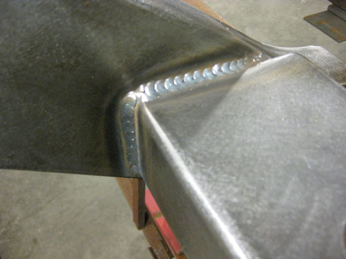

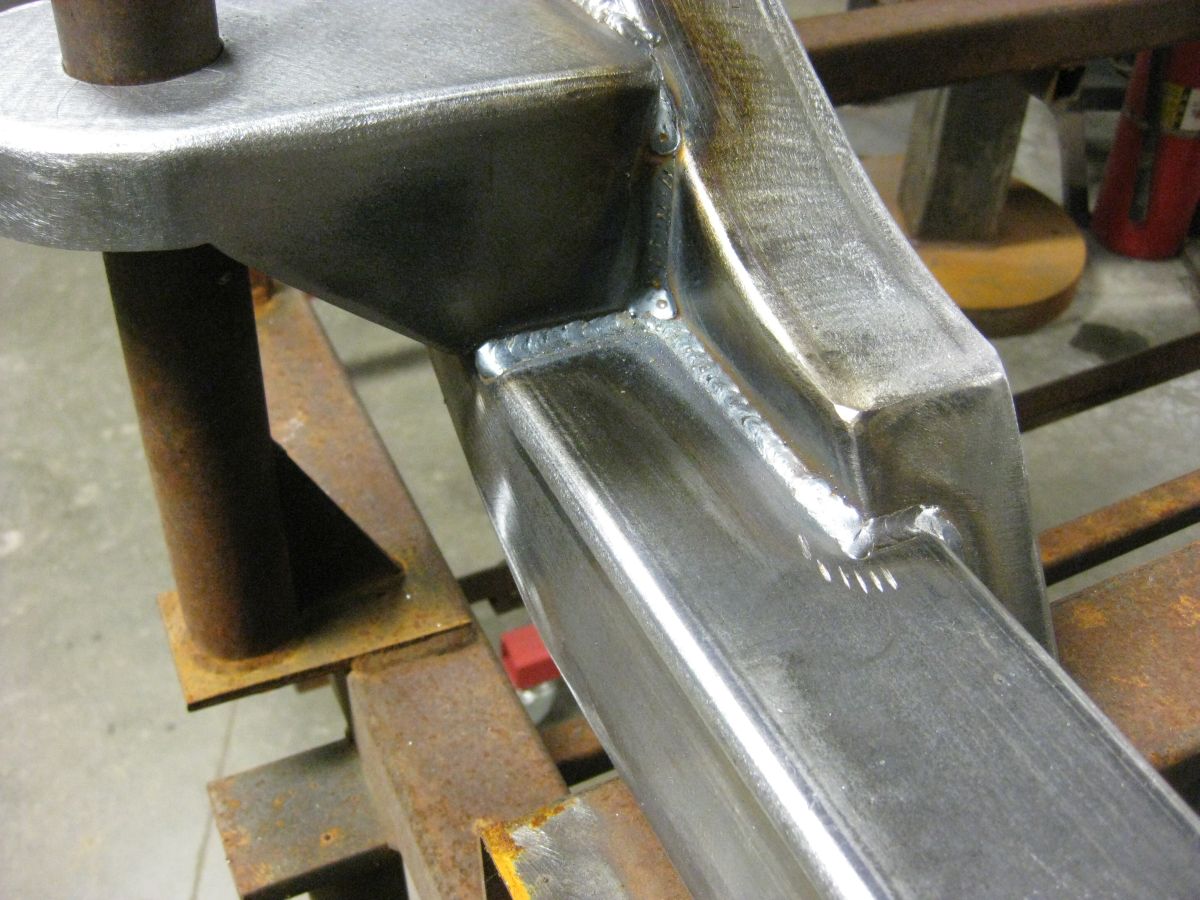

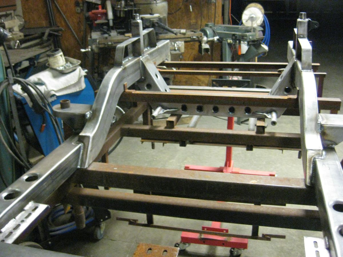

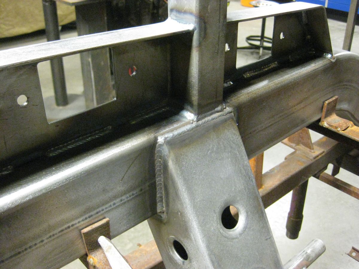

I got back home to see pics like this:

His welds are amazing! its going to be a sweet ride when the both of you are done with it. Keep the up dates coming I love to see build pictures.

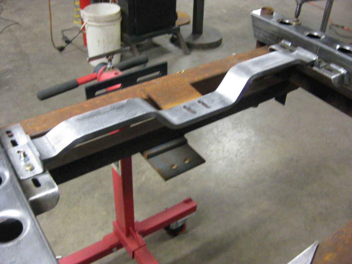

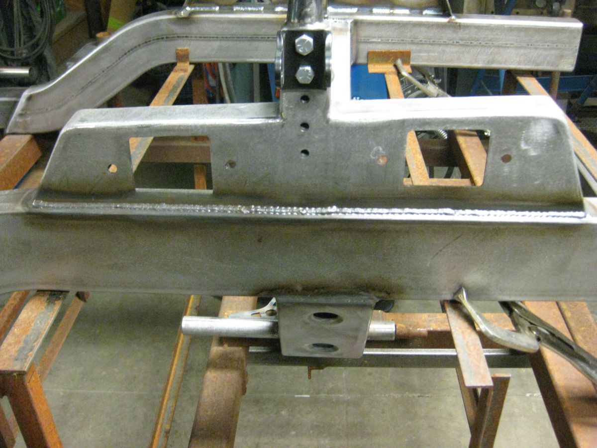

Looks like I have a high clearance transmission mount - I have four pics of this, but this is the best:

It looks like its designed better then a factory one, Plenty rigid.

I am jealous, I have his first rendition of the subframe and it looks like he is really stepping it up with the trans crossmember and all of the cool lightening holes. His RideTech prices were great and I bought my coilovers when I got my subframe. Until I found my local builder, I had talked with him about sending my Firebird up to him.
