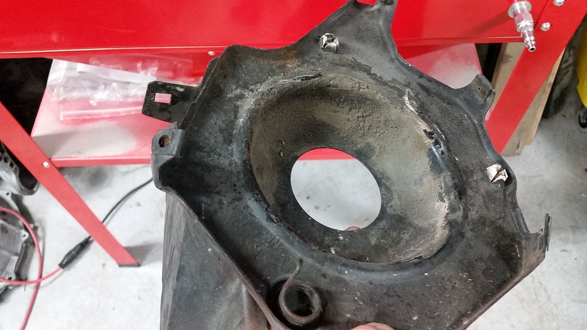

Ever since I assembled my glass-bead blast cabinet, I've wandered around the shop and looked for stuff to blast. It is almost addicting, to restore metal. I try my best and save original parts when I can, as they tend to fit better and seem more sturdy than repro parts. I should have had one of these years ago, I use it a lot.
This was buried under the paint. Pretty cool to find.
With those items blasted, as well as headlight buckets, I installed the DSE headlights and Marquez billet fog lights. I didn't realize the Marquez lights were not just a simple bolt-in. It requires drilling two new mount holes, and cutting away the original light support bracket. That was nerve-racking, working with a drill and air cutter around fresh paint. Not a reversible modification, you'll have to commit to doing them and keeping them.

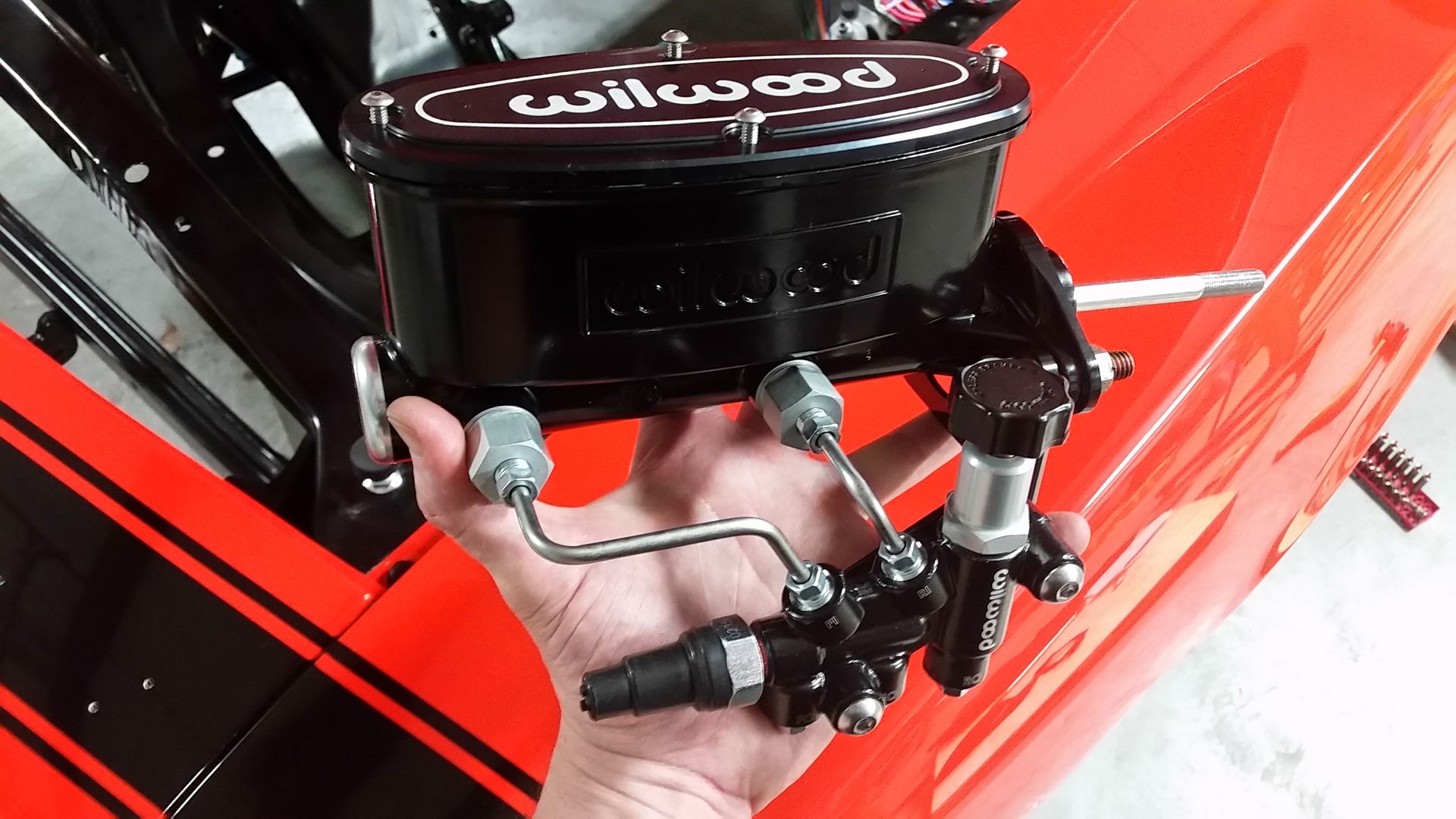

Also spent some time doing some final body/gap alignment on the front end panels. Started assembling the brake master cylinder setup, which was a nice piece. Wilwood 7/8" master with their optional proportioning valve system. The kit came with all the tubes and brackets, making this an easy and clean assembly. Will run brake lines this week.

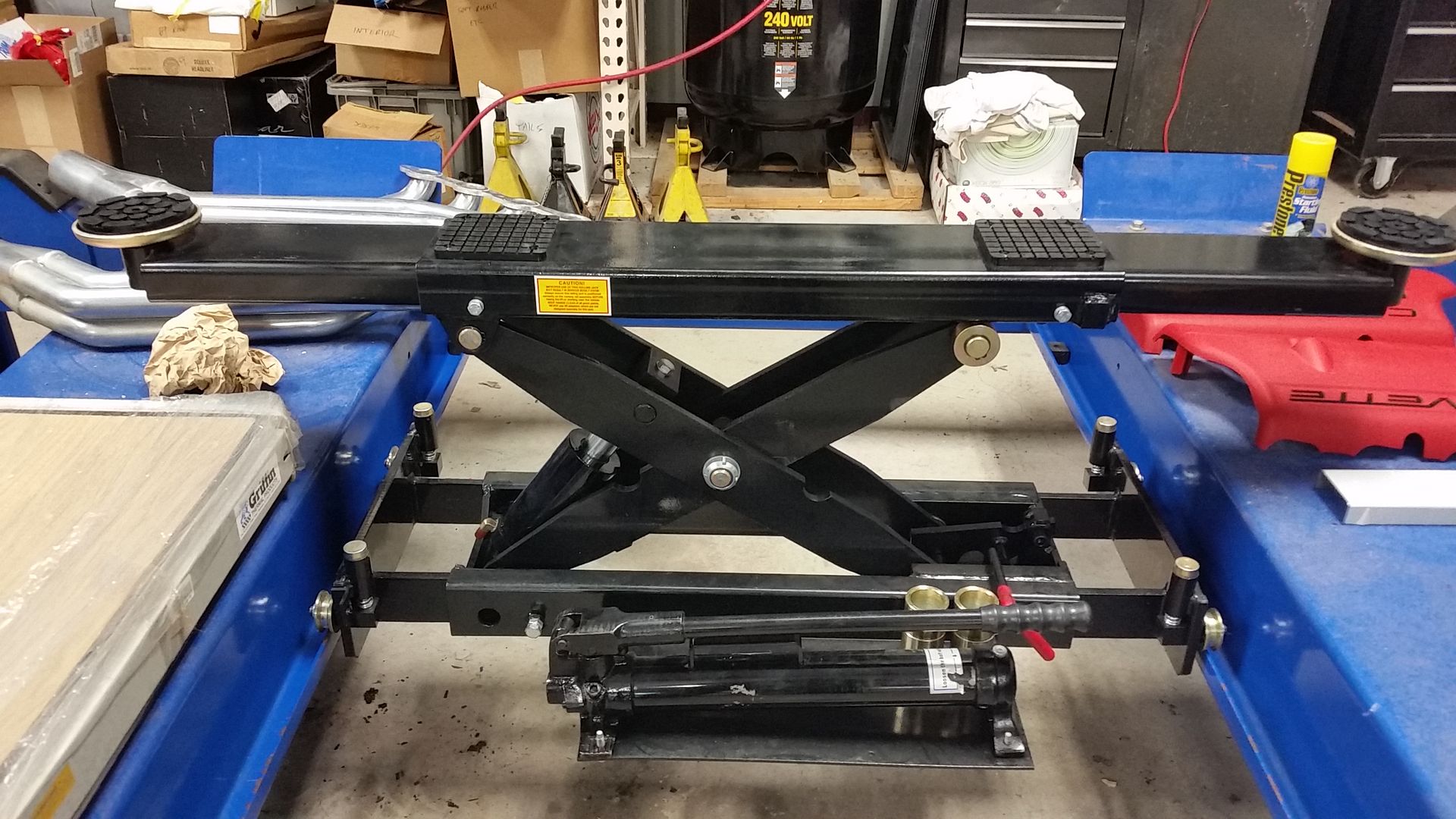

I'll be moving the car to my 4-post Rotary lift for final assembly. So, I upgraded it with a new jack system. I like new tools
