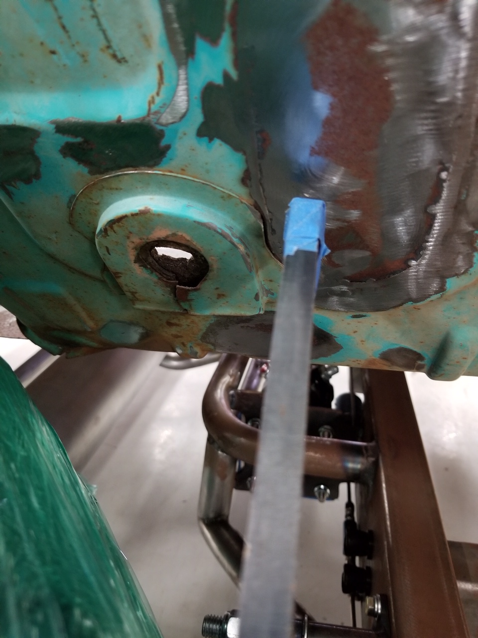

Here is where the brake pedal came from Progressive. Clears the exhaust manifold, but moves it over where the column is. Hmm. I am using a Wizard Fabrication Steer Clear and have my column way up high on the inside of the cab because of my 59 Impala dash, so this does not cause a problem for me. I am still changing the pedal so it is closer to the factory location. I mounted my truck low on the frame. I moved my mounts on the frame lower. It's still rubber mounted and clears everything by about 1/2"
Don: Where does your brake pedal want to hit the firewall?
Todd

Thanks for the pics. I think your pedal is 2-3 inches further over than mine.

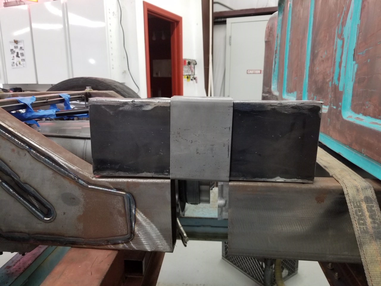

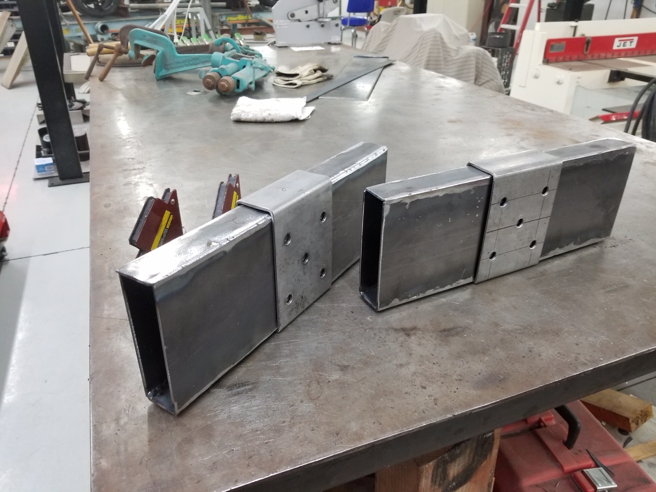

Here we go. Bob(Progressive) sent me some matching 2"x6" frame rail so I could extend the chassis. Today we built the inner sleeves to make sure that the extension will probably be the strongest part of the frame. Tomorrow we should have this completed, then torque tube comes out to get lengthened at Gamel Street Rods.

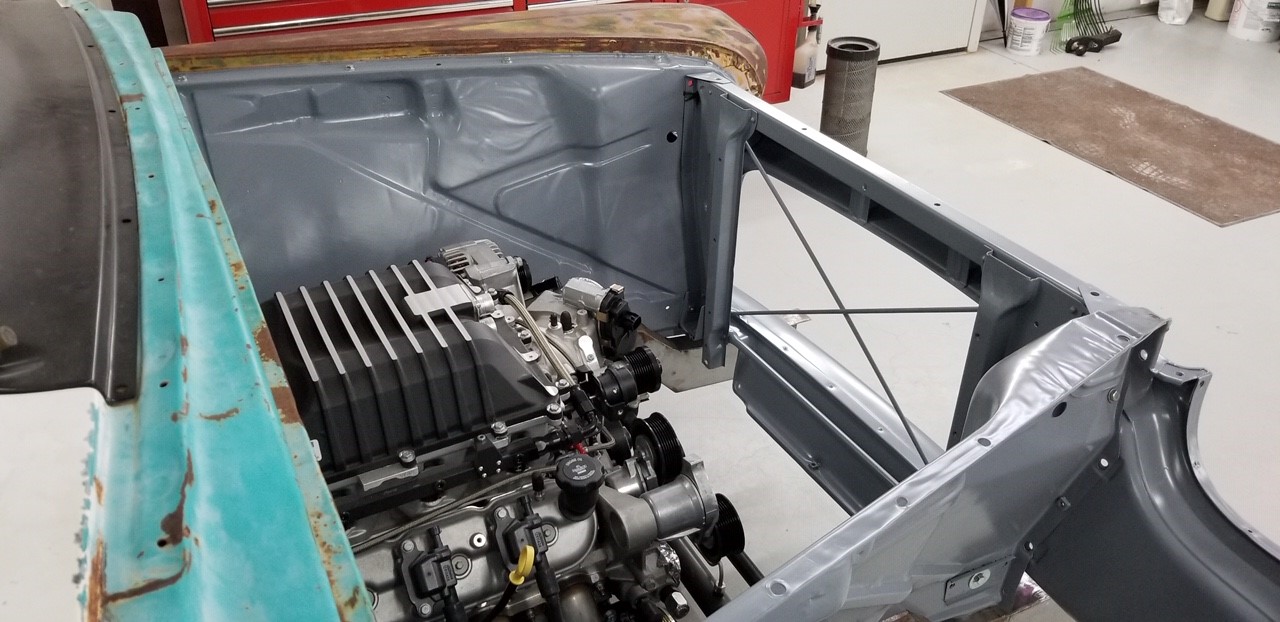

Some more updates today. Still have metal work to do on firewall, but we are getting it things closer. Waiting for the torque tube to make it's way back from Gamel to make sure the engine is in the exact spot before finishing firewall.

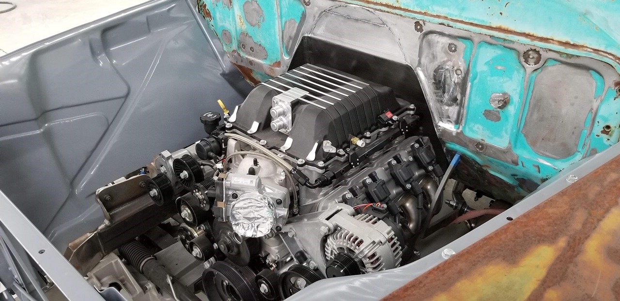

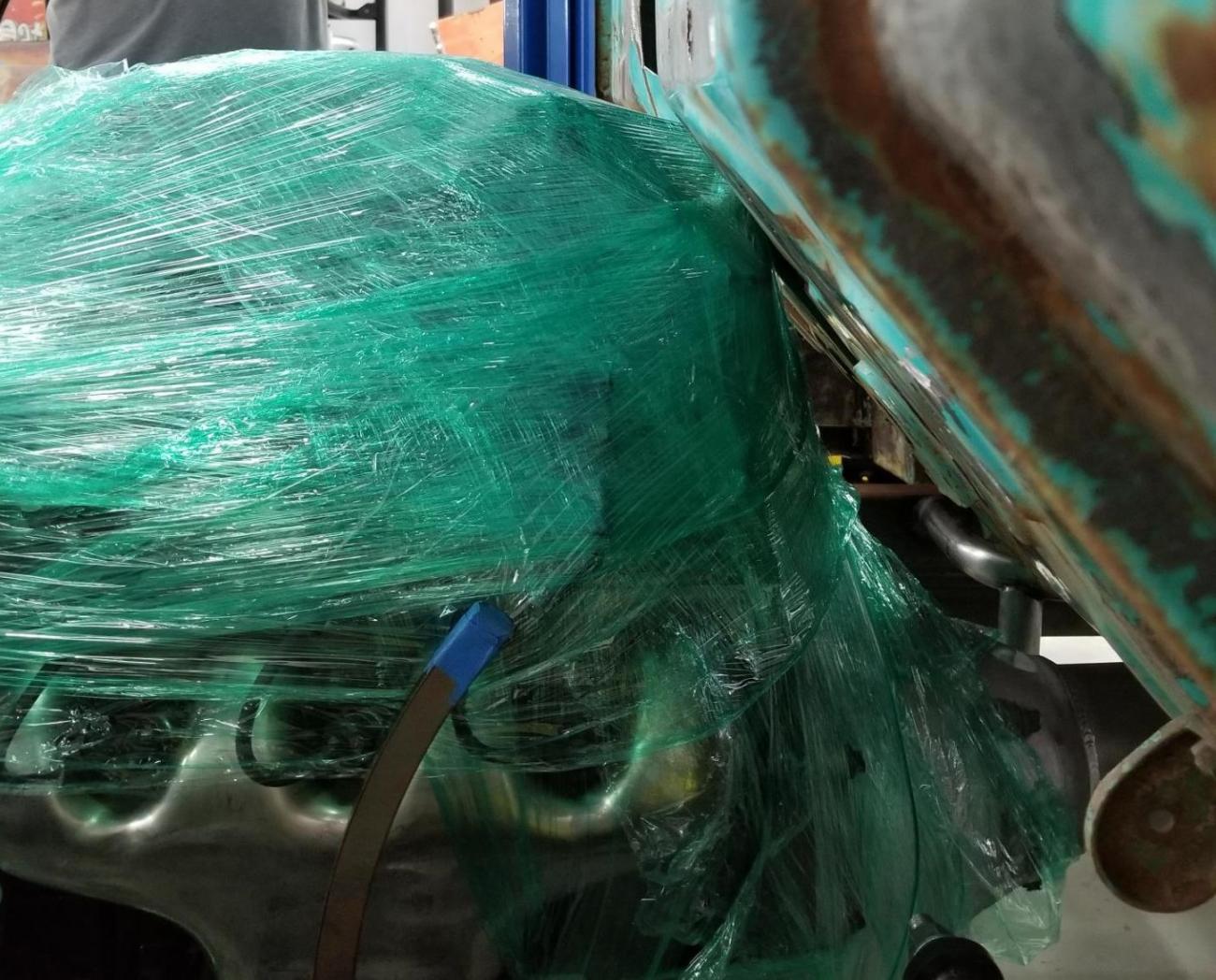

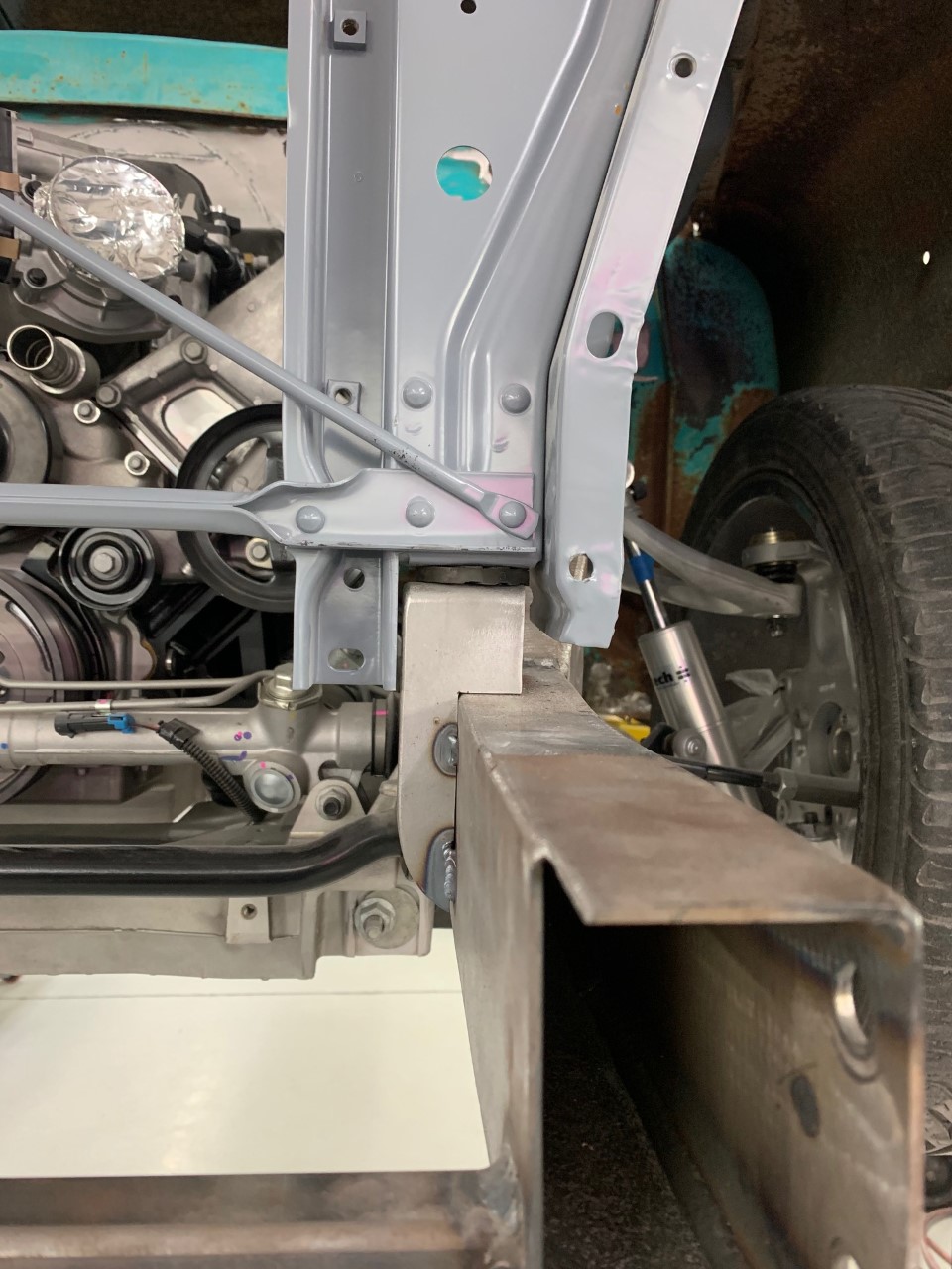

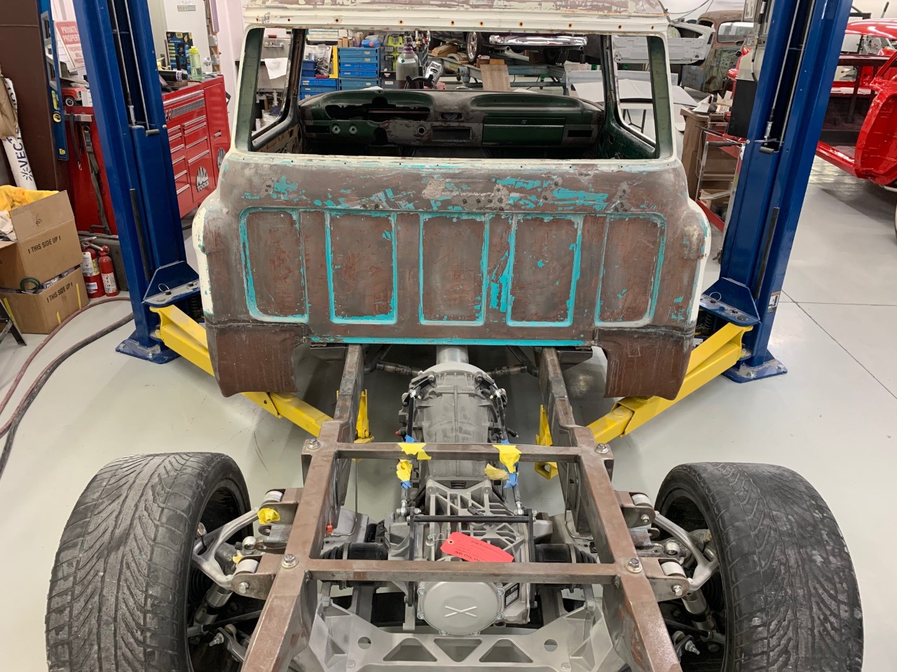

Finally back on things. Chassis was off a little bit so we had to take the cab mounts off the pass side and zero in the cab and front end assembled before welding back on the mounts.
Well, cab mounts and the core support mounts are tacked on too. Everything is lining up nice now and centered...
Here are current pics.
