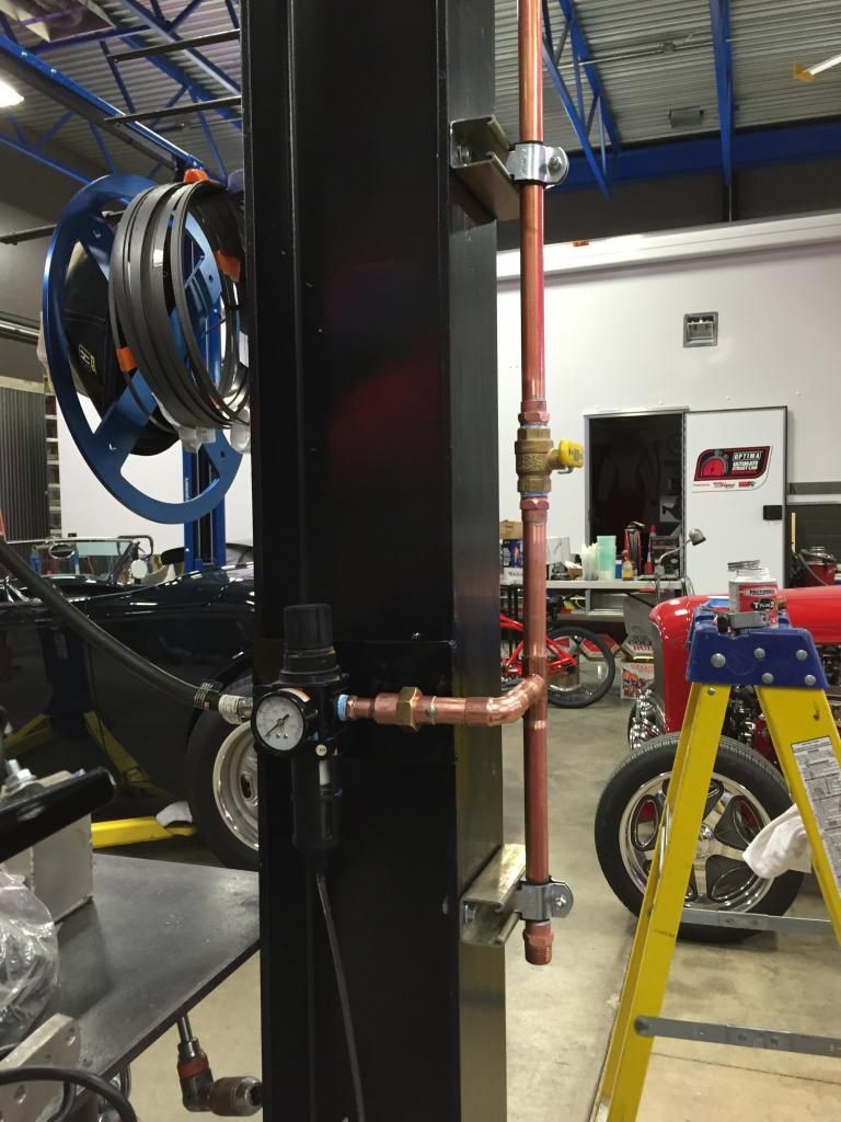

Got the plumber working on Sunday - running air... I can't stand to be without it another day!! Get 'er done!!
I use this smaller regulator near the bench because I want to be able to control the air for "fine" work sometimes.

Plenty of line length there for the air to cool down some.

All the drops run 6" UP from the home run... and all have a blow out valve at the end of the drop run. This pic doesn't show that 'cause he put the valve and extension on after I took the pic.
I also had him put in capped off "Tee's" in every run (except this one) so I can add if I need to later. Also everything has unions so I can remove the regulators if they have an issue.
