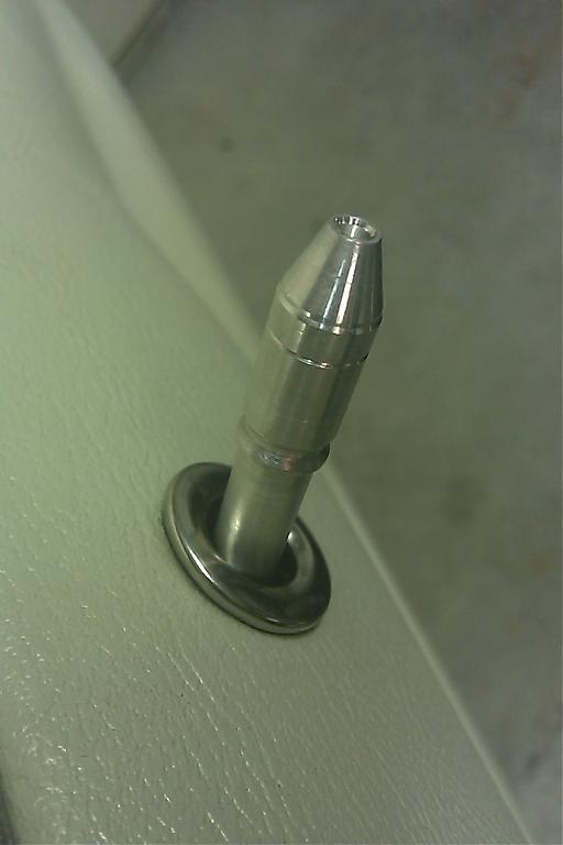

One of my favorite touches was a set of billet 9mm locks, had to re-tap them to fit my car.

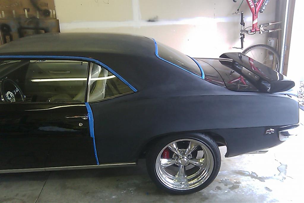

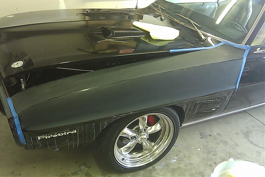

I put about 50 hours into wet-sanding and buffing the car prior to Car Craft last weekend. I started on the prior Saturday, and realized quickly that I was going to be short on time. In only got through the 2nd stage of buffing (swirl-mark remover). I intend on going back over the whole car with the extra cut compound since the hood was the last thing I did, and I perfected my method and realized the rest wasn't good enough. All in due time, it's time to enjoy the car, but at least now the orange peel and fisheyes are gone.
I used all 3M compounds and pads with a Makita buffer. I'll get some pro pics up of the final product when I get a chance.

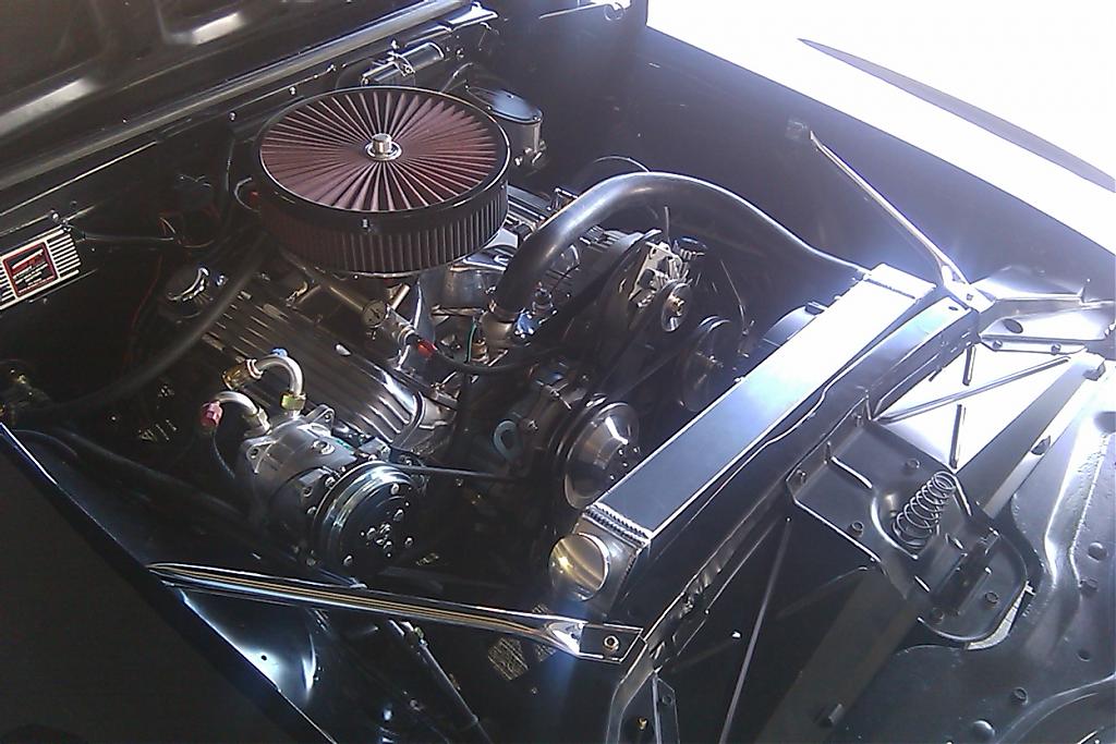

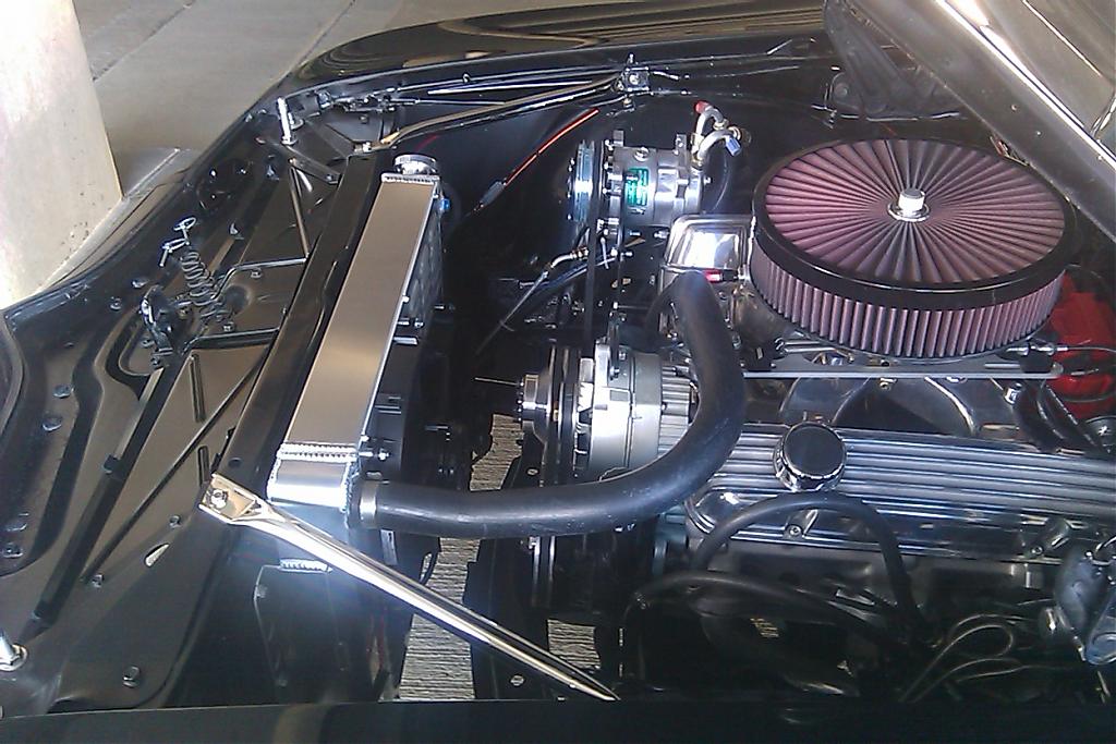

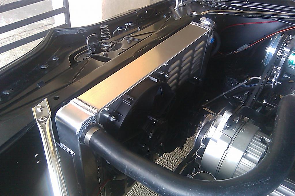

The best change I've made is the new aluminum radiator and twin Spal electric fans with digital controller. I just got the install finished last night. It was running hotter than I'd liked (200-210*) and got especially warm at the Car Craft show where I had to pull over and let it cool down on the show grounds, which was not fun. Staring at my new Autometer temp gauge the whole time took alot of fun out of it.
Fortunately, my buddies tents were right next to Universal Parts Inc, an outfit out of Humbolt, IA that specializes in aluminum radiators with Spal fans. I got the whole set-up for $800, with the digital controller, relay, sensor, etc. I bought it on the spot. It's the best looking, and highest quality set-up I've seen for that kind of money. Fully welded, no epoxy.
Drove it to work today, and am very pleased. So much quieter and smoother without that big mechanical fan blowing. I was in such a state that I didn't realize the one I got was for an Automatic...it didn't occur to me that they may have a Manual version. Well, not much difference other than the fittings for the trans cooler. I am going to block them off with some plugs for now, but am thinking about turning it into a PS cooler...not sure if it'll be adequate for an oil cooler.

Thanks Ron! The locks are from Steeda for Mustangs. I thought they would drive the point home if someone was foolish enough to start fiddling with it.
The thread is wrong, likely metric, but it's the correct diameter, so I figured there was enough material to just re-tap them, which I did and it works.
