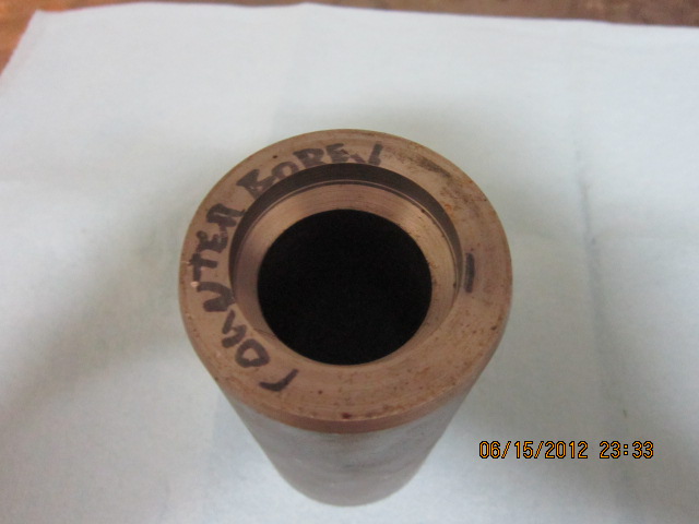

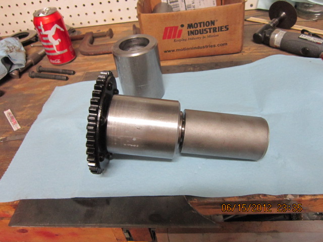

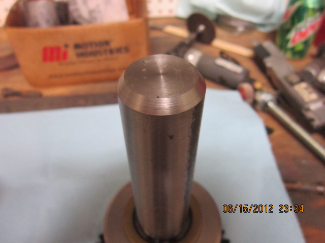

My tool and die friend finally finished the pieces for my rotisserie that he and I collaborated on. It is my design with his tweaks. It uses a worm gear to rotate the body when attached. I incorporated trailer spindles and tapered bearings. My friend machined the round stock for me to accept the bearings and helped me to get the worm gear setup to work within my design. The chamfered areas are to allow for better weld penetration and also to allow room for the piece to fit over weld beads. Once I have the rotisserie done and post finished pics of it, it will make more sense
