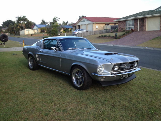

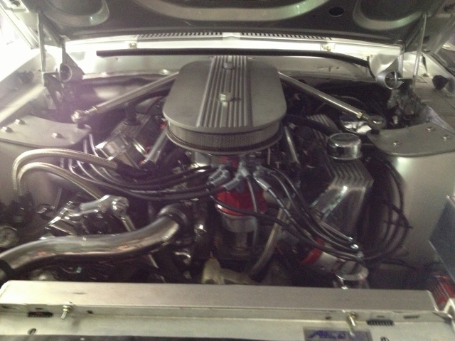

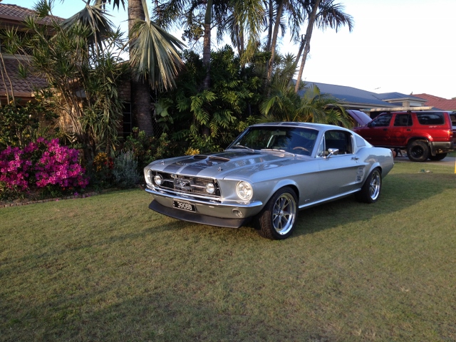

HI guys ,
My first post i am building a 1967 390 s code 67 fastback ,car has been in Australia about 12 years when i purchased it ,it was in a sad state it had been repainted various times its original colour is silver frost . Have no history of its past life but someone at sometime had laid it to rest with 3 45 caliber rounds ,so i consider this its resurection . The rebuild so far .
Full body rebuild and repainted brilliant silver with argent silver lemans stripes.coil over front and rear suspension TCP 4 link rear . 330 mm front discs with late model spindles and 4 spot calipers .Engine is a 390 FE with a 4.125 stroke Scat crank H beam rods diamond flat top pistons 433 cu in .
Edelbrock heads with Dove tunnel wedge manifold running a F&B TRI POWER fuel injection setup with a FAST XFI management .Engine is being assembled and waiting on manifold to arrive from USA . Will post some photos on progress.

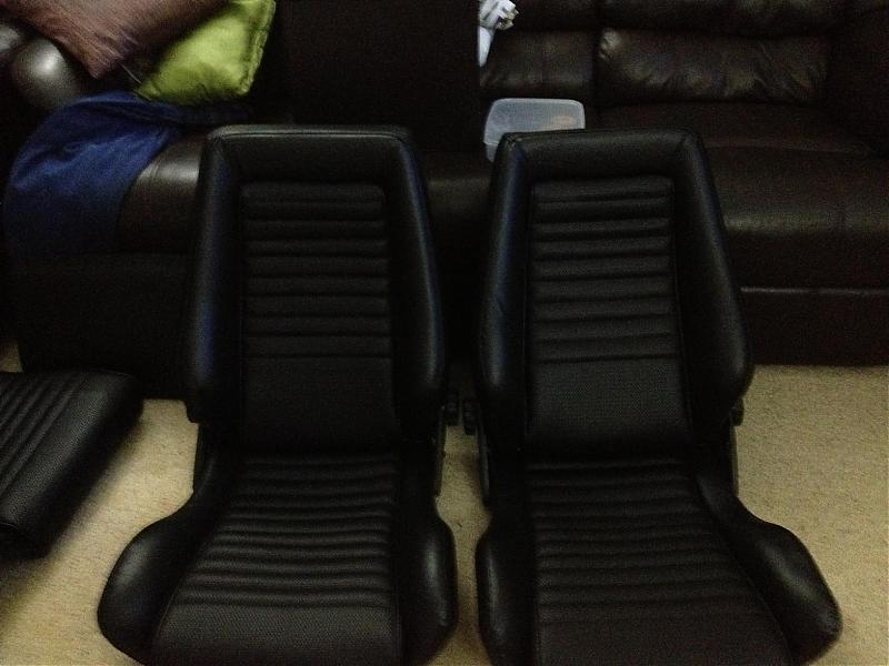

Some build photos
