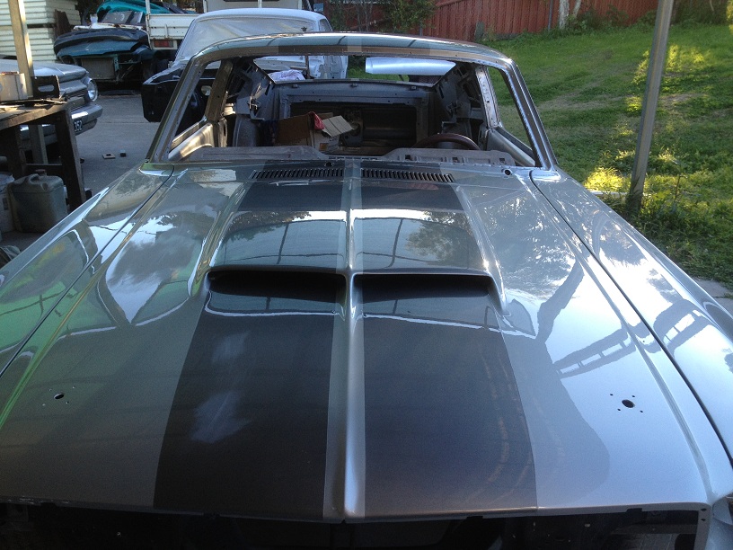

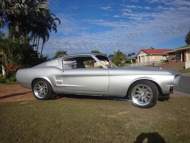

HI guys ,
My first post i am building a 1967 390 s code 67 fastback ,car has been in Australia about 12 years when i purchased it ,it was in a sad state it had been repainted various times its original colour is silver frost . Have no history of its past life but someone at sometime had laid it to rest with 3 45 caliber rounds ,so i consider this its resurection . The rebuild so far .
Full body rebuild and repainted brilliant silver with argent silver lemans stripes.coil over front and rear suspension TCP 4 link rear . 330 mm front discs with late model spindles and 4 spot calipers .Engine is a 390 FE with a 4.125 stroke Scat crank H beam rods diamond flat top pistons 433 cu in .
Edelbrock heads with Dove tunnel wedge manifold running a F&B TRI POWER fuel injection setup with a FAST XFI management .Engine is being assembled and waiting on manifold to arrive from USA . Will post some photos on progress.

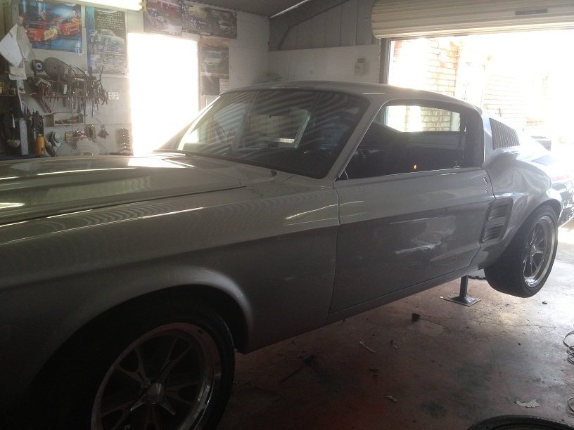

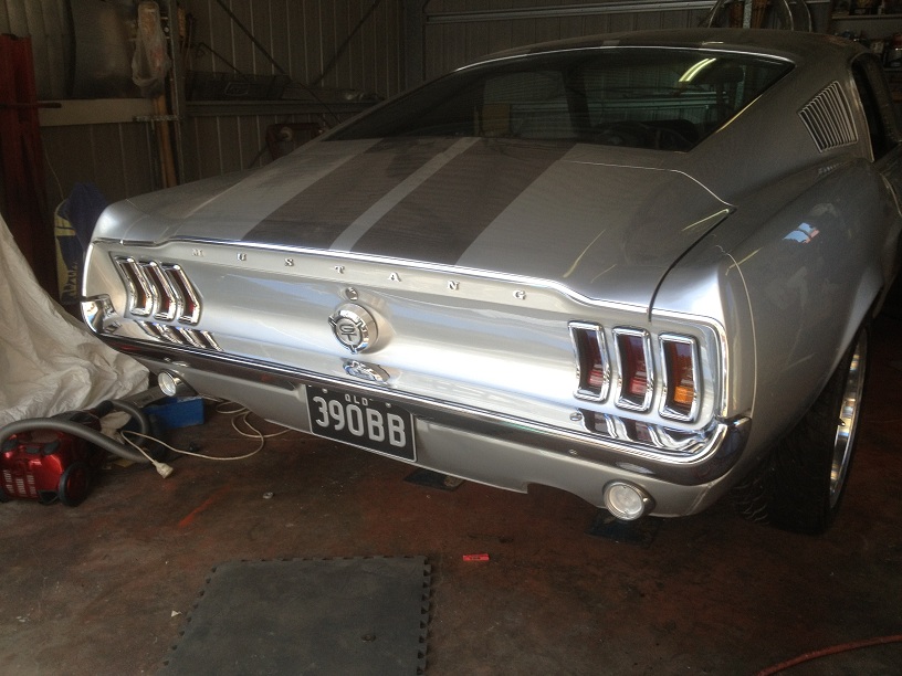

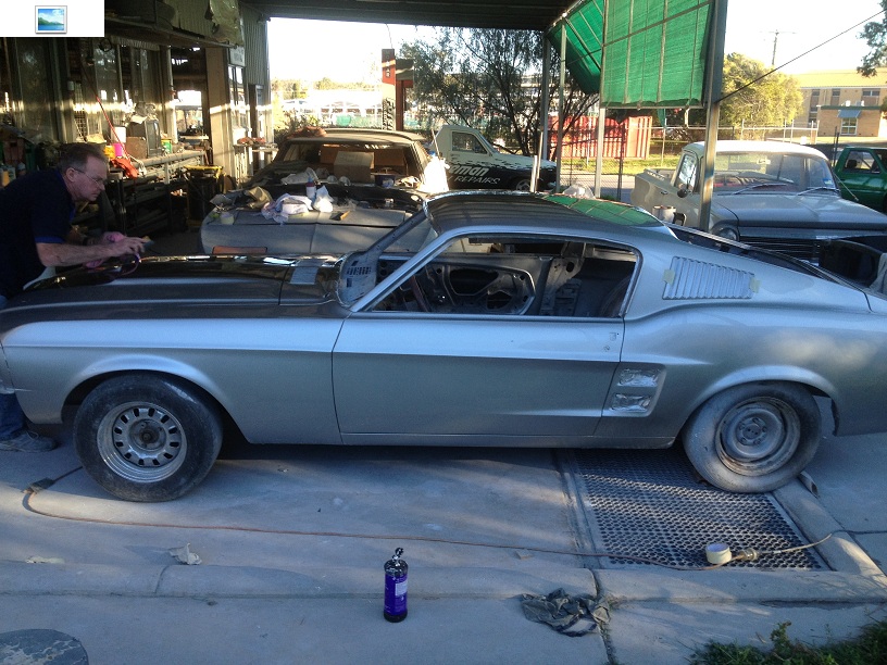

Some build photos

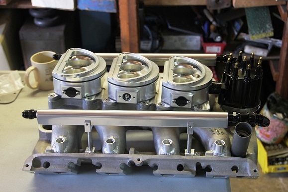

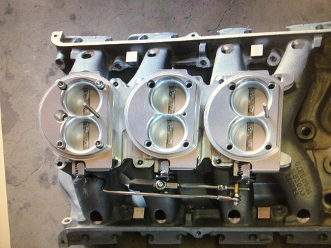

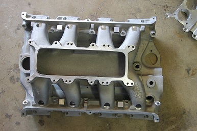

More photos of the manifold
Killer piece. Is it relatively easy to tune?

Default Tri Power
Manifold will run 3x600 cfm throttle bodies with a progressive linkage . I have been told that on the 440 mopars that F&B have fitted this system too that they are very drivable .With the centre throttle body bringing in the torque earlier .As far as tuning it i hope the XFI FAST will bring this engine to life . Trans is a TKO 600 with 3.5 diff gears . As far as the Tunnel wedge manifold there were concerns with air speed but since it is fuel injected it should work OK. As you can see it has a large plenum what do you guys think .Car should have some under bonnet appeal with Cobra Lemans valve covers ,and a polished oval aircleaner when it all comes together i will post more photos .
