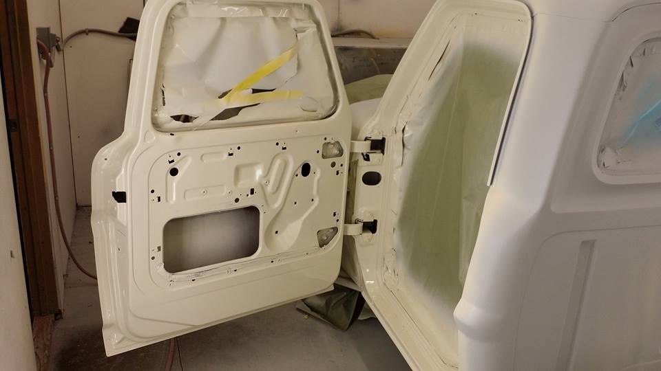

Old 04-21-2014, 12:23 PM
BritishGreen68 BritishGreen68 is offline
Join Date: Nov 2007
Location: PDX oregon
Posts: 320
I got the door jambs painted before Aaron left
Chris
