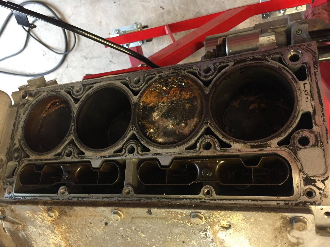

Well after some reading I decided to take the head off and just have a machine shop fix me up. Read good things about Late Model Engines in Houston. Cool, no big deal getting the hole repaired. So I get the head off and see bunch of rust on the cylinder walls. Guessing hurricane Harvey waters sitting in the garage for a week got moisture in the motor through the exhaust ports, they just had rags stuffed in them. I've had enough of this for today lol. Time for a gun range trip to relax

Just as a tip to help you prevent some flash rust in the cylinder by taking a clean rag and putting some Automatic Transmission Fluid on it and wipe down the cylinders liberally.

Was there water in the crankcase?
No there wasn't. Everything was very clean when I had the oil pan off to install the holley pan

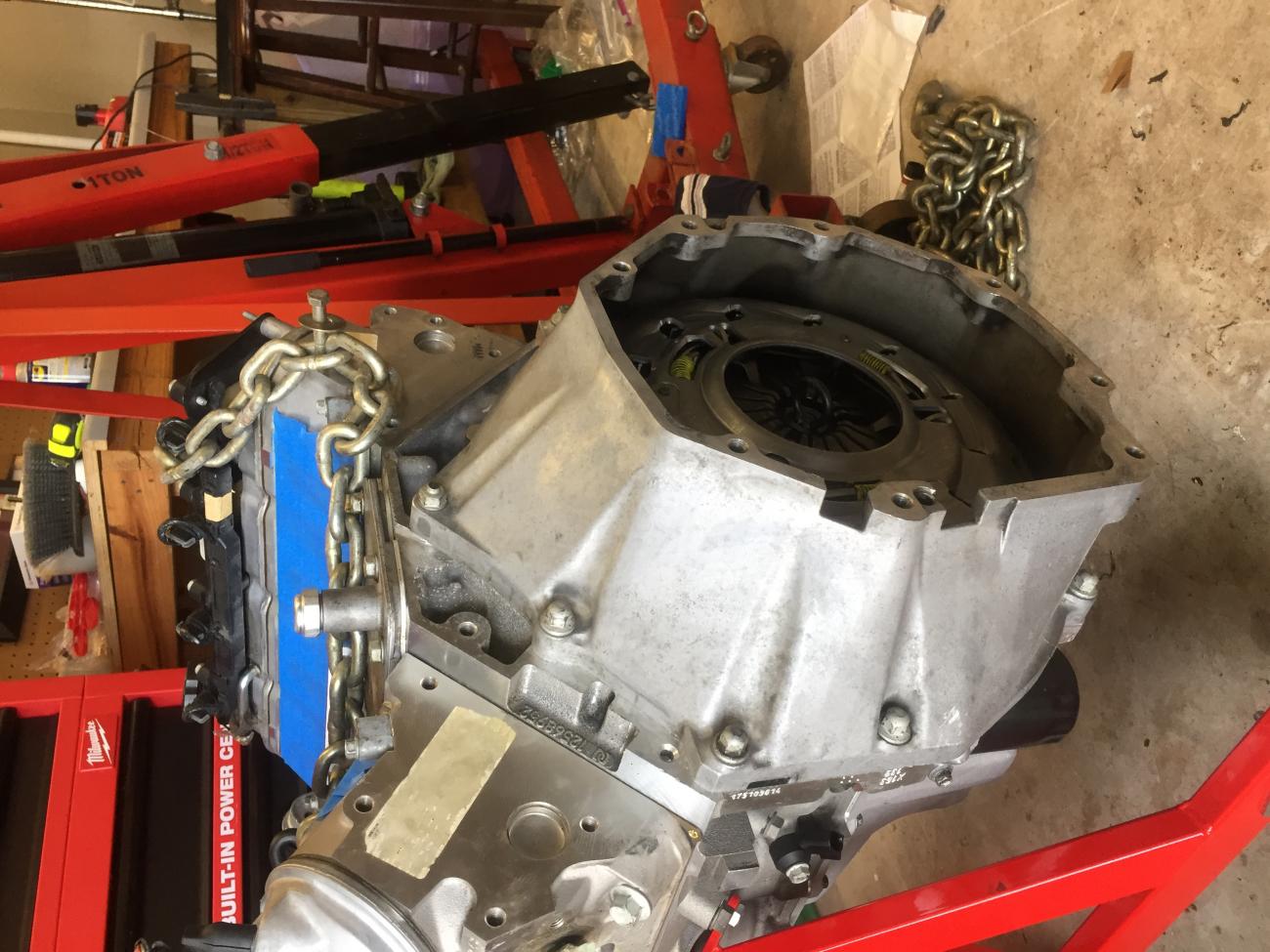

Pilot bearing in. LS7 clutch on. Bellhousing on. T56 ready with slave and quick bleed line
That's all for today. On graveyards this weekend
