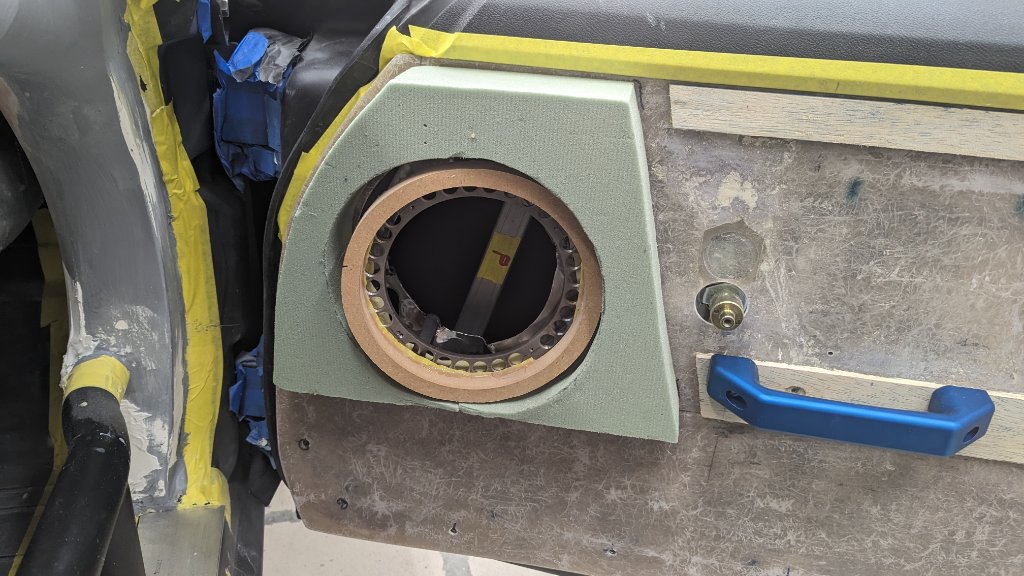

Here is the start of the foam work.

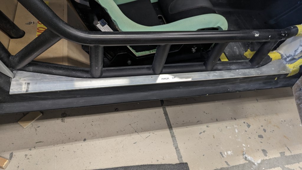

Have the sill plates mostly inked, just the overall shape....lots more to come here with these. Needed them placed to insure the door panels fit. Boring but important.
