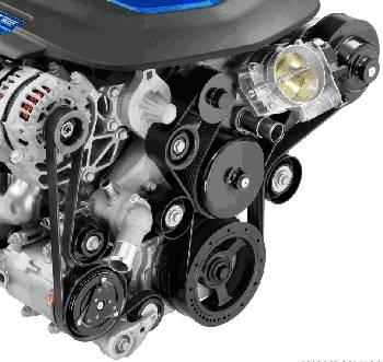

Originally Posted by 68LS1 View Post
Where does the position A/C compressor?
Up top, passenger side.

Originally Posted by dhutton View Post
The Vintage Air Front Runner they sell does not require the notch....
Don
Vintage Air Front Runner will not work with blower drive. LS9 accessory drive packages AC compressor passenger side low. It and generator are driven by one belt (6-rib), while SC, H2O pump, PS pump are driven by 2nd belt (11 rib).

Originally Posted by formula88 View Post
Mark pocketed the cross member near the RH engine mount to provide clearance for the AC compressor.

We've used Concept One A/C compressor mount for the LS9 and it gave us enough clearance
