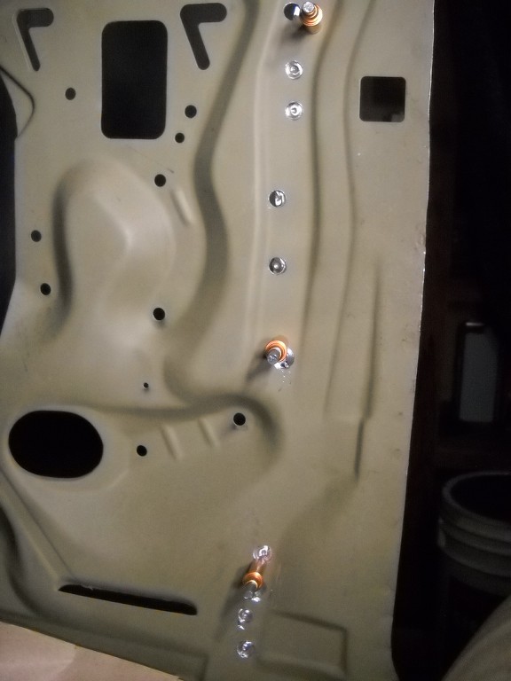

Got out in the garage with the heat going, finally got above freezing outside ... maybe 40? So I got the jamb brace drilled out and got to use my new Clecos .... those are cool. Definitely made getting the quarter on and off much easier and I could just slip the brace in thru the wheel well opening and cleco it in place and not have to wrestle with the quarter.

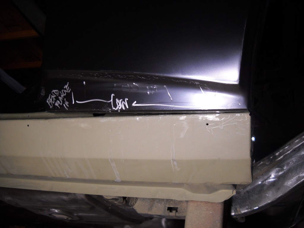

The lower part of the quarter that meets the rocker panel is not stamped correctly ... to low in the back and when you push it in place onto the rocker it bows the quarter and puts it under tension .... NOT GOOD!!!!
I'll have to think this one over, meanwhile take a look at the pictures and chime in if you have an idea to get this correct. I don't really want to straighten the flange and re bend it, .....but
Got the brace off and cleaned up the metal.
Got to use the clecos I ordered ... these are the Cat's Pajamas!!!
It makes contact with the rear first and if I force it .... the quarter panel is under tension, NOT GOOD!!!!!!
Only got to work in the garage a couple hours cuz of my back being tweaked ... MRI told of two bulging discs, hurts like heck and my legs go to sleep!!! Anyway, any good ideas on this panel?

Ouch! Sorry to hear about your back problems. Is this a recent development or have you been dealing with it often? I know so many people with back problems and it makes me feel fortunate to not, at least, have back problems. Hope it gets to feeling better for you!
Car's looking great, as always.
Snap a picture of the back and at the sail panel area, so we can see more of what's going on. Quarters can be such a pain to deal with, but once you find that magical position, they seem to almost fall in place. You're right though, if it's under tension, then something isn't right.
How does the alignment look at the bumper line in the rear?
