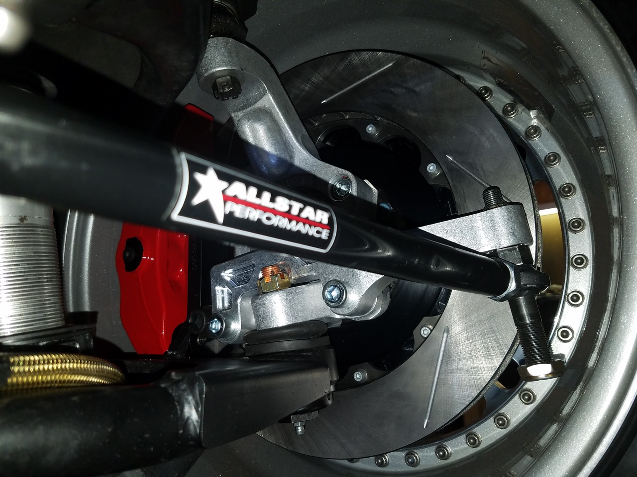

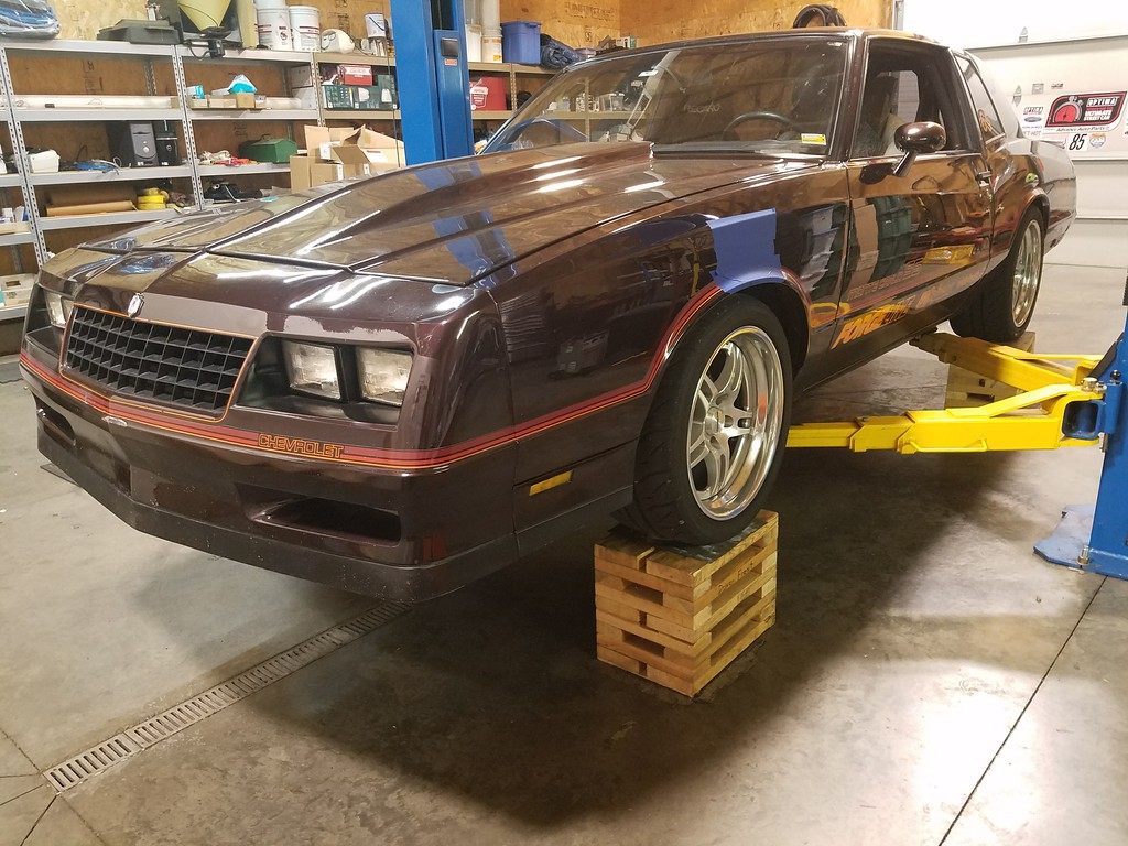

Box... Opened...
Barney is on the now leveled rack, simulated driver weight in front seat, ride heights marked, ready for disassembly tomorrow morning...
First thing with be a test fitment of rotors and calipers installed on new ATS spindles then placed into one of the Forgeline wheels...just to be sure. Then I'll pull the springs off the shocks, pull stock spindles and steering assemblies off and start bolting all the new stuff on.
Plan is to mock all steering stuff in place and spend some time cycling the suspension and getting the bumpsteer and ackerman to Dr Ron's liking...then we'll get busy putting these beautiful new brakes in place.

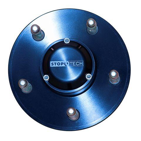

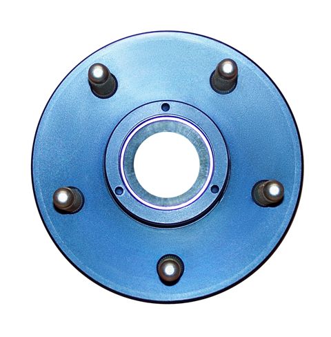

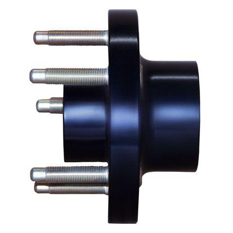

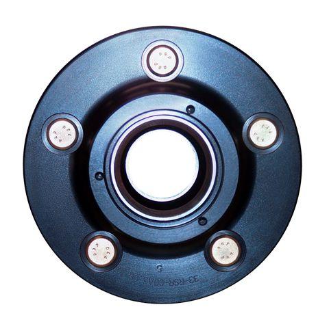

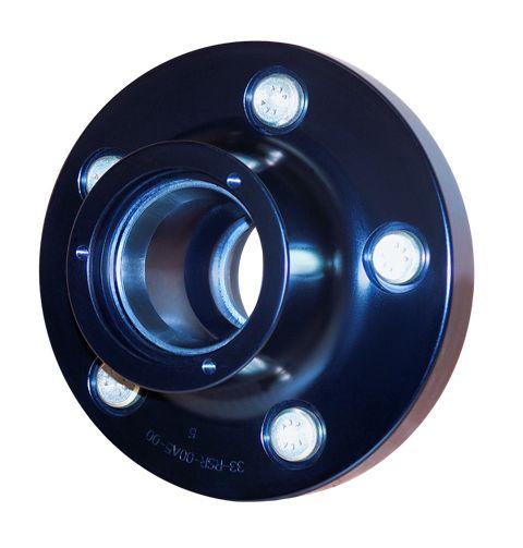

I didn't list the front hub features in the previous post, because some brake packages (like the C5/C6, Speedtech ATS, DSE, Roadster Shop, AME & others utilizing the C5/C6 mounting) don't need hubs. For cars with regular spindles that need hubs … read on …
The list of Features & Benefits from the Hubs is pretty impressive too:
  • 6061 Billet Aluminum Hubs - CNC machined in USA to ultra precise tolerances
  • Much wider flange = Less wheel deflection under cornering loads
  • Bigger radius behind the flange = Less wheel deflection under cornering loads
  • ARP 3" long x 1/2"-NF (8740 Chromoly) Wheel Studs standard
  • Timken Bearings & Races - No Chinese junk
  • "Slip Fit" seal design, allows you to remove & replace the seals without tearing them up
  • Seals are held in by 3 flange retaining screws (Just like pro race hubs)
  • No Stamped Steel Dust Caps to hammer on or pry off!
  • Billet Aluminum Dust Caps utilize three screws for easy removal & replacement
  • Hubs & dust caps are hard anodized gloss black to look great for a long time
  • RSRT designed tab spindle nut washer (Stainless Steel)
  • Allows you to set near perfect bearing preload more accurately than the cotter key & castle nut method

Now, all the listings above in red, I was NOT going to create hubs & brake kits for … unless I could increase the outer hub bearing size & thrust load rating. We did. I worked with Timken bearing engineers & came up with solutions for almost all of them.
Here are the bearings I used, in each hub design for the applications we offer, or will offer our Triple Duty StopTech Brakes Optimized by RSRT.
A. All of the cars & spindles that come with LM12649 outer bearings … simply come with the best LM12649 bearing available … Timken. These are true 1130# thrust load rated, where a lot of off brands & imports do not meet that load rating, or simply don’t have their bearings tested.
B. All of the cars & spindles that come with LM12748/9 outer bearings thrust load rated at 921# … I designed new hubs that allow us to utilize the Timken LM12649 bearing, thrust load rated at 1130#. This increases their thrust load capacity by over 20%.
C. All of the cars & spindles that come with LM11949 Bearing rated at 917# … I designed new hubs that allow us to use the Timken #21075 bearing, thrust load rated at … ready … 2540#. That is not a typo. It is a commonly available Timken automotive bearing. It is bigger, beefier, handles more heat & has bigger rollers with more surface area. When it’s time, you can buy replacement bearings around $20 each. This increases the bearing’s thrust load capacity by over 275%.
D. All cars that utilize the C5/C6/C7 mounting, we simply suggest you utilize the stronger, higher rated C6 ZR1 or C7 hub & bearing versions.
Now a really cool part … my StopTech brake packages with these superior hubs, dust caps, reusable seal mounting, ARP ½” x 3” long studs & strong(er) Timken bearings ONLY add $200 to the cost of a front brake kit!
We do NOT sell these hubs separately (unless you need a replacement). If I did, they would cost $800-900 a pair. So when you’re shopping brakes, compare the big picture & I think you’ll find:

I just can't stop staring at them...
Rotors, calipers and spindles with steering arms reversed all fit beautifully...tons of room everywhere. The dropped adjustable centerlink would not clear the triangulation brace mounting pad and the tie rods ended up being about 2" too short because we flipped the steering arms out to get more ackerman. Longer tie rods are on the way and then I'll get the bumpsteer adjusted and head on to the rear brakes.
Huge thanks to "Ronstar" for being available for several calls along the way today. Just try to reach any other parts supplier or suspension specialist multiple times on a Sunday afternoon!!!
Lance
