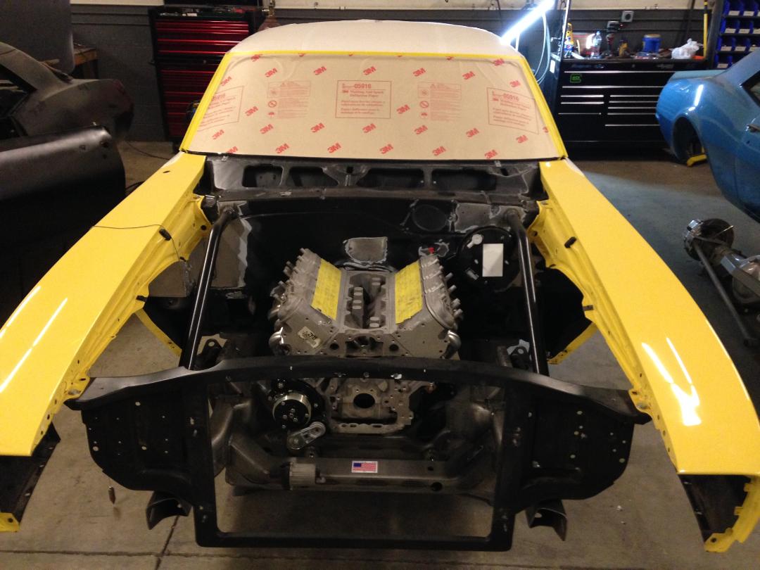

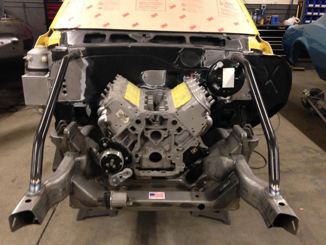

Today's update.

Mark if you get a chance it would be nice to see a little detail on the trans cross-member. That really frees up space for the exhaust. How the tabs tie into the doublers on the inside of the floor would be nice.
Thanks
