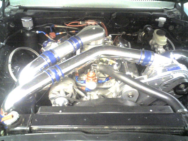

I don't live far away and in the san jose area for work all the time. I'm a hvac contractor I see your a electrical contractor. I would be willing to help you out anyway I can. I was ready to give up on my car too before or go to a ls1.Sometimes a new set of eyes on a problem is a good thing. I have a simlar setup on my firebird. I did go to efi because my carb was giving me a hard time. Heres a pic of my setup.
