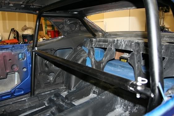

True. How about some pics of the ame cage installed
I'll find some, I know I have some. It did fit well, very pleased with it!

Ok, figured it was just easier to take new pics of the AME roll bar. I opted for the bent down bars and I used a Chris Alston swing-out kit on the harness bar. I actually ordered an 8 point roll bar but decided against using the door bars and tubes that install at the rear passenger's feet...this is a family car after all...got to keep it comfy and usable...yeah right!
