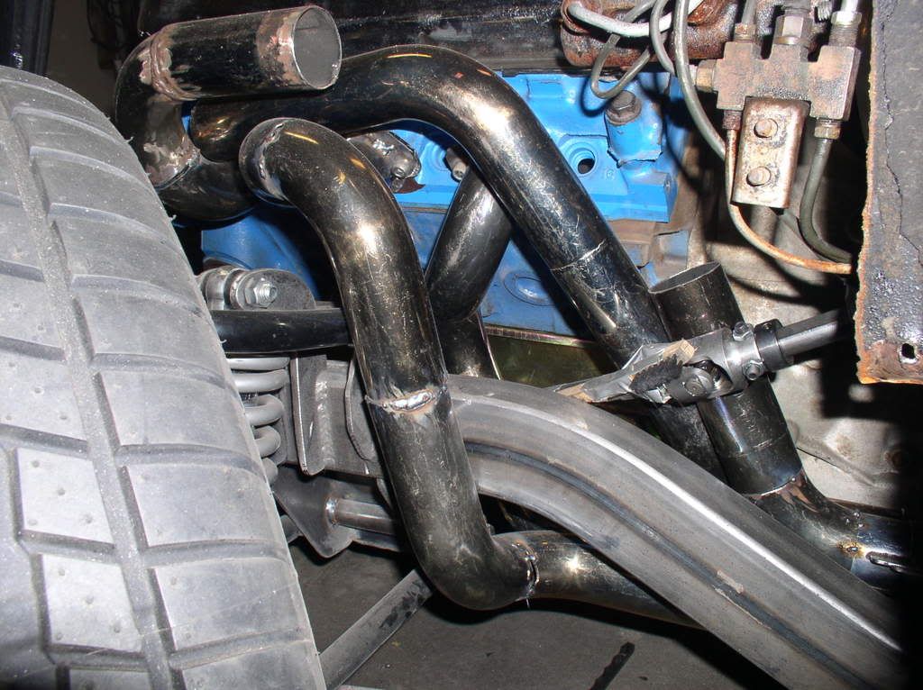

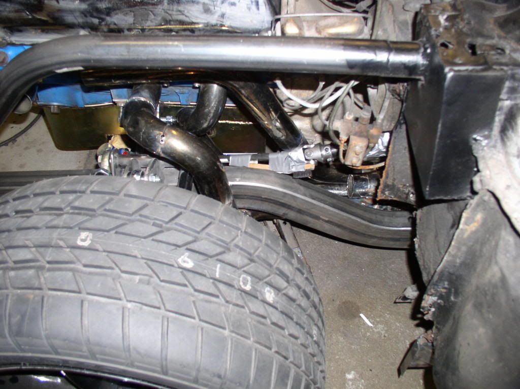

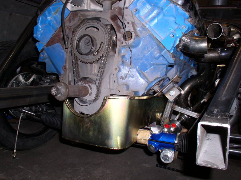

Spent most of this weekend refitting the new power rack ..then onto the mock up of the steering and exhaust ..not alot of room for 2 1/8 inch pipes
Here are some pics ...
mocking up the slip fit headers

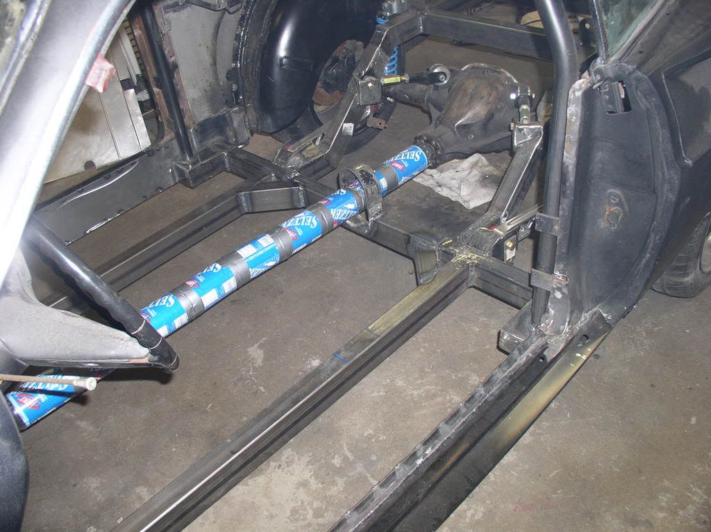

well i gave up on the headders as i need more tubing.... so i started on the mini tubs and working on the floor pans ..i remade the crossmember as it was tow low to the ground.......here are some pics ..
not alot of room here
wheel tub widened and installed
New crossmember like my drive shaft
Right Hand rear floorpan made
  #66
