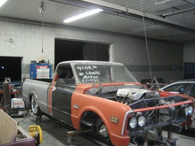

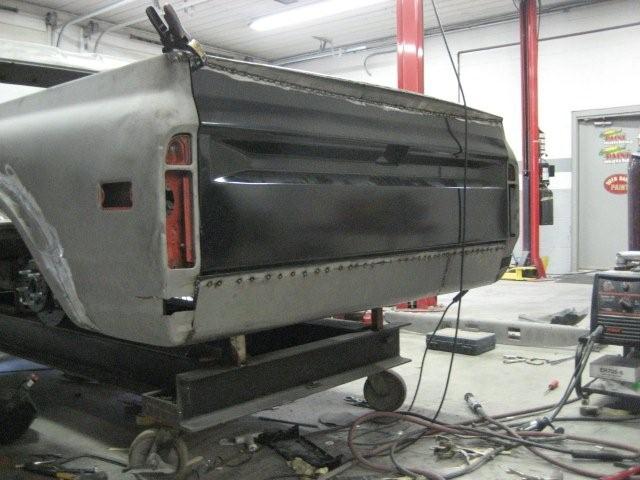

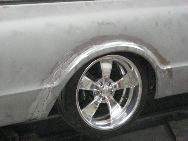

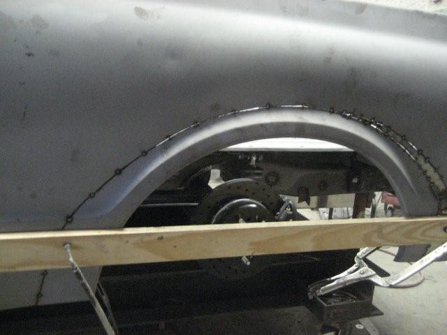

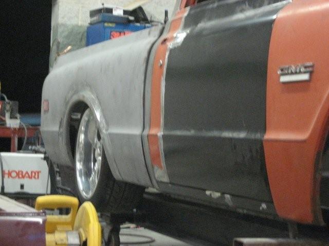

Smile few progress pics

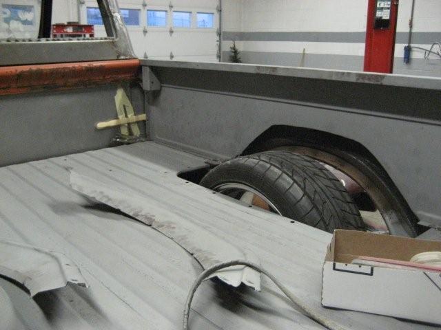

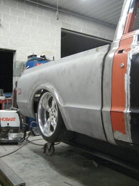

just a few progress pics , im paying one of my employees (willie) to help me out at night, while im up to my neck in little league , so hopefully i can get rolling again. were working on the bed mods ,moved up the bed floor 1 1/2 inches and dropped the sides 4 in ,moved the arches forward 2in & have to widen the wheel wells 2in and raise them 3in. i pie cut behind the rear wheel and lowered it 2in so it would look lower and make the roll pan bigger . im hoping to do something crazy with the exhaust thru the roll pan. the wheels im mocking up with are 20 x 10 but i think i may need something wider. thanks for checking in bill

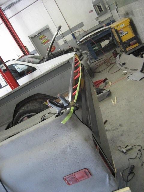

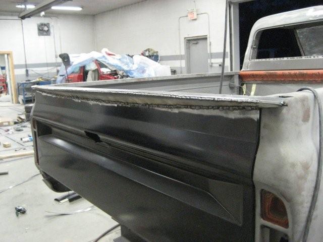

Thumbs up rear spoiler

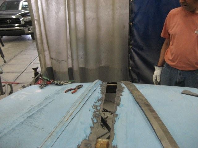

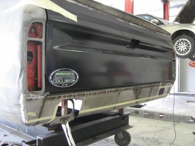

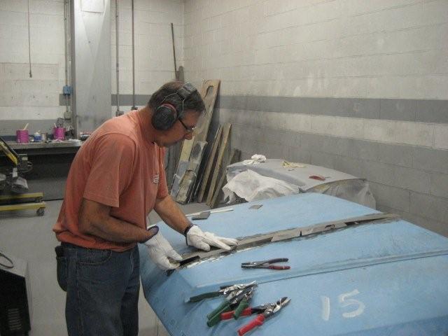

heres a few pics of my small duck tail spoiler & my dad larry is giving the hood a new look.

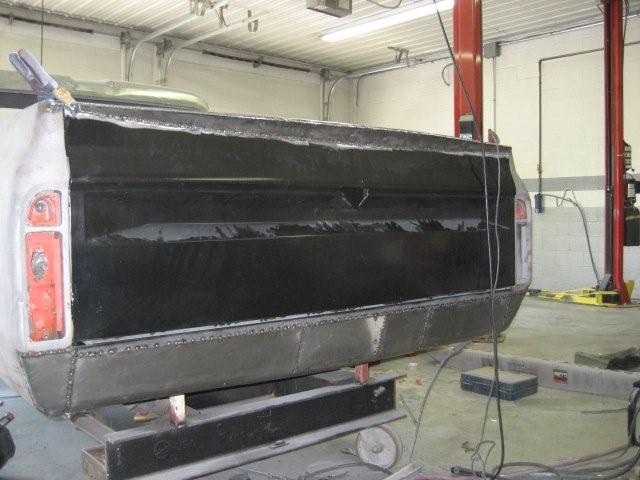

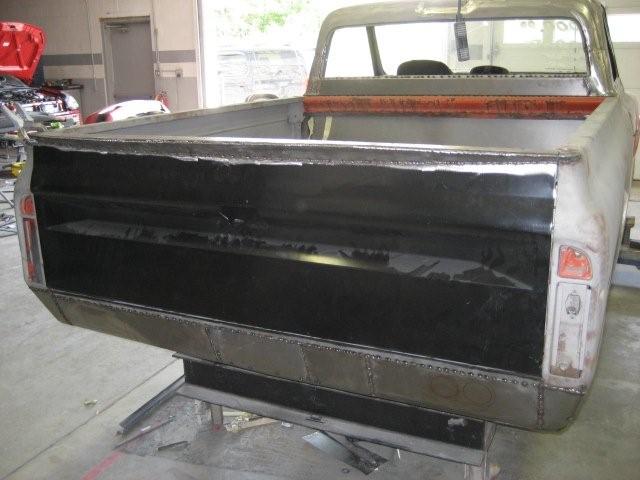

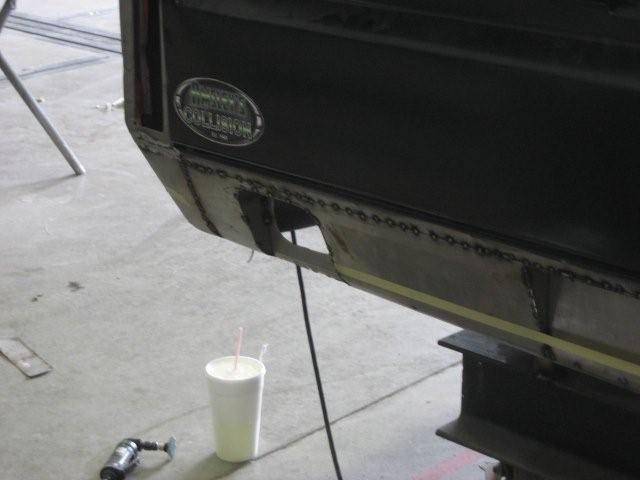

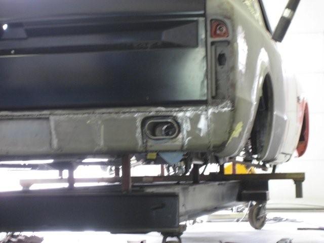

few more progress pics ,roll pan

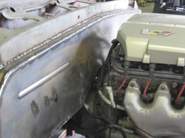

Posts: 229
Cool

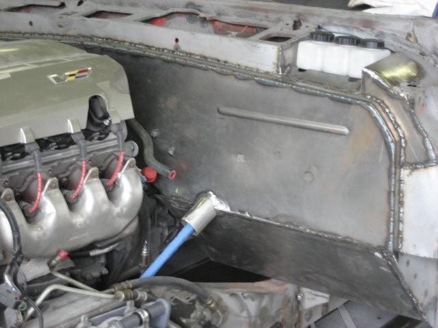

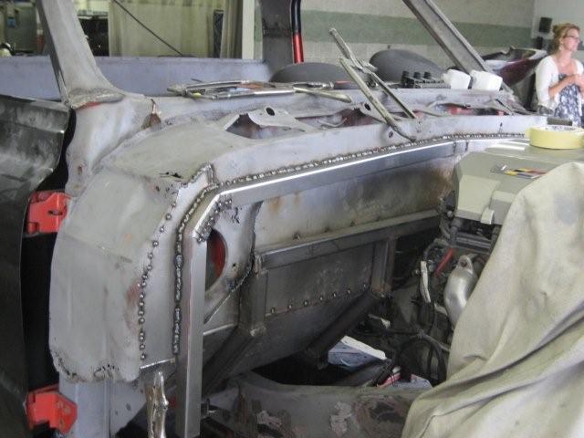

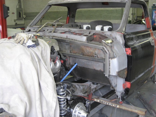

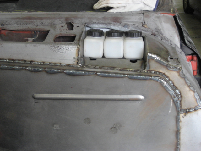

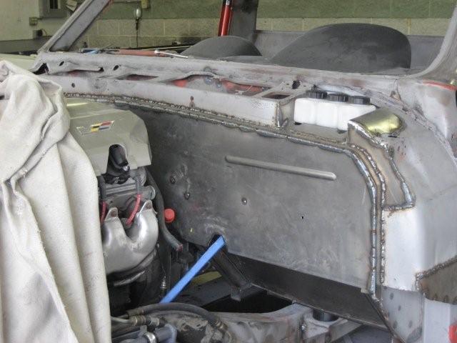

few pics of the new firewall and resivor pocket. this way i can check the fluids with out removing the cowl. can any one sugest what rear end gear to use with my 6 spd 373?? thanks bill

Diggin' the firewall. I guess you're making a smaller removable cover for that side of the cowl panel to access the resivoirs?
