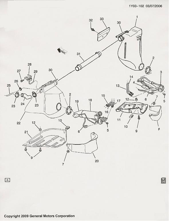

Early C5 fuel tanks and pumps.

Sorry Rob - you wouldn't believe how difficult it is to get info on new parts from GM ... I spent an entire day looking and calling for info with no luck.
I called the AC Delco tech assistance line. That is contracted out by GM to a company that performs tech work for many of the OEMs including Porsche lambo, etc. They could answer my spec info request on the part - but I would need to setup an account first - then it would cost $3.25 for each question - and $3.25 per minute for them to answer the question.
So unless Mark can provide the info from the inside - or a member with access to the info can add it - I'll have to setup an account and pay.
GM # 19207950 and ACD # M10235
I have also tried to get the name of the supply vendor for the venturi jet component used in the early C5 Fuel Sender/Jet Pump unit - but no one will give that out as it's still proprietary.... been making those since what 1998 ? So I have bought a couple used assy's off e-bay for $20 bucks and will piece meal the setup together.
Man I'm spoiled from aviation ... the supply vendor's name is right there next to the part number in the illustrated parts catalog - WITH their address and phone number.
