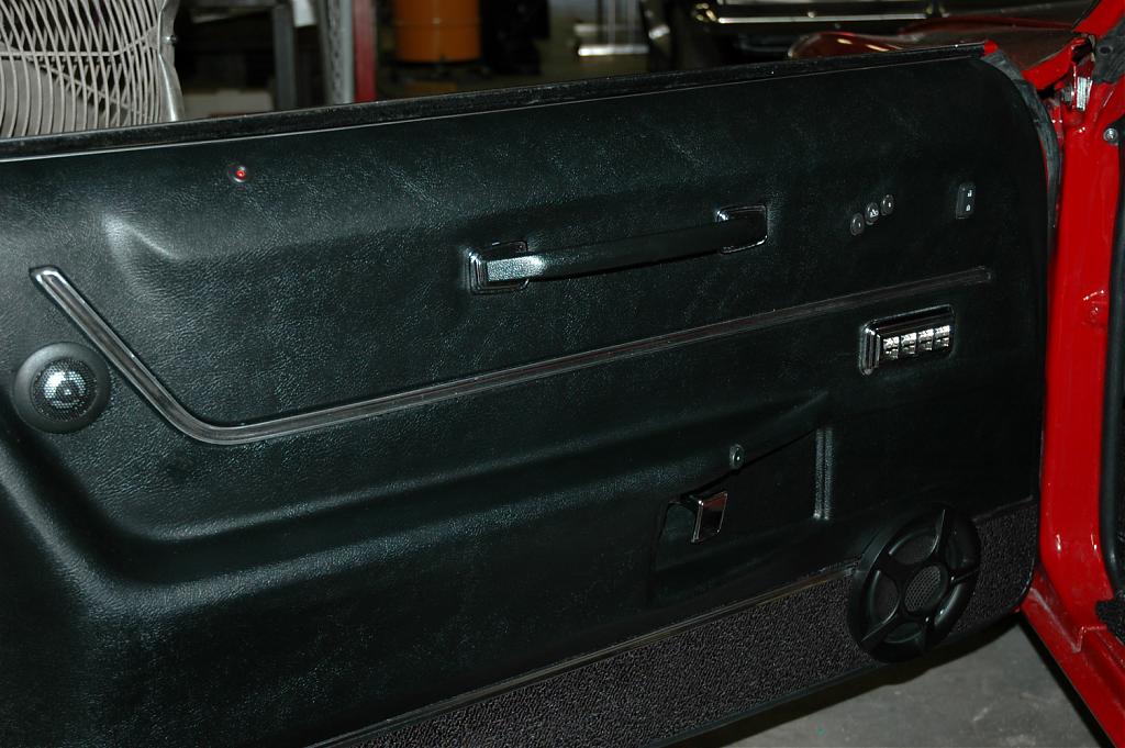

Been working on the doors. I've used the latches and all the electronics out of the corvette power door locks and power doors. The electric latches in a vette are in the door post not the door and the latch is on the door so I had to modify latches to install in door.If you're familer with a C-6 theres a safety,non-elec, handle in the floor to manualy open the door so I used the stock inside door handle for that and installed the elec. button in the door panel and the outside handle pushes a elec. switch and electricaly opens the door like a corvette.Also has heated and power seats from the Z0-6 and the memory controls are also in the door panel. Bob

Great Idea Bob, I see your making use of every component you can from the donor car

Stunning work Bob and awesome combination of the two vehicles! Keep 'em coming!

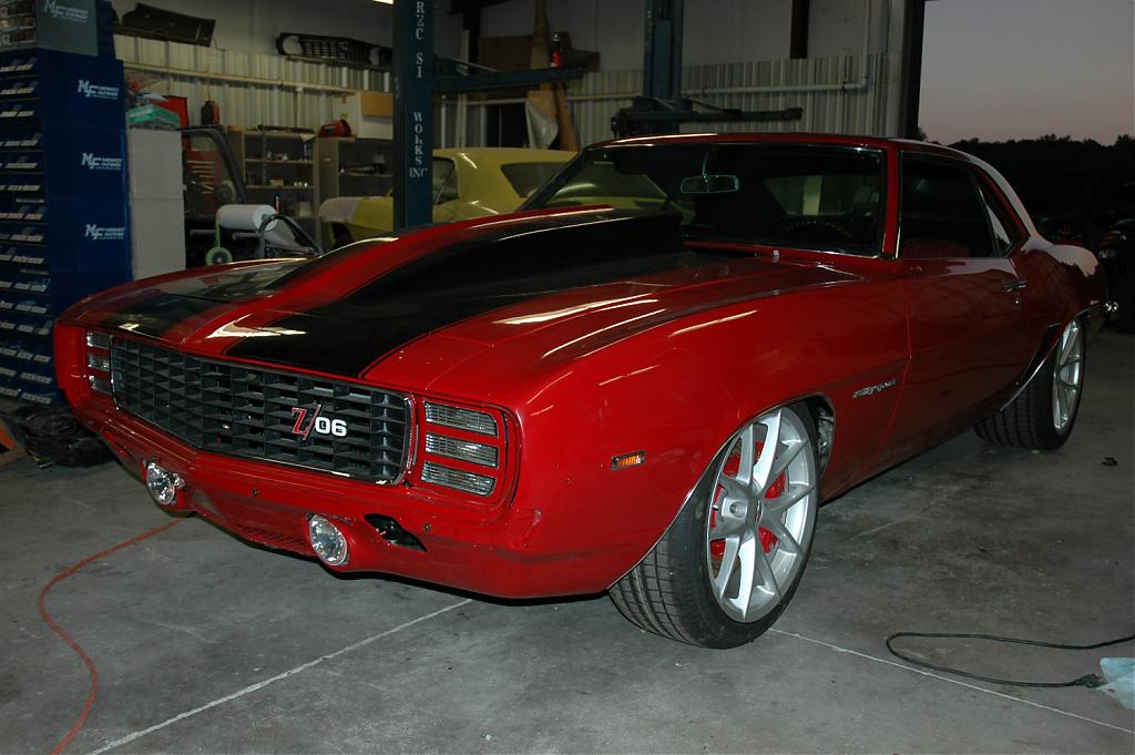

Try'ed to get a decent pic on the ground but to much junk in the way

KILLER car Bob!

That does look killer, nice work Bob.
