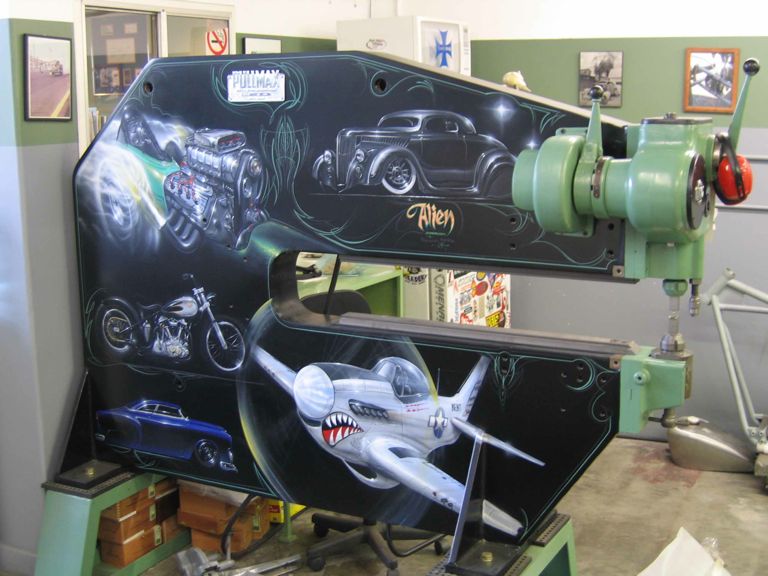

Bitchen work as always. Gotta love the pullmax. Here's a pic of mine
