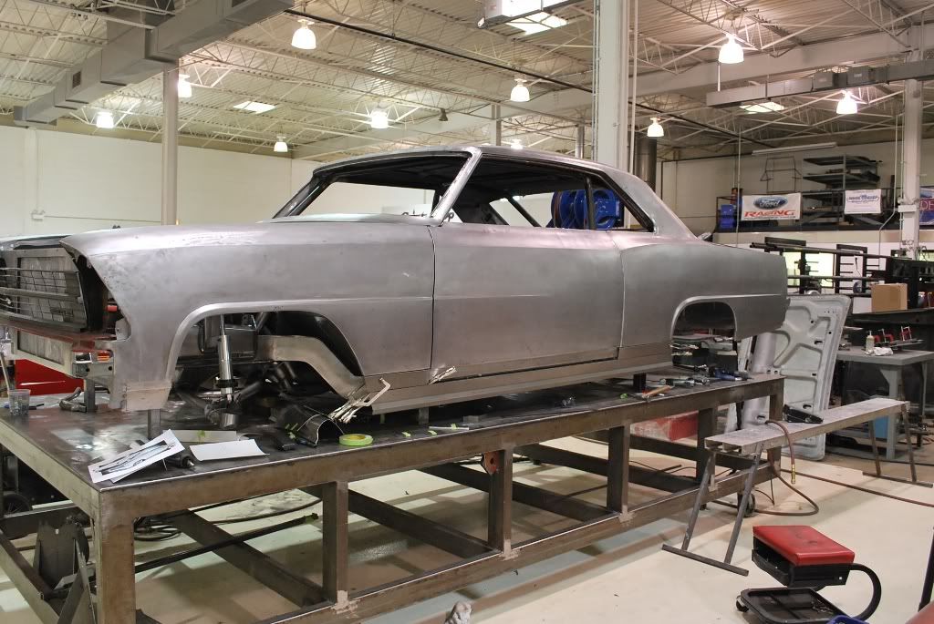

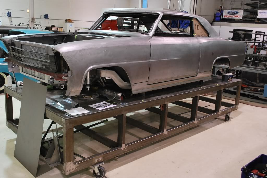

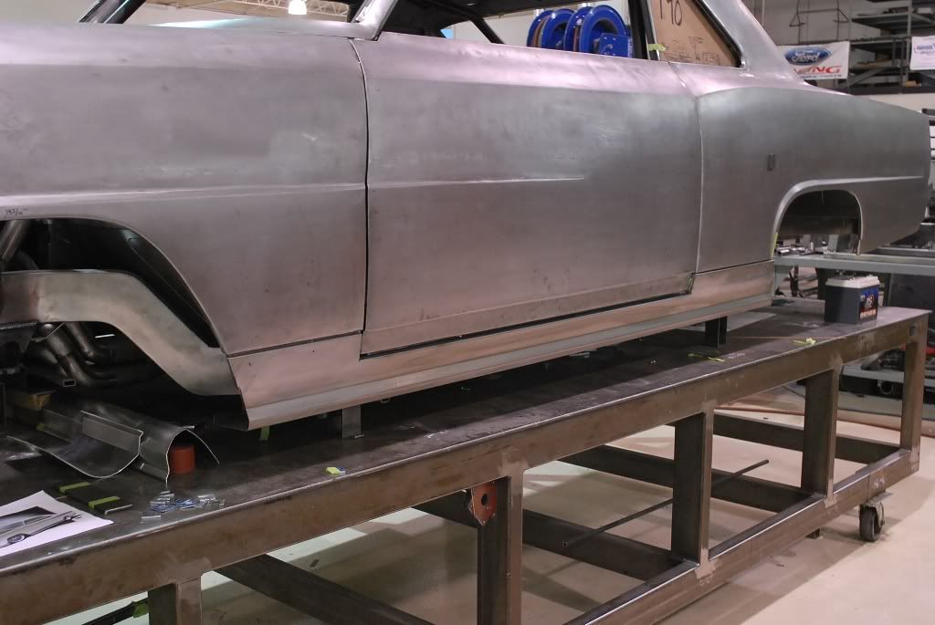

Posts: 1,120

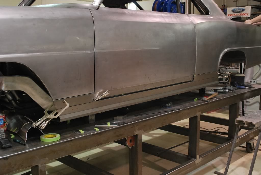

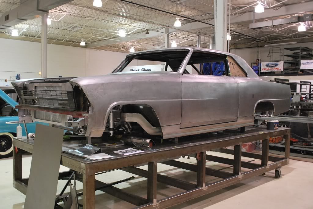

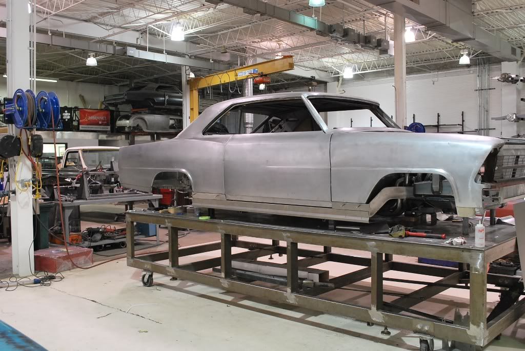

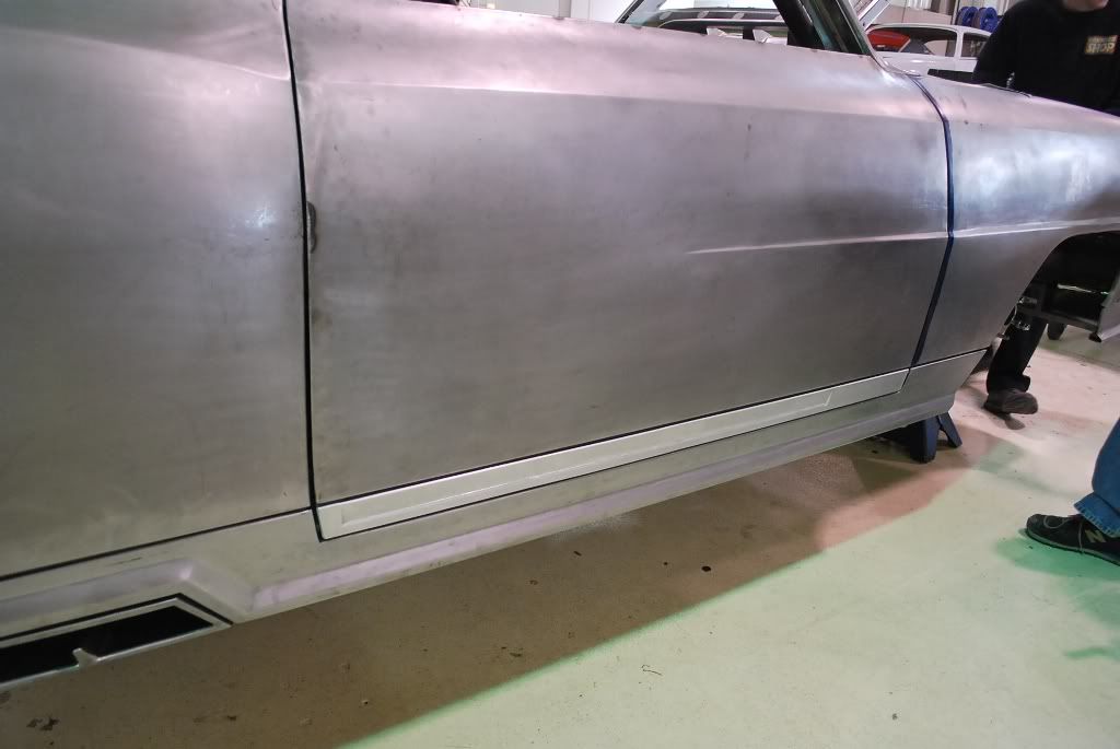

Here is the fab work on the rocker moldings and lower door accent moldings.
www.roadstershop.com

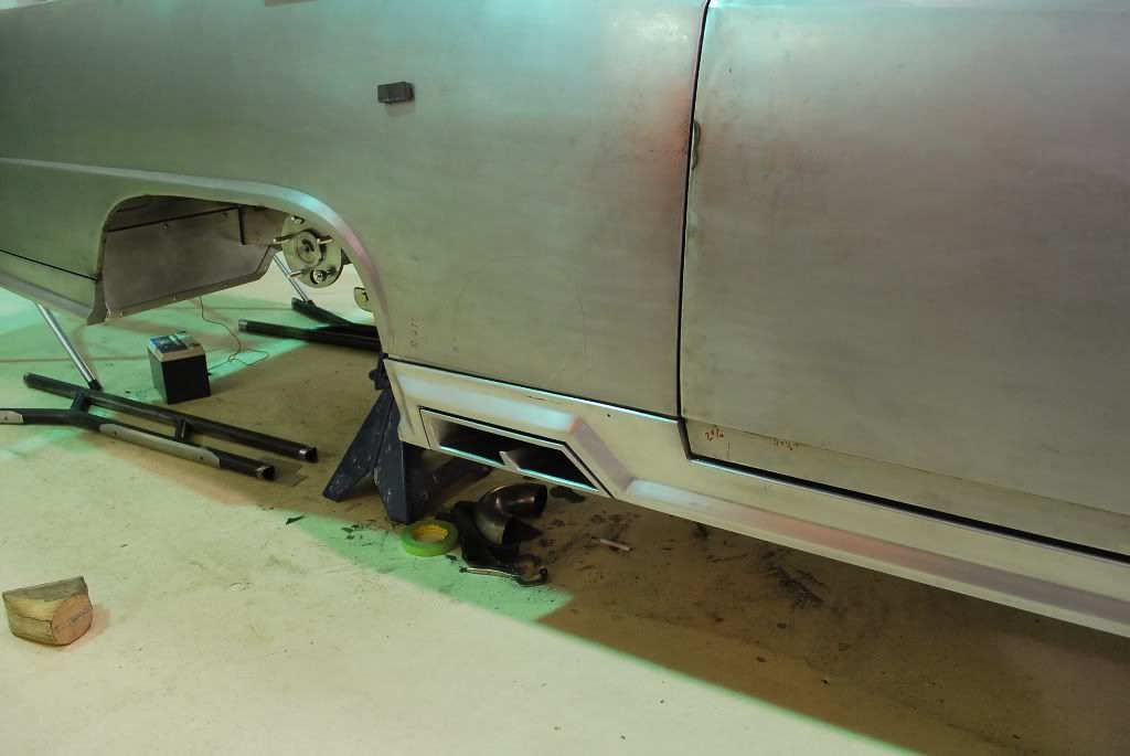

Posts: 1,120

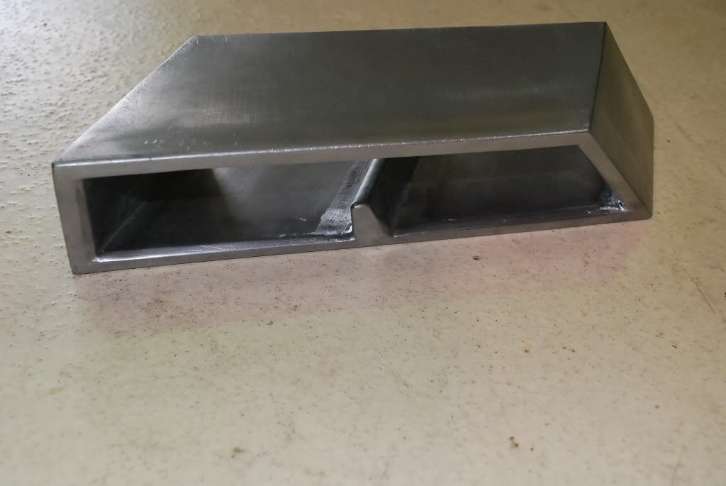

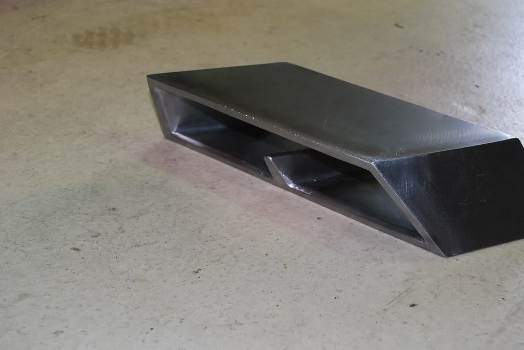

Once the rocker was in place we went back and re-shapped the rear portion to accommodate the side exhaust.
We fabbed a double walled stainless sheet metal exhaust tip to flow with the cars lines.

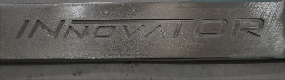

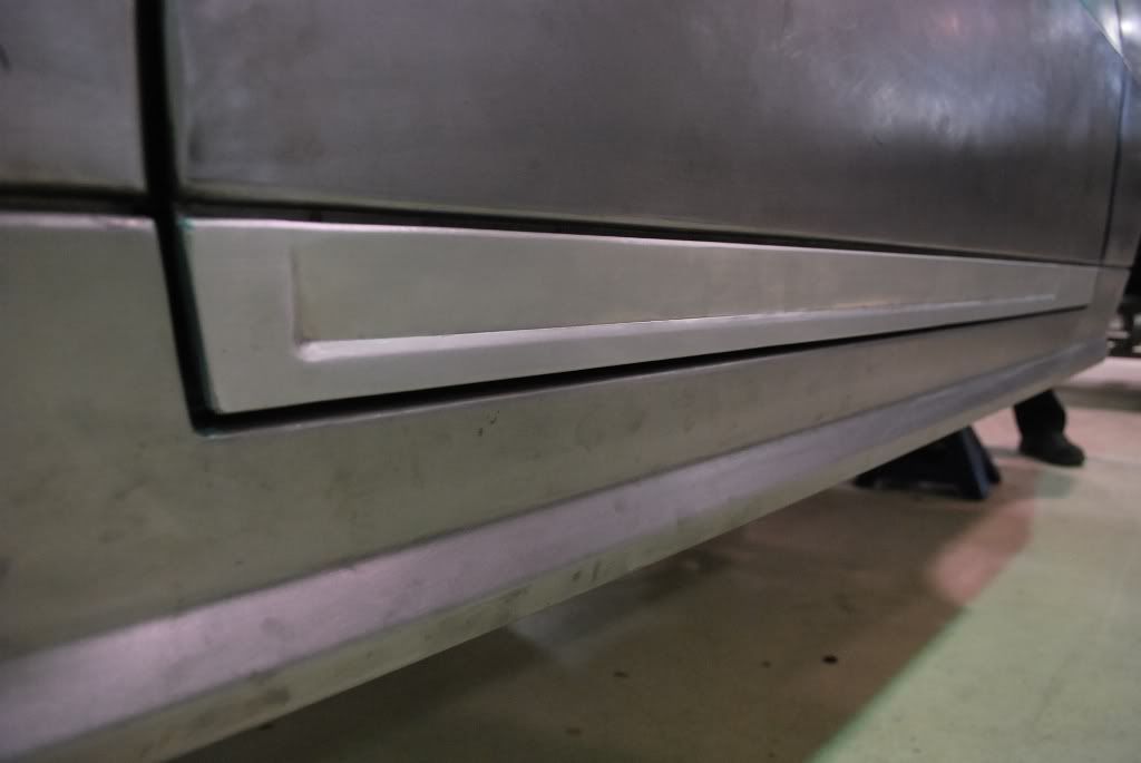

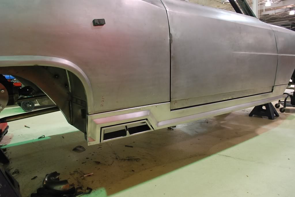

Here is the aluminum trim piece we made for the bottom of the door. There is a reveal line tipped into the piece for added dimension.
Innovator name plate was CNC'd and then welded into the front of the lower door molding.
Door molding completed (Prior to Innovator logo install)
