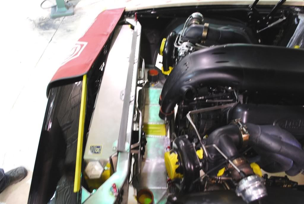

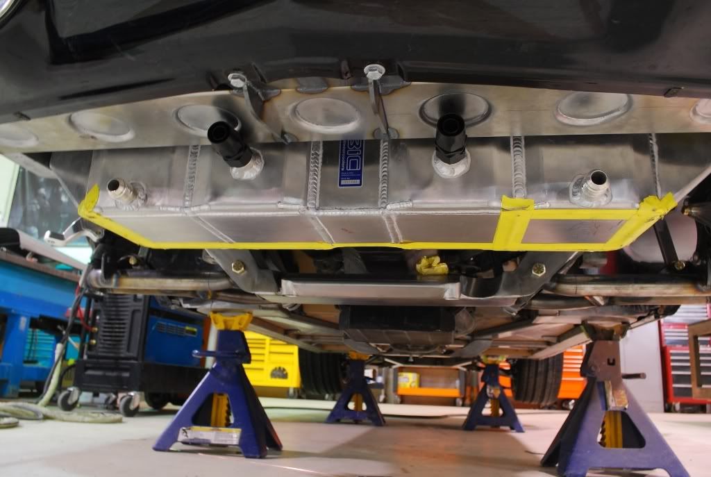

Time for some updates: The custom intercooler arrived this week so we can now finish the plumbing for the turbo's.
The intercooler was mounted below the radiator and designed to fit perfectly between the frame rails.
The start of a custom overflow that we machined to fit inside the core support and stay out of sight.

Love the spot for the overflow canister. Great work guys.
