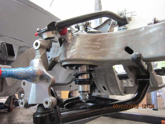

What's wrong with this picture? Look at the lower attachment of the coil-over. These are the 3.6" stroke coil-overs from Ridetech with 8" springs. I believe I'm going to have to go with longer coil-overs with 10" springs. Any ill-effects having the 4.1" stroke coil-over on the front? Also, is there any problem with shimming out the steering arm around 1/4"? I'm having interference with the Truturn at the wheel.

Are you using Ride Tech lower control arms also? I would think that if you bought all the components from them or a vender then you should have the correct shocks? I would call them and see what they say, but yes you seem to have an issues with the shock being to short.

No, I'm not running Ridetech's control arms. Ridetech didn't seem to be hugely familiar with the ATS/Chicane brackets, which allows for a coil-over with more stroke. I'll have to call Speedtech tomorrow, I suppose, to hopefully get an answer. When I spoke with them in the past, they didn't seem hugely familiar with this particular setup either. They didn't design my front setup and I don't know how much experience they have with it.

Why not just build a higher lower mounting point on the control arm? I'd do a temporary one and make sure you have the desired travel. Is 3.6" enough stroke?

I have thought of that, but the amount of fabrication to execute that is more than I am willing to do at this point. I did speak with Speedtech today and was able to get more info than I did before. They spec'd the same size coilover that I have on the rear with the AirBar, which is 5.2 stroke, but with 10" springs. That would be the easier solution to this small hiccup, it seems

I have emailed James of the OLC Camaro and Tyler, the originator of the ATS/Chicane bracket setup and both have confirmed to me the 5.2" stroke coil-over with 10" springs is what the system was designed to run. I got a rough measurement of front suspension travel in the neighborhood of 7", so the 5.2" stroke shock will definitely work. Now I just gotta convince Ridetech that is what I need and the system was designed to run.
