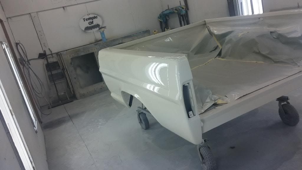

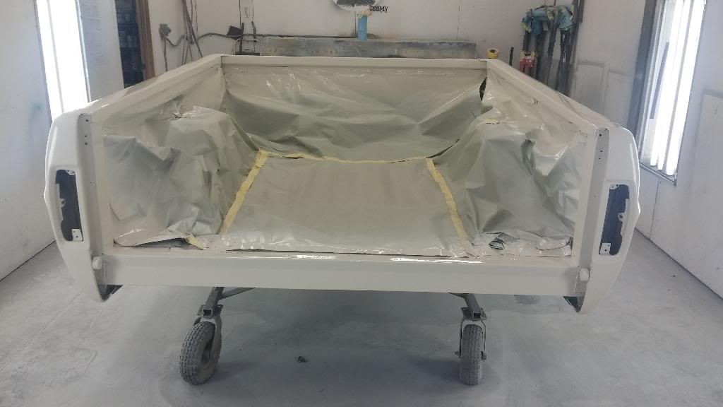

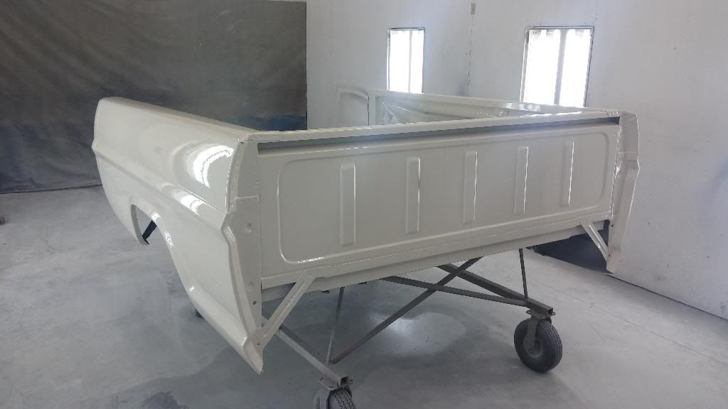

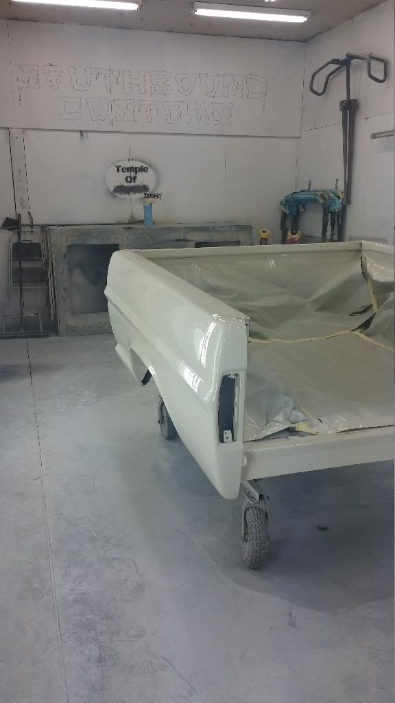

Took a spin out to Aarons to check out the progress on the truck today. Looks great so far.
He is doing a great job!!
They finished up all the prep and shot the paint on the bed earlier today. Seam sealer looks great, like factory, bed rails are very clean and straight, even inside the box. Body work looks great as well. Paint is single stage PPG, with enough on to color sand it flat.
Aaron said Monday is going to be color sanding and buffing on the bed, he is hoping that they can get it out to get the bed line ex'd. Its going to be under the rails all the way around, front lip and tailgate as well.
If they dont get too busy this week they might get paint on the rest of the truck this week.

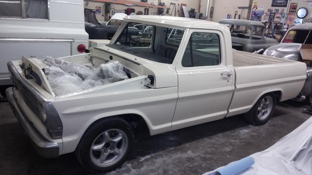

Not a ton of progress, bed is color sanded, but not buffed out yet.
Stopped by to throw on my 17's and get some measurements for the final wheels.
I really want to run something big on the truck but want it to handle well and drive well.
Was originally shooting for a 275/40/20 but think its just too big. So do I run a 19" front wheel or shrink down the tire size to a 275/35/20? Outside diameter is my biggest problem, at the 28" height, the tire will damn near touch the front of the wheel well opening. 27" tire height is much better....
What do all you professional pro tourers say?
Rears should work out well. 20x11, 315/35/20
Thanks for the advise.
Sean

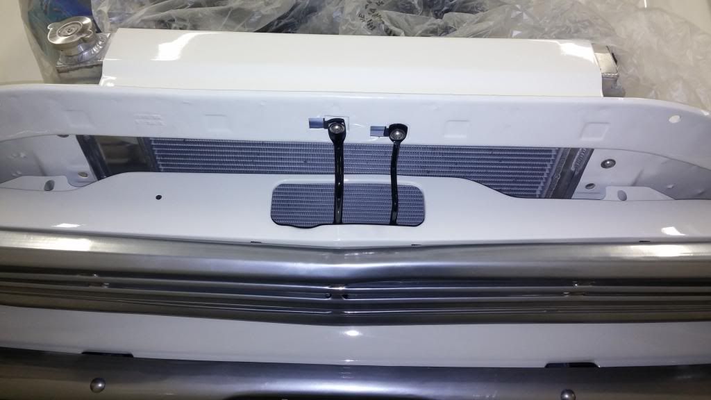

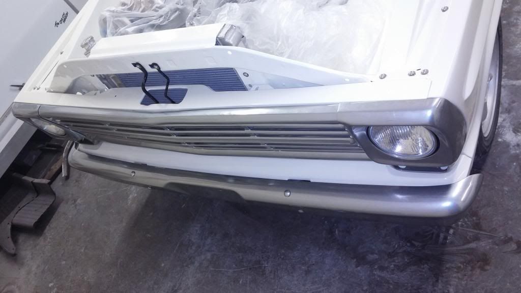

Truck is coming along good, really good actually. Made it out there with a truck load of parts today to get installed. Aaron was there and he gave me a hand for a few hours and we shot the **** a bunch too.
Truck is pretty much all assembled after today minus a hood, hood latch, spray in bedliner, windshield and passenger door seal.
Got the rear bumper, front bumper, grille and headlights installed today. Front sheetmetal is on, still needs more alignment but looks awesome. All the stainless fasteners, powdercoated bits and pieces and fresh paint.
One thing I have noticed is that I may need to relocate the rear mount for the lower control arm and pull the frontend back a little, might have put that mount a little far forward and could not really notice it without the front fenders on it.
Here is a few of the not greatest photos....
